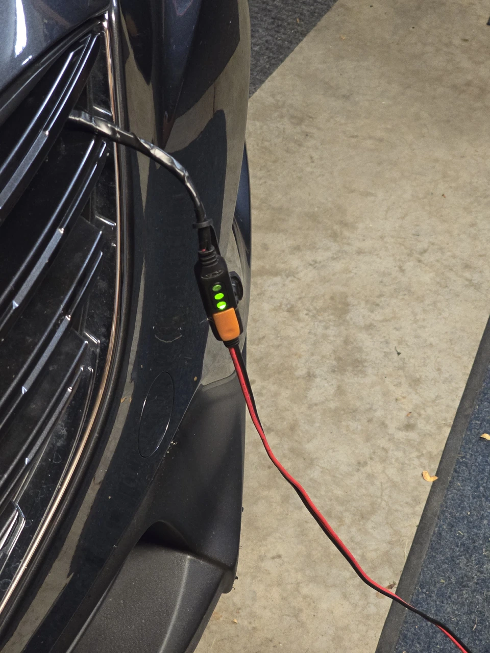

Parasitic Battery Drain will be my downfall (2016.5 CX-5)

Yep I read the same thing. Im not opening or closing anything and have waited the full hour and even sometimes a few hours. He says later in the video you may need to wait a half hour or even longer. At this point I plan to take to the car shop again and see what they find. I just thought I would see if I could find it myself first.

So I had a Indy shop check it out. Turns out it was a compustar remote start my car has that I totally forgot I had as I never use since I have a heated garage. I checked into it and it was installed 4-5 years ago by an authorized GM installer/reseller. Probably no warranty on it now Im sure but Im just leaving it unhooked for now. I sent that GM dealership the Bill and findings to see what they had to say about it but have not heard back yet. There was a fuse hidden up in the dash for it. No wonder when I had every fuse removed from my car the High Amp draw never went down. Stupid me for not realizing I had an after market remote start.
