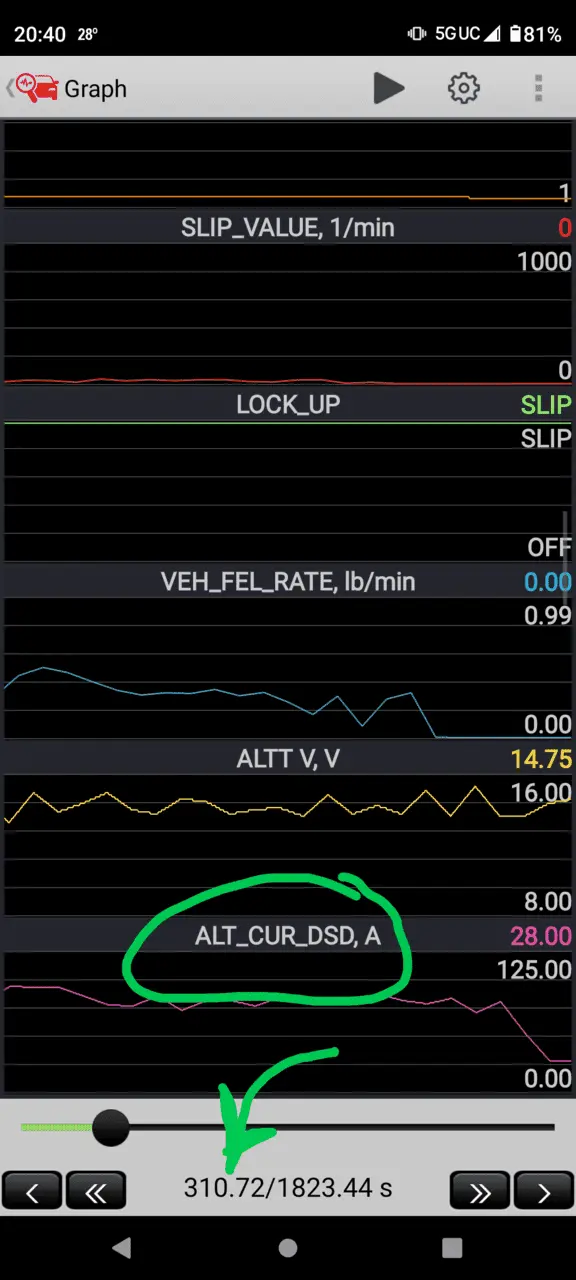

As a data point, our 2.2 diesel after a cold start will run 120-170 amps from the alternator for several minutes before dropping to more normal amp levels needed by the electrical devices running.
Here's the drive home from work tonight with an ambient temp of about 35°F ... 310 seconds (5min 10sec). That's a lot of juice flowing into the battery.

I was curious about how much power goes where so I experimented with different devices on and looked at the change in alternator output. It's (approximately... I'm going by memory ) about like this ...
AMPS DEVICE
7 only the car running
25 rear defrost (which includes mirror and front window heating elements as well)
15 seat heat (1 on high)
10 steering wheel heat
15 HVAC blower motor (70% speed)
7 headlights (with all exterior lamps on as well)
In my screenshot example above when the alternator output dropped from 100ish to 28 amps, the electrical devices on were headlights, HVAC blower (medium speed), 1 seat heat on low. That's it. The only place for those 60-70ish extra amps (in the example) to go is the battery as far as I can tell.
On cold mornings my alternator is pumping out closer to 150 amps for several minutes. I'll have to try monitoring output with a cold start and nothing but the engine idling, no electrical devices on to see what that output is.

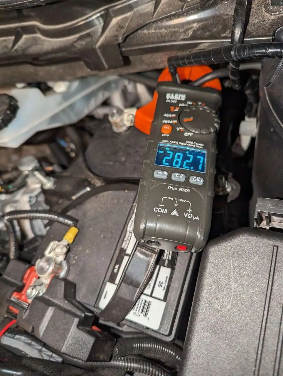

I pulled my head out of... And remembered I have a clamp meter. Stone-cold engine (5w-30 PUP) in 38f garage took this as peak. FYI for anyone who might wonder. 2016.5 GT 2.5L.
A stone-cold engine doing what? Being started I assume?
You zeroed out the meter before taking the reading, right?
It appears that you have more than one wire inside of the clamp. If so, all of the doc I've read says the reading is not valid if more than one wire is clamped. I've used my clamp meter on those negative wires for 'shutdown' type of testing (where the current values are very low and have a slow rate of change), by testing both wires separately and adding the current values. I don't know if it's even possible to be quick enough to be able test both wires separately with a clamp meter, on a running vehicle, where the draw is high and changing rapidly.
I saw those two wires inside the clamp too. I'm not sure how that will affect the reading as they both appear to be ground wires coming from the battery. Those wires look somewhat different than the wires on my CX but on my car one wire connects to a ground point near the shock tower and the other runs underneath somewhere, they both Y off of the negative battery terminal.
