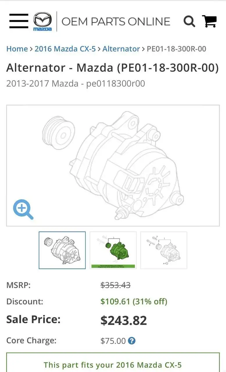

The cost for the new alternator installed was $550 for alternator and $250 to install. I thought that seemed very reasonable. Im not a car guy though. Hopefully aftermarket alternators are good and I don't have to worry about it for a long time. I don't have any plans to ever get rid of this car. Just going to pass it down to one of my kids when I get a new one. Overall the Mazda CX5 for me has been very good and reliable. I like the size and looks of it. I would get another one someday or something simular.
Just checked the alternator price from Mazda OEM:
So $550 for an after-market alternator is outrageous to me. And the shop can get 25% ~ 35% off from MSRP if they get OEM parts from dealers. I feel this indy shop really has ripped you off and you shouldn’t go there anymore.
