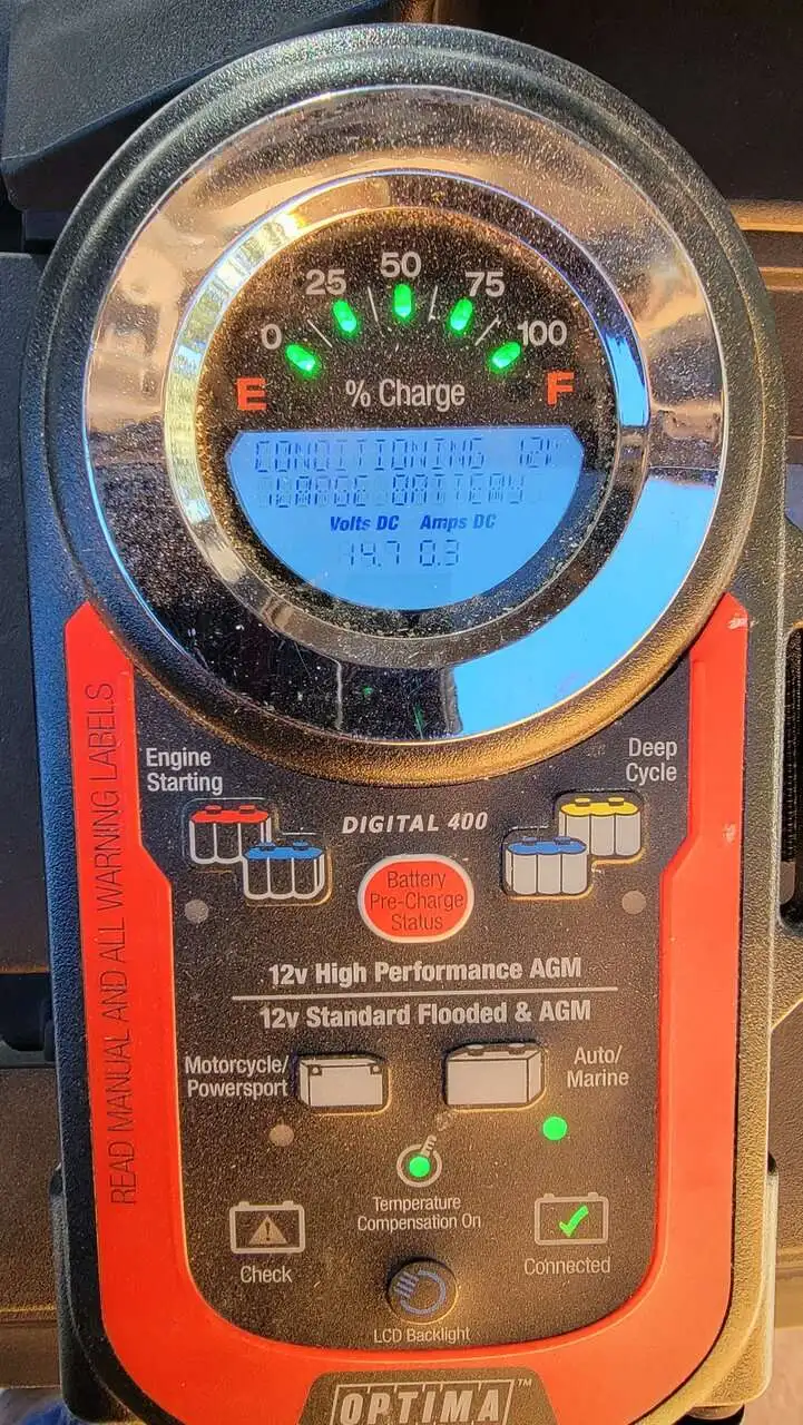

Took about a 45-minute drive to my buddy's house up in the mountains. I know it got cold overnight up here. But this morning at about 9:00 a.m. the car turned right over on its own.
I decided to put his optima 400 charger on the car. Initially it said it was at 75%. But only about 20 minutes later it said 100%. I walked away for a few minutes I admit. And it appears to be doing a conditioning. See photo. I did not disconnect the battery from the car. I wasn't really finding a solid evidence either way to do so.
