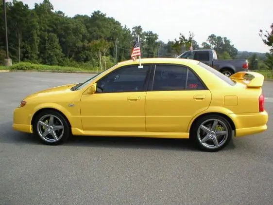

My poor molested MSP had some whacko paint the calipers yellow. It looks like a combination of nasty ass and dirt. When the car arrives (if it ever does) the first order of buisness is to reapaint the calipers gloss black.
I've Attached this image of my car so you can see how nasty it looks for yourself. The caliper will get brake dust and crap on it and make it looks like a horses ass gone wrong.
Ohhhh yea... In terms of paint. Get the high temp 1200 ceramic crap and the high temp 1200 degree gloss. Standard "caliper paint" is like 600-800 degree resistant, and breaks down easily. The high temp paint and high temp gloss ensures a nice glossy caliper that withstands heat 2x's more.
That yellow does look like (blarf)
Plus, yellow on yellow? Nuh-uh!!
I went red on my yellow MSP (nice contrast).
