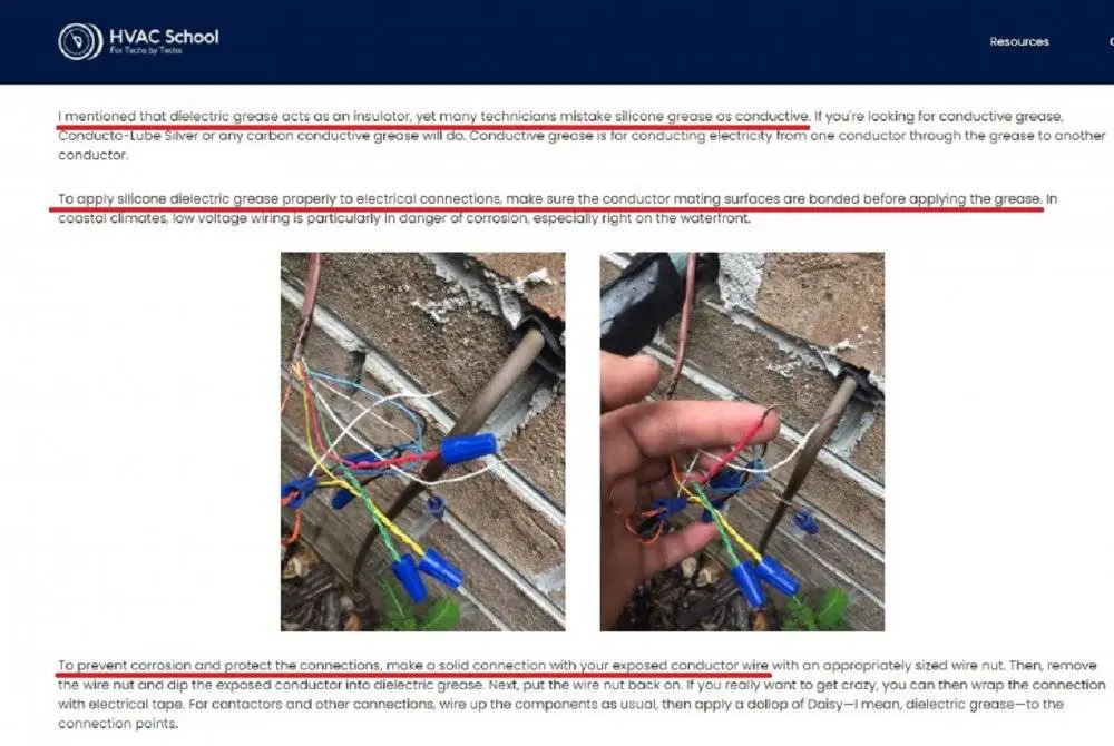

As far as electrical connections, I've recently learned you have to be careful using dielectric grease. It isn't conductive.
Dielectric Grease: What It Is and How To Use It
You have to have a good clean solid metal-to-metal contact with the connections as the dielectric grease will act as an insulator.
See snapshot from above link (click on photo to make it bigger and easier to read):
Caution - Using Dielectric Grease - Must Make Good Metal-to-Metal Contact First3.jpg
You might also read through some of the posts on this link below where some people had issues similar to yours.

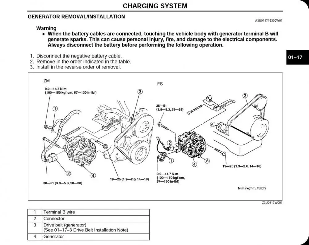

I am replacing the fuel pump relay and the alternator soon,
I noticed either smoke or steam coming from that side of the car and the drive belt is worn a lot.
The alternator is quite easy to remove.

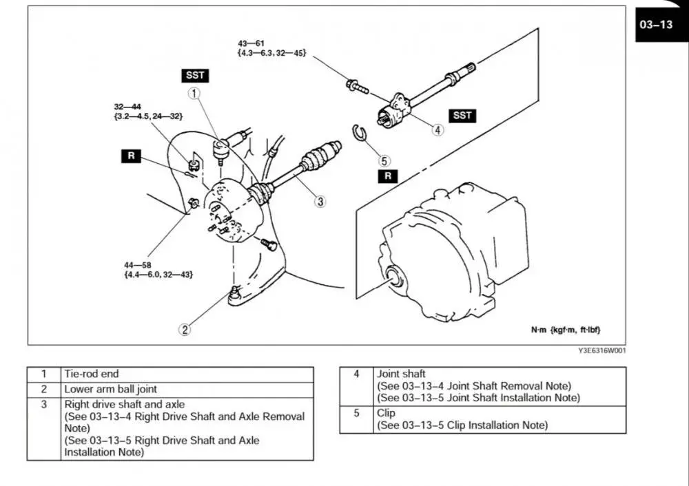

What the service manual fails to mention is that the alternator is trapped inside the engine bay once it's disconnected.
Most people remove all kinds of stuff from above and pull it out the top of the engine.
Mechanics usually pull the drive shift to get it out.
I remember one Mechanic figured out that if you remove the 3 bolts from the joint shaft, the shaft will move out of the way just enough to get the alternator out the bottom without removing the entire shaft and draining all your transmission oil/fluid.

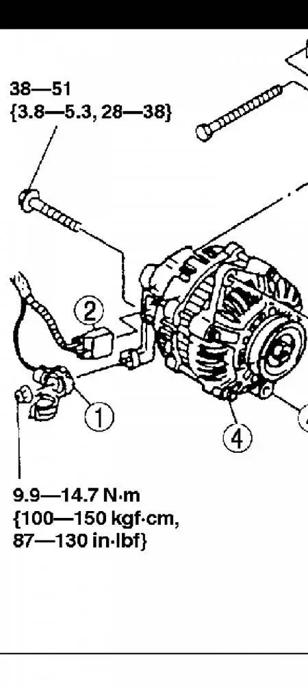

Take a good look at your electrical connector and the harness going to your alternator.
If there is no connection or an intermittent connection between the alternator and the connector, the alternator effectively shuts off.
Yes.
The dielectric grease protects the contact from oxidization.
It also helps conduct and dissipate heat.
If it conducted electricity, it would short out your relay terminals.

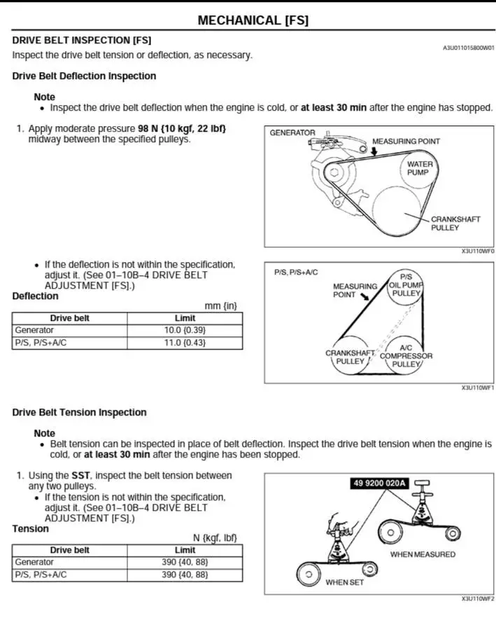

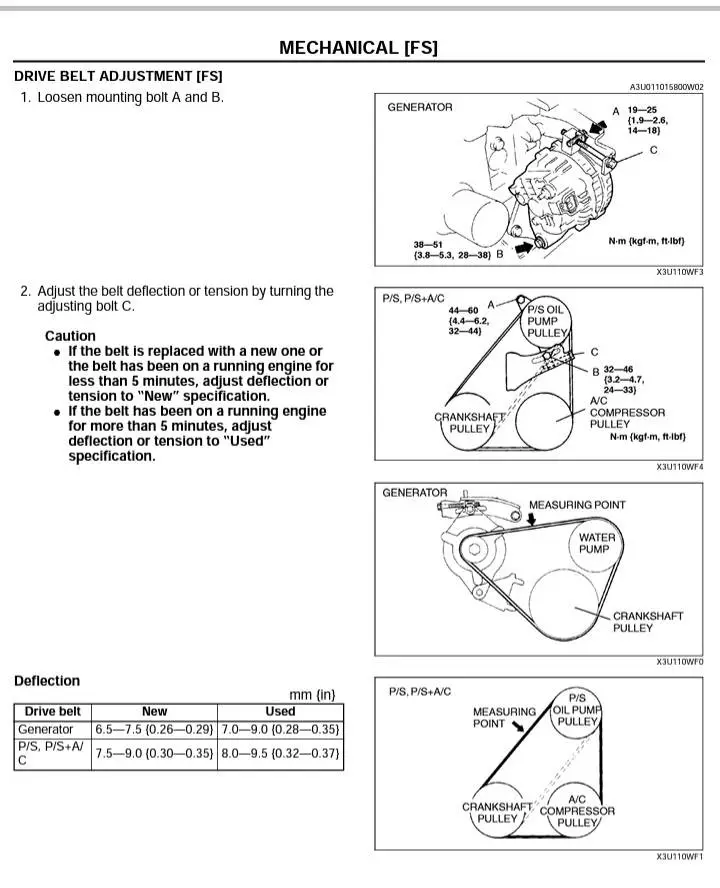

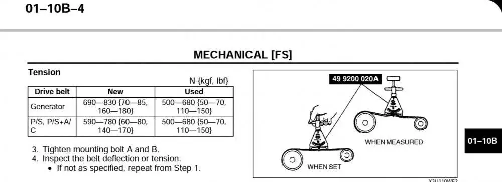

Be careful when installing your new alternator/belt.
You don't want to overtighten the belt or you'll strain and wreck your alternator bearing.
If it's too loose, your belt will squeal.
A good rule of thumb is to reach down to the measuring point and twist the belt.
If you can't twist the belt to stand up vertically, it's too tight.
If you can twist the belt upside-down, it's too loose.
