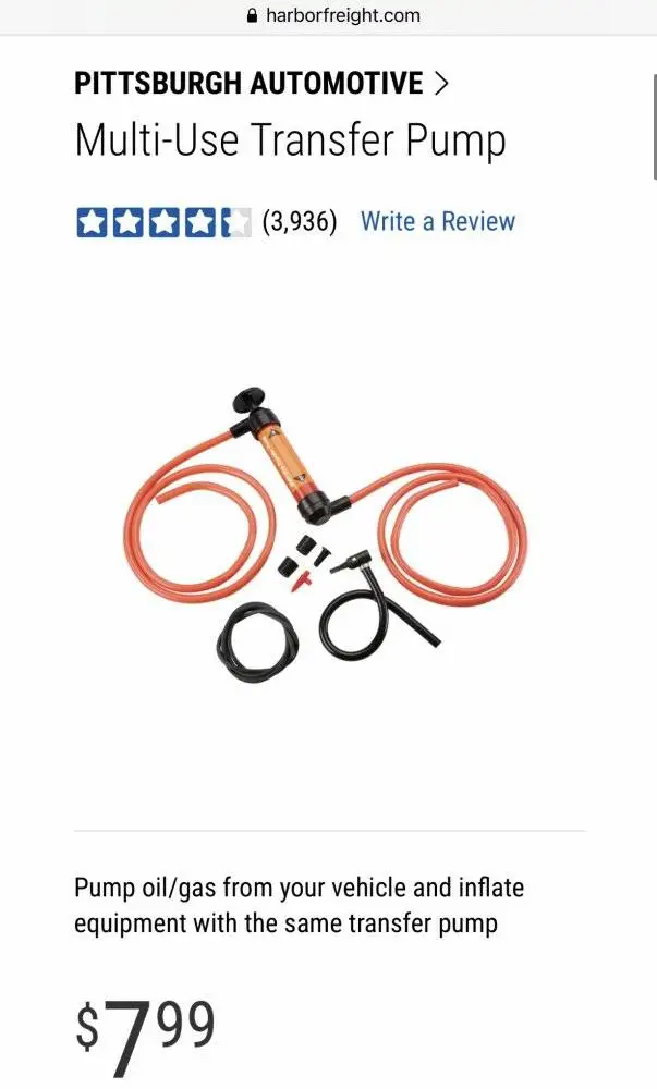

I have used this cheap mini pump before to suck some overfilled oil out from dipstick tube.
Question for you.. I overfilled slightly and bought one of these (not this exact one) .. when i went to put the tube down the dipstick slot, it stopped. I didnt want to force it. Its not a really thick tube but im wondering if they made it that way in the 2025 so you cant do this.. did you have trouble getting it down there?
