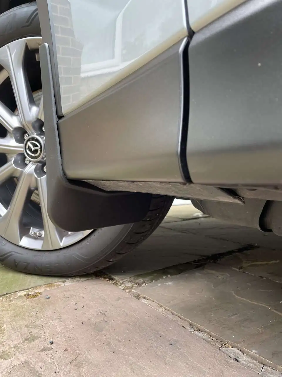

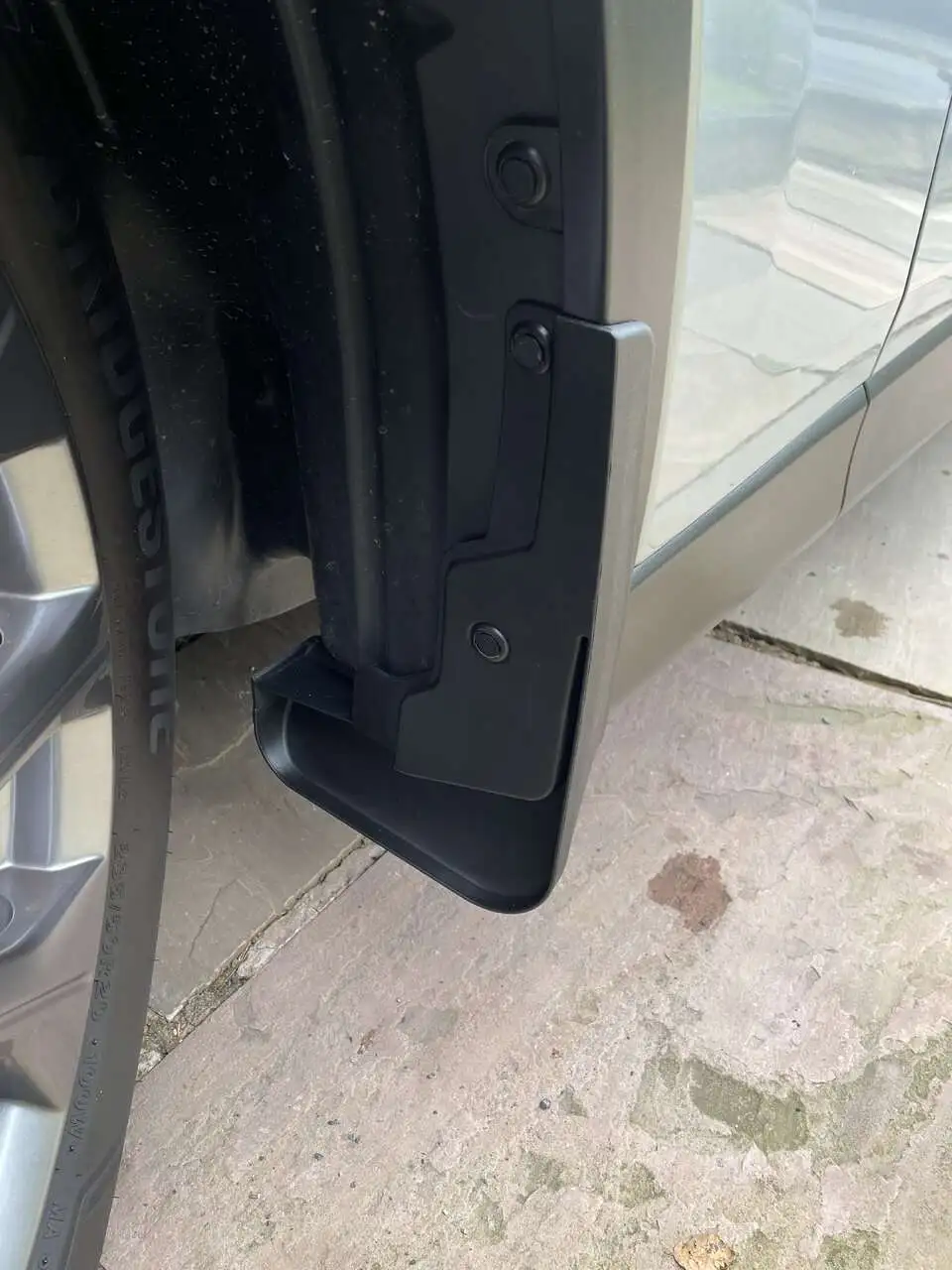

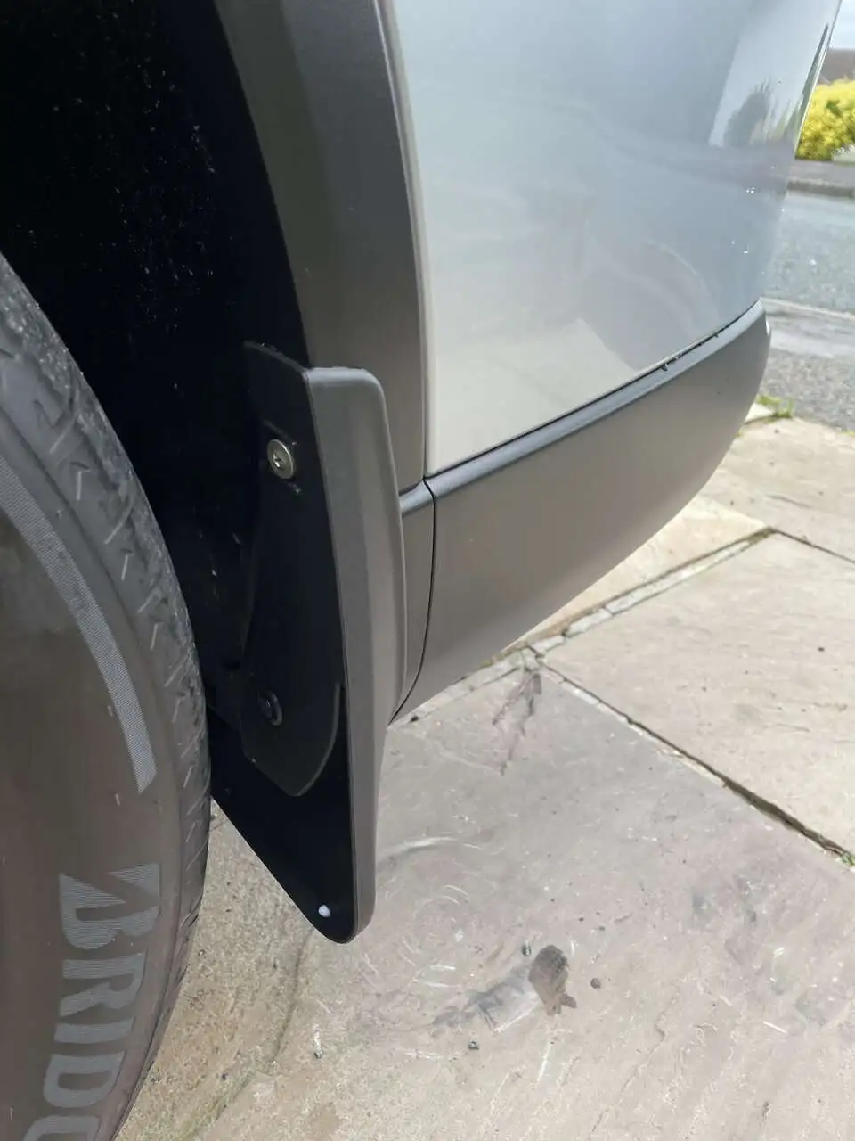

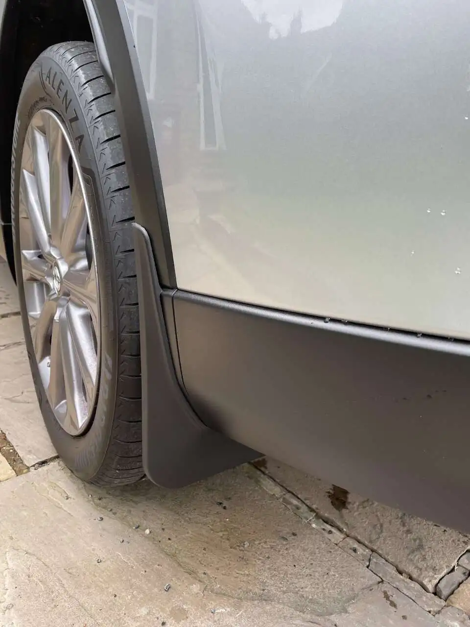

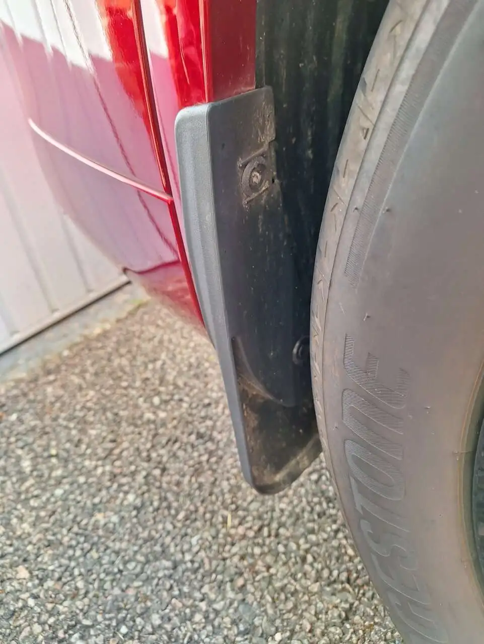

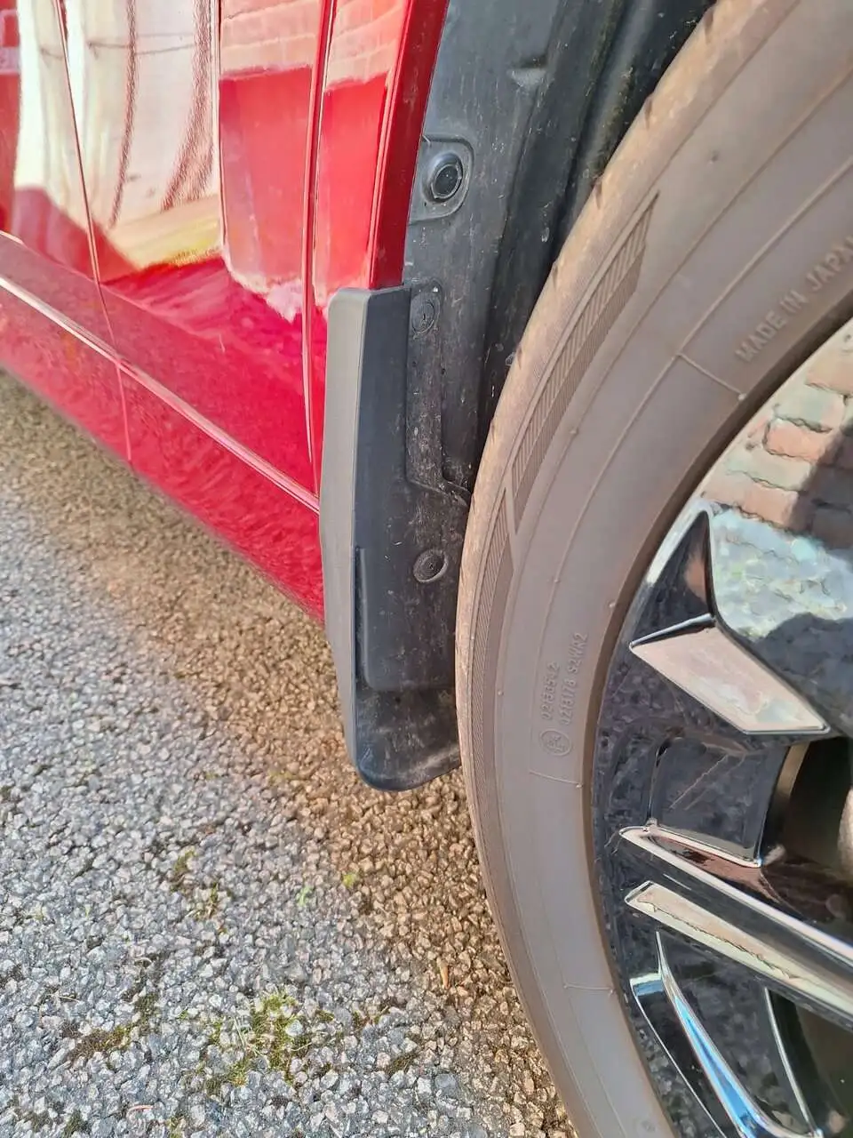

When I ask the supplier if they would definitely fit, they said it wouldn’t also there is a review on Amazon and they state they bought it and it didn’t fit so I know this is an awful lot to ask but would you be kind enough to send a photograph of them on your car sorry for asking and putting you out
James
Hope those pics help. The top fixing on the rear was the one I had to drill but it's in to plastic so no problem. I had to take the rear wheels off to make it easier to drill but the fronts can be done without removing the wheel, just turn on full lock to make access easier.
You superstar that is fantastic and I will give it a go straight away brilliant it looks on the front mudflap that you’ve not screwed the top of it just the area where I can see the screw which seems halfway down. I’m assuming that is tight enough but that’s brilliant, thank you so much.
James
James

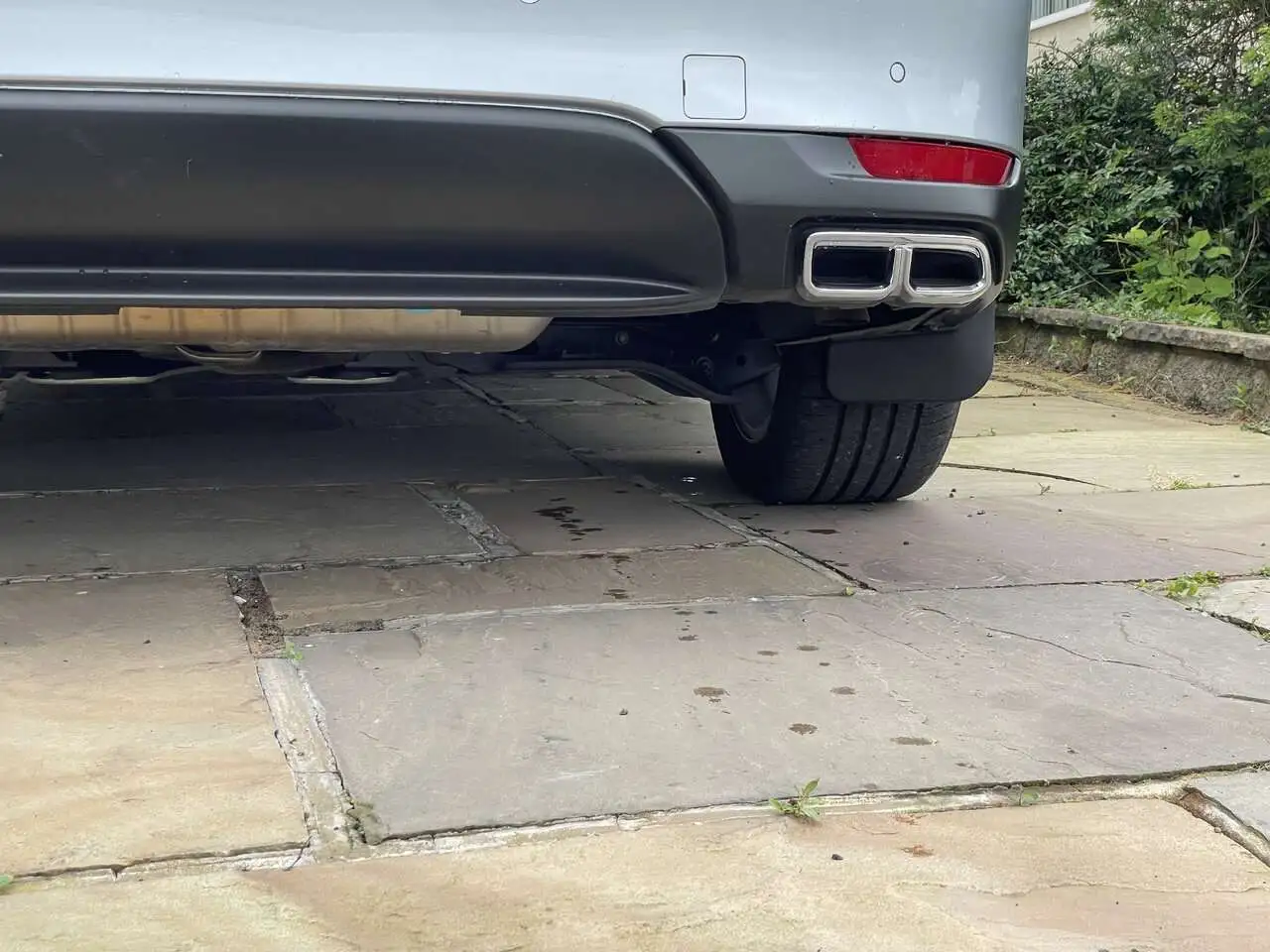

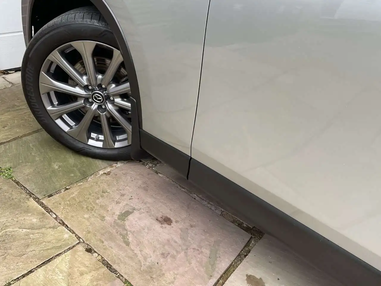

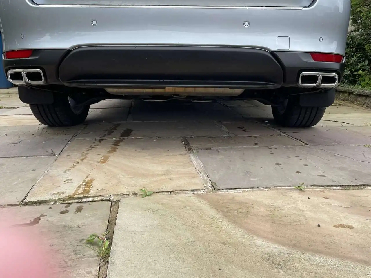

Re the front fixing, there is a fixing right at the top, you might need to zoom in to see it. the flaps come with screw fixings but I only used the existing press-in clips as I don't like the risk of screws falling out and causing a puncture. Am pleased with the way mine look and they have certainly cut down the spray, especially at the back.

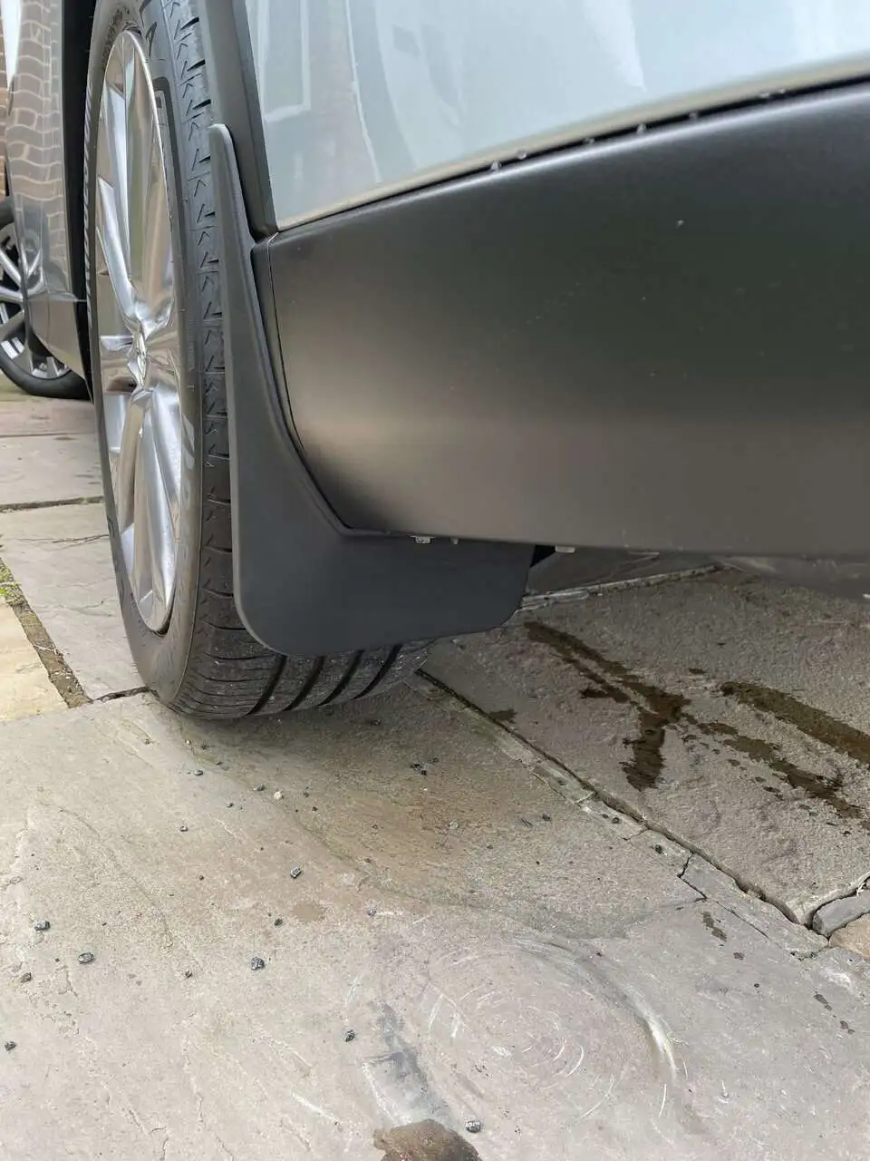

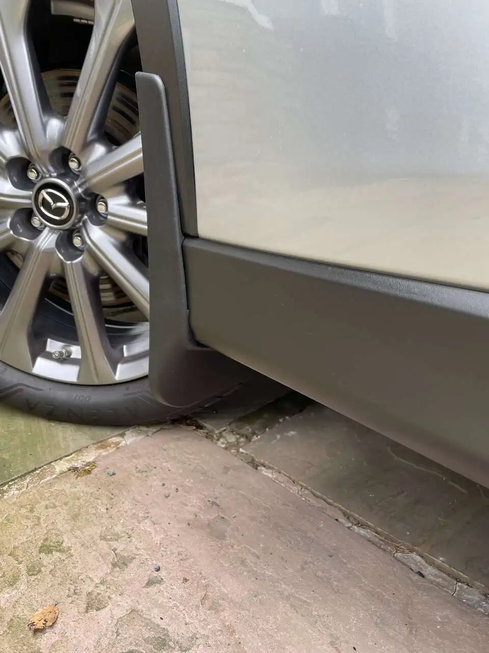

Hello
After Turner20 post had decided to give it a try and I I very happy I did.
Enjoy the photos.
And thanks again Turner20
James
