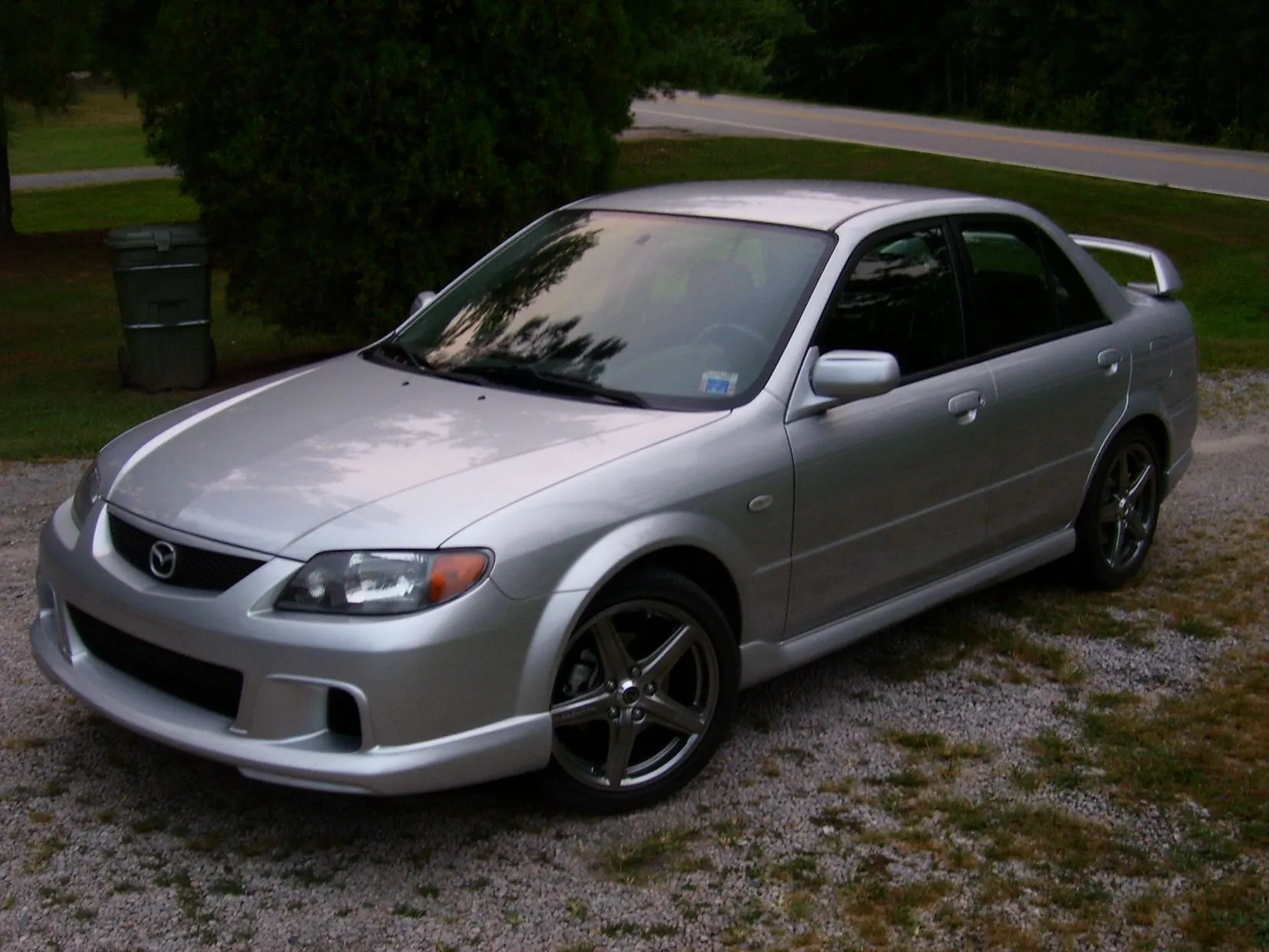

I do have a pic, it's from when i first got the car home(not detailed). I plan to detail it this weekend. Thanks again everyone
Derrick
