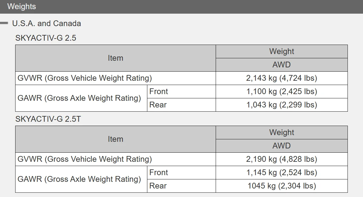

No it is not. Dude. that is inaccurate and completely impossible.
A crossover with it's entire drivetrain suspended over the front axle, and nothing but a drive axle over the rear wheels cannot physically be 50/50.
The owner's manual > your knee-jerk reaction
NA: 51/49
Turbo: 52/48
Note this is GVWR so it's about 1,000 lbs of extra stuff vs curb weight.

This chart lists maximum structural load limits (GVWR/GAWR) rather than the vehicle’s actual weight or balance.
This chart does not explain weight distribution because it lists the Gross Vehicle Weight Rating (GVWR) and Gross Axle Weight Ratings (GAWR), which are the maximum legal weight limits the vehicle and its axles are engineered to support when fully loaded, not the actual weight of the car itself. The GVWR represents the total maximum allowable mass including all passengers and cargo, while the GAWRs specify the structural ceiling for each axle; these figures include a built-in "payload buffer" that assumes the rear will be heavily loaded with luggage or passengers. Consequently, while these ratings might appear balanced, the actual curb weight of the vehicle is significantly different due to the heavy drivetrain, meaning these capacity limits offer no insight into how the car's mass is distributed during normal driving.
If the car can carry about 1,000 pounds, I would think more weight would be placed towards the rear to fully load the vehicle… also considering the cargo area is so far rearward. Not 500 pounds over the front and 500 pounds over the rear. In other words, to properly load the vehicle to maximum, you might add only 350 pounds to the front "axle" and 650 pounds to the rear "axle".
Using my theoretical weight distribution, when you subtract the payload over each axle from the gvwr, I came up with the vehicle weight being 2174 front and 1654 rear… which is an unloaded weight distribution of 56.8% front and 43.2% rear.
In other words… the maximum loaded weight distribution would be closer to 50/50 than the unloaded weight distribution, due to more of the payload being towards the rear of the vehicle.
When Mazda came up with the vehicle's gvwr, I have no idea how much was attributed to passengers, and how much was attributed to "luggage" in the cargo area.
If my numbers and theory is flawed, feel free to point it out.

It's a nice thought, or it could be simply using numbers based on being loaded evenly, we don't know. I'm trying to find more information.
I did find one comment noting that the Miata is nearly 50:50 and the CX-5 can't be otherwise why doesn't it handle like one!? What a preposterous example. Not only does the Miata have a double wishbone front suspension and is just lighter, period, the CX-5 has a whole lot more car over the rear than the Miata does! I know, I have both. I have to be careful taking turns in the rain in the Miata--I've found myself sideways through intersections twice because there is so little weight over the rear tires.

You are absolutely correct in your thinking. Hence which is why if you bring up the global owners manual, Mazda suggests like 42psi in the rear tires for a full load to account for the fact that, most passenger/cargo weight will be situated at or towards the rear axle.
Nonetheless, weight distribution of the vehicles curb weight doesn't mean much. No one considers side to side weight distribution, which also affects handling.
However, none of that matters as much once you are in the car, especially if you have passengers and cargo, because the rear axle gets loaded and stabilizes with weight, as we have seen.

Wish we had some cat/trailer scale numbers for front vs rear wheels. Gross weight is max allowed spec, and we can only guess the distribution of the curb weight. Even though the front jacking point is slightly behind the front wheels, jacking the front of the cx-5 up requires more effort than jacking up the rear via the differential. I use my 4 ton jackstands (newer pair) up front and my 3 ton jackstands (older pair) on the rear
for this reason. I’m guessing in the ballpark of 60/40 to 55/45 weight distribution.
