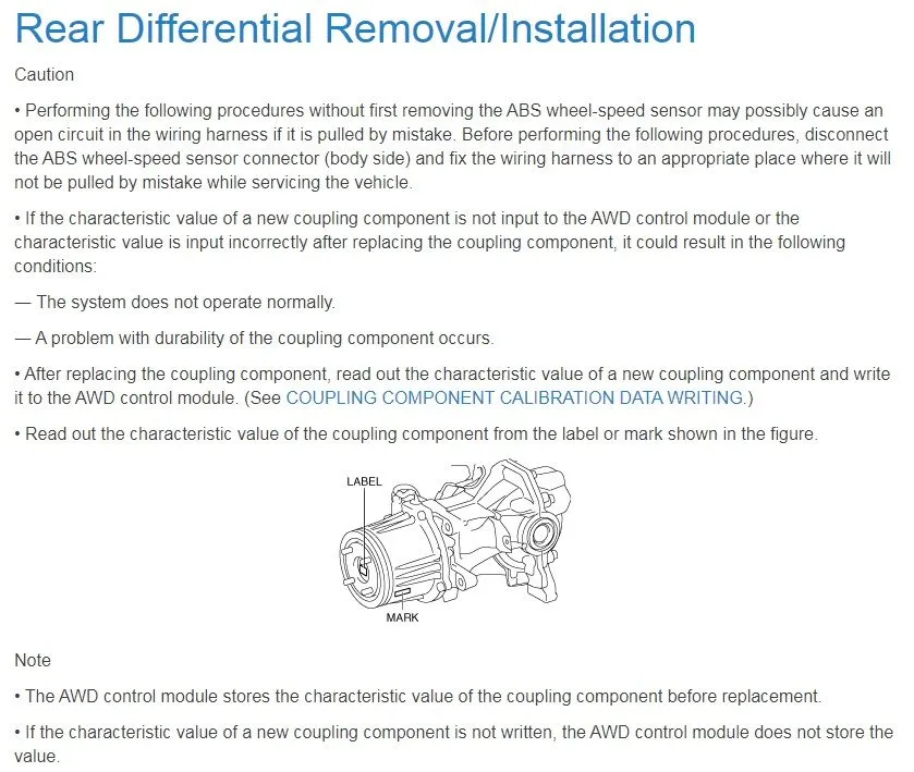

When you replace the coupler, new data must be calibrated into the AWD module. So my guess is maybe you are experiencing that missing piece.
Coupling Component Calibration Data Writing
1.Connect the M-MDS to the DLC-2.
2.After the vehicle is identified, select the following items from the toolbox of the M-MDS.
1. Select “Chassis”.
3.Then, select items from the screen menu in the following order.
1. Select “4WD/AWD”.
2. Select “Coupling Calibration Data Writing”.
4.Perform the configuration according to the directions on the screen.
Caution
• When the configuration is performed, CAN communication between the AWD control module and control module connected to the CAN line is cut temporarily, and communication error DTCs may be detected. After performing the configuration, verify the DTCs for the control module connected to the CAN line and clear it if any DTC is detected.
5.Verify all the DTCs for the control module connected to the CAN line.
• If any DTC is stored, clear it.
• If the DTC is cleared, finish the procedure because the configuration is completely normally.
• If the DTC remains, perform troubleshooting according to the DTC.

Like Silly Wabbit said, a new rear differential requires registration to the 4WD module and may be something else. Moderator Chris_Top_Her here had done rear differential replacement with a used one. He did mention some registration procedures but didn’t go into details. You may PM him seeking for help from him.
Would you mind to tell us what happened to your factory rear differential which required replacement at 50,000 miles? And usually we’d get much cheaper used rear differential from a reputable national salvage yard such as LKQ.com or Car-Part.com, not sure what happened to your experience getting a leaky used rear differential.
