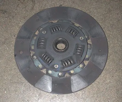

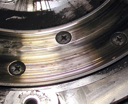

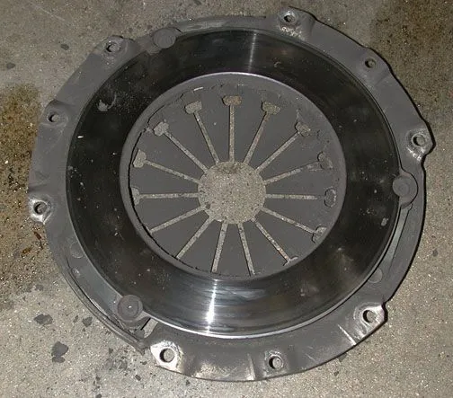

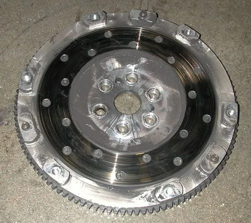

The verdict is in!!!!!
Take a look at the clutch.... The full faced side of the disk has completely come apart. Also the FW contact plate is badly grooved. The pressure plate looks great, no damage. I would say it was a failure of the clutch disk. - Per Michael at SRD
Damn CM clutch.
