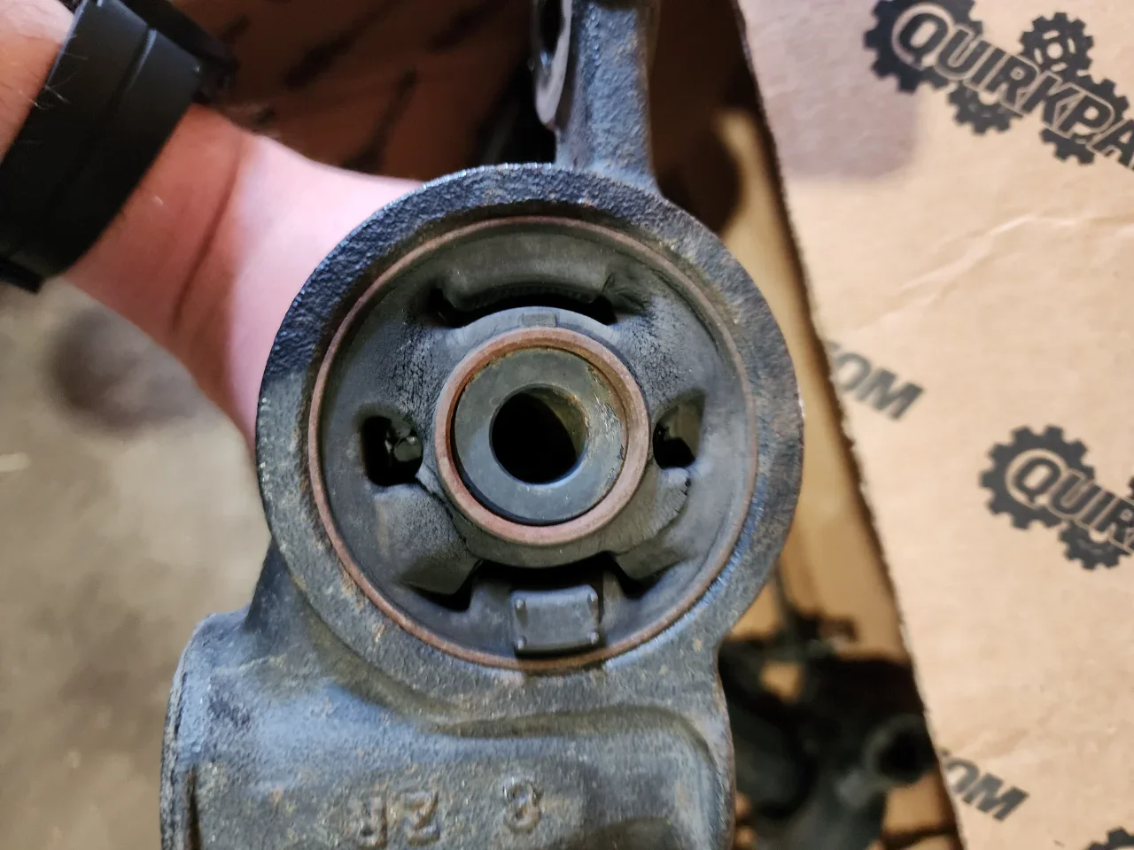

Makes sense if your bushings are torn. This is what they looked like on my CX-5 when I pulled the originals off.
Yep, mine looks something like that.
I brought my car in for some front end clunking. My mechanic said the only thing they were able to find (other than previously noted control arm bushing) was some worn sway bar bushings. It's a lot of work to get to them. Subframe needs to be dropped. If it's just bushings, but all other major components in your suspension are tight, it's up to you whether it's worth to take stuff apart and replace entire suspension components just for a bushing that won't last very long anyways.
Hey, I'd still prefer to have tight bushings, but with the way everything corrodes in salted areas, and the fact that manufacturers would rather have you replace the entire control arm for just one bushing, it's really debatable whether it's worth it.
Yeah I don't even live in an area that uses straight up salt (we use mag chloride), but still had plenty of rust and I had a hell of a time getting any of the LCA bolts off even with high torque impacts / air impacts. It's not a fun job. I try to get the underside of the car cleaned off after a snowstorm.
Replaced all the bolts with new ones. I am going to be doing some work soon when it warms up a bit and inspecting the bushings is going to be on the list.
