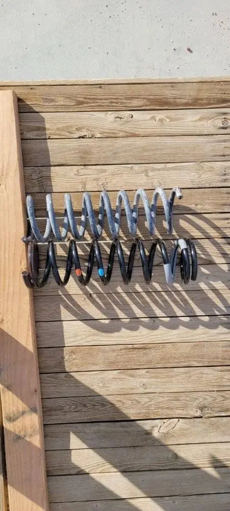

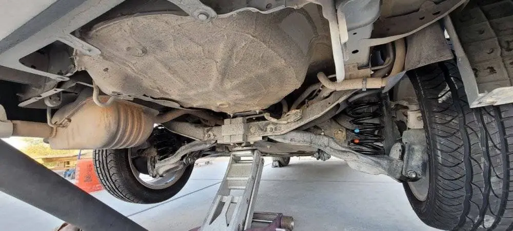

ps got one side on.. not compressed the CX7 spring appears to be closer to 1" taller... I cannot tell 'stiffness difference' just by looking/pushing on them...

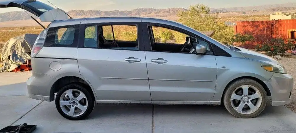

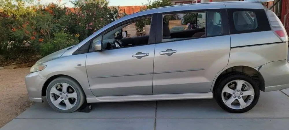

@AnthonyVerde
- done
- looks like a cat in heat / my wife the night I met her in the club (LOL!)
- but of course I fully expect the springs to settle
- definitely don't have negative camber now lol..
- haven't driven it yet, so we'll see how the settle affects the camber
Didn't notice any difference in the rear after the springs other than everything sitting a bit higher — probably a good 2 inches. And yeah, just a direct spring swap using existing Mazda5 mounts. I eventually upgraded the rear shocks to KYB gas-a-just (for Mazda5) just because the stock ones finally let go. Feels much better now. I bought the 30mm front spacers off eBay (some seller in Russia). They sit on top of the strut — pretty easy install.

View attachment 299726 View attachment 299727 View attachment 299728
Hahah, love it!
After I did my rear springs, my wife said our 5 looked like those accessible wheel chair vans.
Did you release the e-brake after lowering the van down in that picture? The springs will settle over time for sure, but the strut spacers up front will help reduce the raked look, too.
