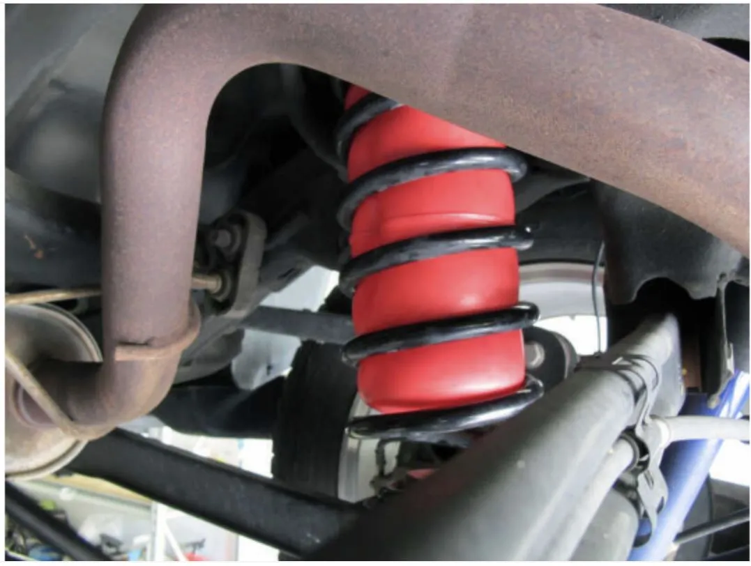

One thing I did run across while looking at this last year was helper air bags. They’re just cylindrical air bags which go inside the rear springs. Pump them up and they help support the spring and keep it from bottoming all the way out. I’ve read generally positive reviews on Sites like etrailer.... most of the negatives have to do with people having leaks from their connection points. That site doesn’t list a match for The mazda5, so we’d need to figure out what the interior space size is and then see if there’s a bag set which would fit that.
Here’s what the bags I’m talking about look like, and our 5 loaded up for vacation the last two years.

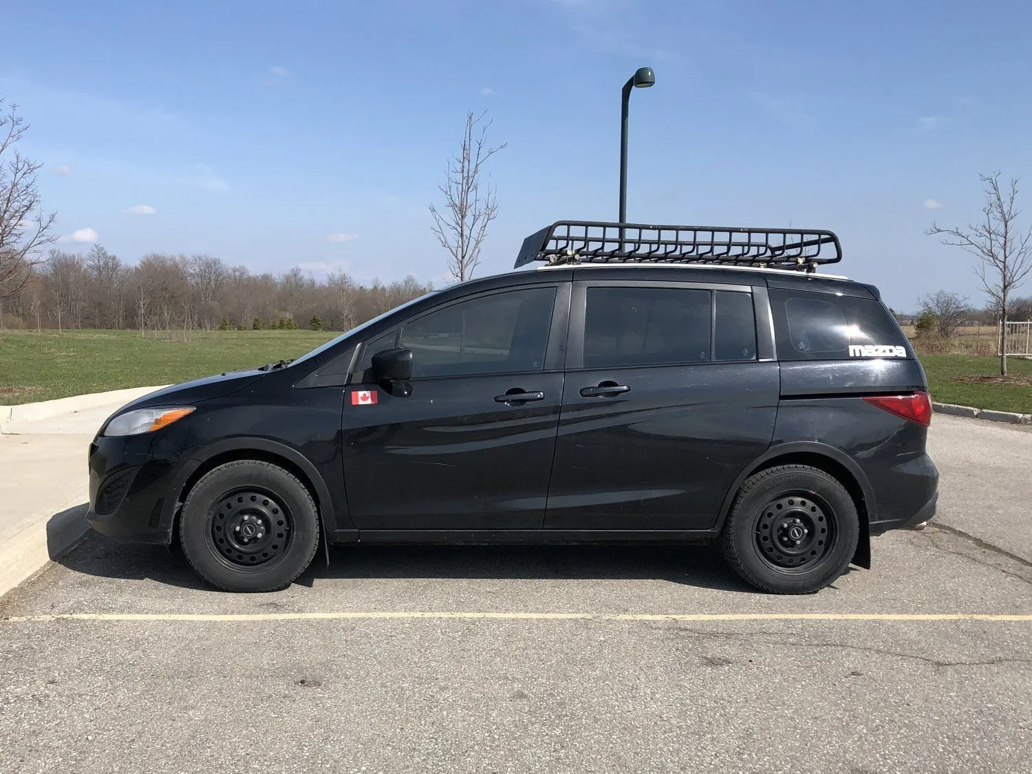

I addressed this issue with our 5 a couple years back by replacing the stock rear coils with CX7 rear coils. They're the same diameter, but slightly taller. This won't be the go-to solution for folks wanting to maintain stock ride height (or going lower), but that wasn't a concern for me. I added a strut spacer up front to level the ride height out and added some chunkier tires as well. I'm happy to report that I was able to haul just over 1,000lbs of topsoil (in bags) a couple of weeks ago. It was definitely sagging, but no rubbing or bottoming out!
I knew there had to be an OEM swap from something else possible. Did you change the shocks at all? If not did you notice any change with more spring and the same dampers? How much higher did it sit with just the springs? What spacer did you use for the front struts, and where does it install? Sorry for all the questions, just this is great news.

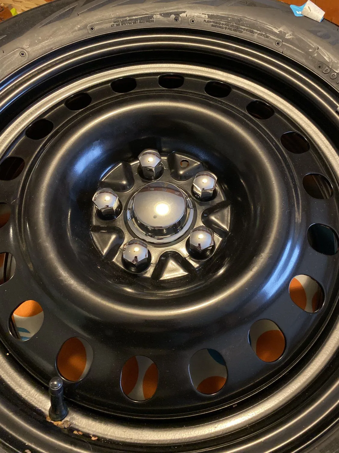

Also nice on the center hub covers. I was looking at something like those (those Ford ones?) last winter on my new accord. Never put anything on my 3, or on my 5.... those hubs are nice and rusty at this point and I should probably do something about it. Ended up going with a smaller chrome cover, and chromed vinyl caps for the open lugs. The caps were snap in, but I used VHB tape to mount them and cut the clips off since they sit flush.

Oof. Mazda 5 rear coil springs are about $50. CX7 ones are $100-150. Did you use the mounts from the Mazda 5, or buy CX7 ones?
Didn't notice any difference in the rear after the springs other than everything sitting a bit higher — probably a good 2 inches. And yeah, just a direct spring swap using existing Mazda5 mounts. I eventually upgraded the rear shocks to KYB gas-a-just (for Mazda5) just because the stock ones finally let go. Feels much better now. I bought the 30mm front spacers off eBay (some seller in Russia). They sit on top of the strut — pretty easy install.
And thanks regarding the center caps! Yeah, they're Ford/Mazda — specifically from the B-series pickup. Had to drill and tap some holes in the wheels to screw them in as they don't snap to the hub in any way. Pretty happy with them as I don't have money right now for some decent alloy wheels.
nothing wrong with steelies. It’s nice to have a wheel that can flex a little with bumps. Plus they’re only like $80/wheel

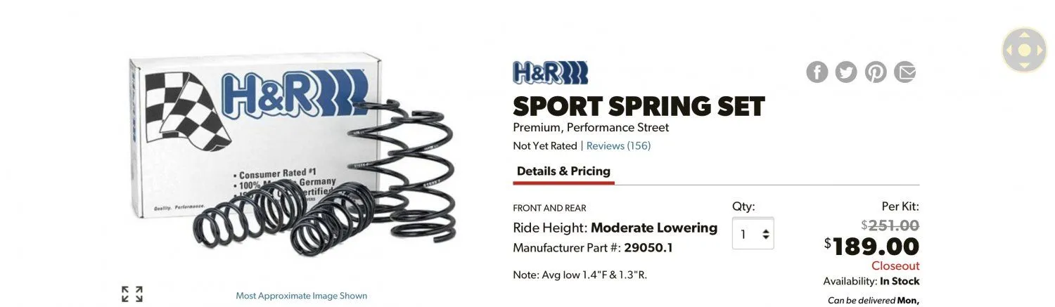

And then I run across this. Closeout on H&R Sport Springs with a claimed 1.3” lowering on the CX7. $189. That’s more expensive than the helper air bags, but cheaper than new OE CX7 springs at $100/side, and potentially not as much of a height rise as the OE CX7 springs.
Thoughts?

Yeah, I went with the coils from a 2012 CX7 AWD as the vehicle is heavier than the FWD (by a couple hundred pounds if I recall), so I figured the springs would be beefier. The springs are cylindrical — no tapering or anything. Like I said, I identical to the 5's springs, but taller.
Agreed. The only downside is they rust up pretty quickly from the salty Canadian winters. I need to take a day this summer to sand down both all season and winter wheels and give them a coat of rust paint.
Good point. The standard CX7 curb weight was about 500 lbs over the 5 (3,450 vs. 3900). The AWD curb weight was Another 100-200 lbs over that. Doesn’t look like there were any differences in the towing capacity of either one, so I’d assume the difference was in the extra weight.

I expect lowering springs for a heavier car to ride higher than my stock springs. I’m just hoping they’d ride a littler lower than the 2” rise you describe when on the lighter car. It’s possible I’m looking at that the wrong way, and the stiffer shorter spring would actually ride higher. I haven’t lowered any cars or replaced anything with other than stock equivalent suspension parts. I really like the idea of the ass of the car not sagging down a bunch with weight. My two older kids ride in the third row seats all the time. That’s only a 100 or so pounds, but still.

Alright, I’m biting the bullet and ordering the H&R CX-7 lowering springs. These are progressive, so hopefully they’ll provide a sort of normal ride, and then stiffen up as more stuff is added. I’ll report back once things get installed.
I just realized your roof rack appears to be mounted on rails which go the full length of the roofline. Is that a standard Canadian thing, or something you added? I haven’t seen anything like that in the states..... all roof racks just mount to the hardpoints along the side gutters.

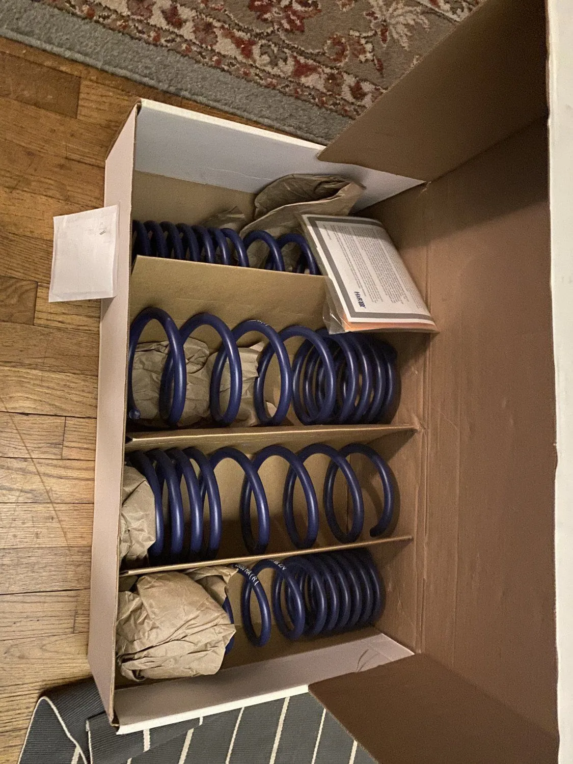

H&R springs arrived today. New shocks will be a couple of more days at least, so not doing any install until at least the middle of the week. The rear coils measure in at 14” long.....do you happen to remember how long the stock Mz5 and CX-7 coils were?
