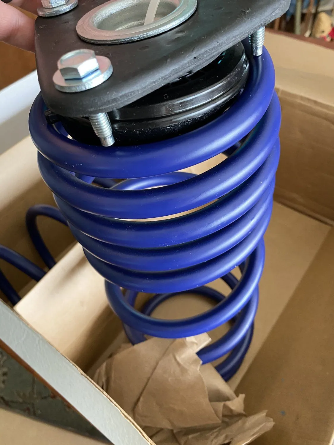

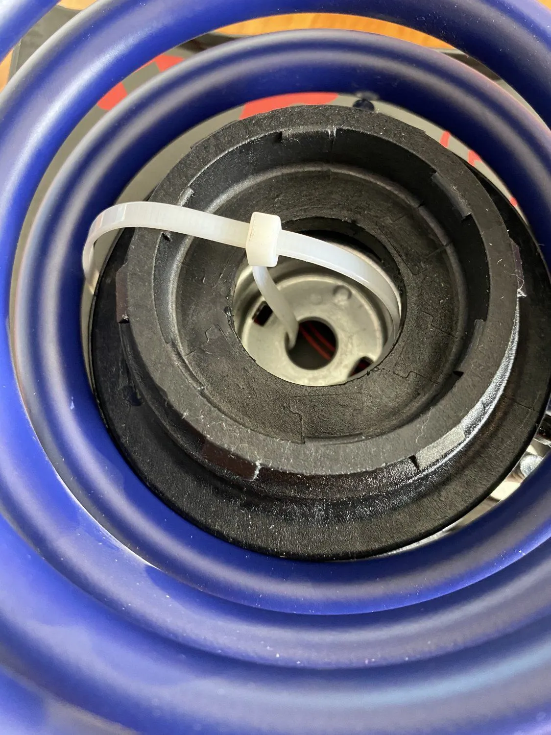

I’d say the diameter of that top coil manifestly has a bearing on fitment. It has to have an end coil which gets to a small enough size to mate with the mount.
That said, if the top coil is too wide to fit the Mazda 5 top mount, I'd think the solution could be as simple as getting matching CX7 top mounts. Look at some parts diagram to get a quick visual confirmation. The top mount consists of bearings+isolator fitted inside of a hard mount housings. This part 'should' be interchangeable b/c the top mount only uses the shock piston nut to secure the spring; the top housing mounts the whole assembly to the chassis. What needs to be confirmed is if the Cx7 top mounts aligns with the 3 holes on the Mazda 5 chassis, which I'm betting it will.
Not a bad point. I just looked it up and the CX7 uses a four stud connection vs. the three bolts on the 5. Even if you could somehow mount the 5’s top plate onto the CX7’s bearing assembly the 5 uses bolts which thread into the top plate vs. studs which go up. So they’d stick right through the plate and into the top of the spring. I’m just calling it on the front springs.

Here’s what the Mz5 mount looks like just sitting on the CX7 front coil.

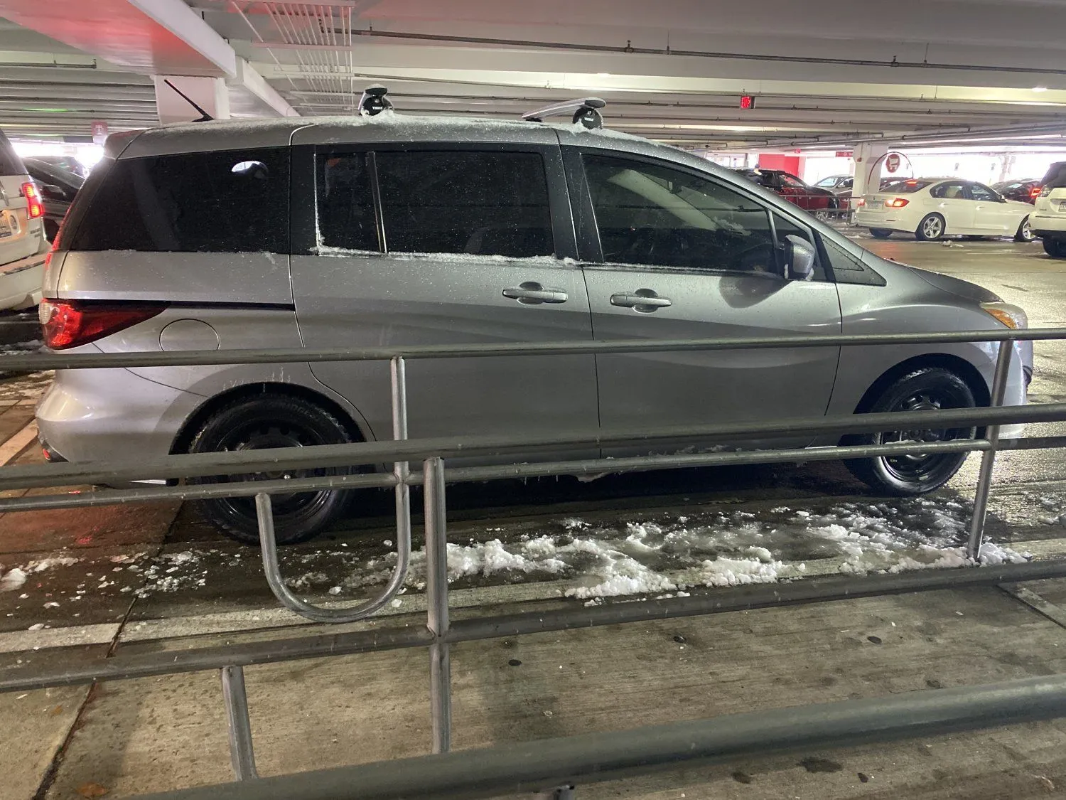

Update after a long while. No issues with the CX7 lowering springs since I installed them last summer. I didn’t end up taking that car on a big trip last year, so it hasn’t really been loaded up with weight to speak of since I swapped the springs. I went to pick up some firewood today, so this is the first chance I’ve had to judge it with weight in it. This is 1/8 of a cord, kiln dried oakwood. Probably between 300-500 pounds. Barely moved the back end at all.... maybe 1/2” drop. Car drove wonderfully and felt really solid with no heaviness around corners, and no bottoming out over bumps. This is probably a little under the weight I’d be adding by having six people (three adults, three kids), a loaded roof box, and bikes on the back end. Still, a nice partway test.

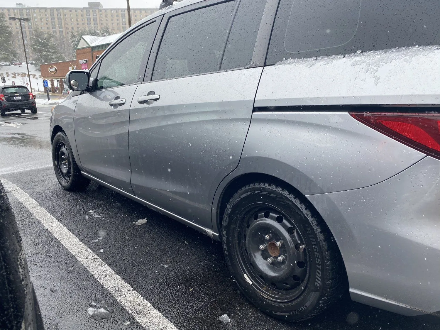

Hahah, I love that I have a modification named after me.
I'm running a 16" wheel with 215/65r16 tires. The tires are not quite A/T spec, but do have a slightly more aggressive tread — I'd say they sit between a road tire and a trail tire. But at the 215/65 profile, you can certainly opt for an A/T tire if you'd like — Cooper, BF Goodrich, and Falken all have decent A/T tires.

thanks anthony... I'm trying to correct the negative camber issues on the rear by raising the ride height and stiffening the rear a tad...
are those just regular 16" steelies?

And yeah, the steelies are nothing special. I ordered them with the tires through pmctire.com. They're a Canadian company, so shipping is free in Canada. And their prices are super competitive. I'm not a fan of the exposed hub look with steelies, so I ordered a set of used center caps from a 90-something b-series pickup. Had to drill and tap three holes in the rims to bolt the caps on.

@AnthonyVerde can you please spec the bolt-pattern on your steelies you have? I am doing your mod soon. Thank you...
Bolt pattern is 5x114.3" and centre bore is 67.1. These specs are standard across Mazda3, Mazda5, Mazda6, CX3, CX5, CX7, CX9. Only differences would be wheel offsets, but they're all fairly interchangeable. Be mindful of the centre bore — it must be 67.1 or greater. Any smaller and the wheel will not fit on the hub. You can with a larger bore, but you'll need a hub adapter. Also keep in mind that a 16" wheel is the smallest that will fit the Mazda5 due to brake sizes.
