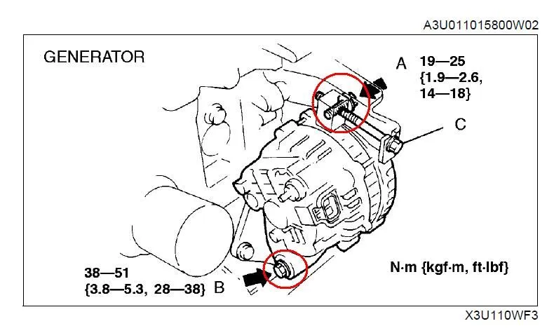

You need to losen the 2 circled bolts in the pic below before the alt will budge at all. The bottom bolt is easy to get to from under the car, the top bolt you can get to from above along with the tensioner bolt.
+1 ^
i did this just last week.
jack it up, or ramp it up and get that last bolt on the bottom.
then loosen the alternator as much as possible and it should just slip on pretty easy.
