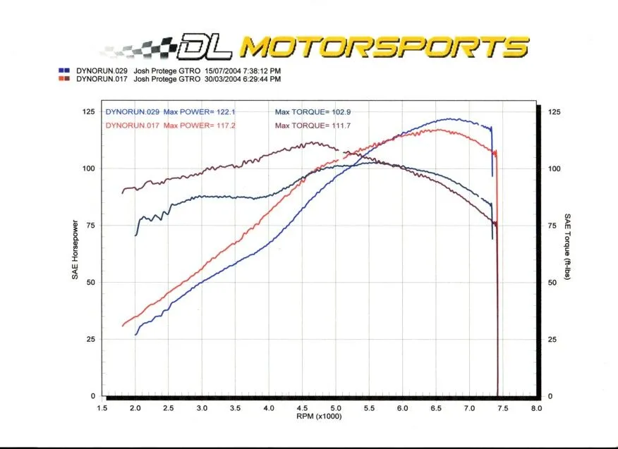

Keeping it in the horsepower curve is important, because horsepower is what accelerates the car. But throughout first gear, the axles are turning 'harder' because of the torque muliplying effect of the tranny. ie if your final drive is 4.105 and your first gear is 3.8, then the torque muliplyer is 15.6. Which means if you're getting 100lb-ft of torque at the flywheel, then you're getting 1560lb-ft at the axles. Because of the extreme ratio in 1st gear, it's really the only gear that helps a whole lot with acceleration. After that, it's all about horsepower.
Look at the rev curve on this dyno chart. I know this curve is more high RPM happy than a typical FS curve, but the point is the same. If I were to shift at peak power, BEFORE the power starts to drop like you say is beneficial, it would put me at about 65whp down from 117whp. If I kept on it right til fuel cut where I'm still making 108whp, at every point above peak I'm still making more power than had I shifted, even though the power is dropping. And if I shift at 7400 it'll drop to around 4400RPM, where I'm making just over 90hp at the wheels. My point is that although hp is going down after peak, it's still more horse power than if I shift.....

twilightprotege said:
think of it this way. what power are you making at 6500rpm? and what power if you change to the next gear at 6000rpm (ie your new rpm)? i'd be certain you'd be making more power at 6500rpm than at 3500rpm when you change gears at 6000rpm...
What's wrong with your tranny? When I shift out of 1st at 6k I fall to 4000-4200....
