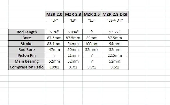

Twowheeled from Miata.net did some research to try and find some specs on the various iterations of the MZR/Duratec blocks. There is some data but its all scattered across various threads and not many people seem to know exactly what is a swap and what is different between these engines. Here is what I have found so far.. feel free to add some of the missing info if you can find it.
Notes:
-Head and oil pan are direct swaps between 2.0/2.3/2.5 but not 2.3 DISI
-Bolt bosses/headpatterns/bell patterns are all the same except 2.3 DISI
-2.3 and 2.5 has balance shafts and gear cast onto the crank, except the 2.3 Ranger crank.
-2.3 has a higher deck height than the 2.0 so rods are not interchangeable. The 2.3 appears to be a stroked 2.0 and the 2.5 is a bored and stroked 2.3.
-Duratec 2.0/2.3/2.5 appear to be similar castings as the MZR's visually, and as such should be interchangeable. Although this is untested.
-Headstuds are the same between 2.0/2.3 engines, mainstuds may require modification.
Thank you two wheeled from Miata.net
Here's an attached chart from his research. Maybe someone here will also be interested.
