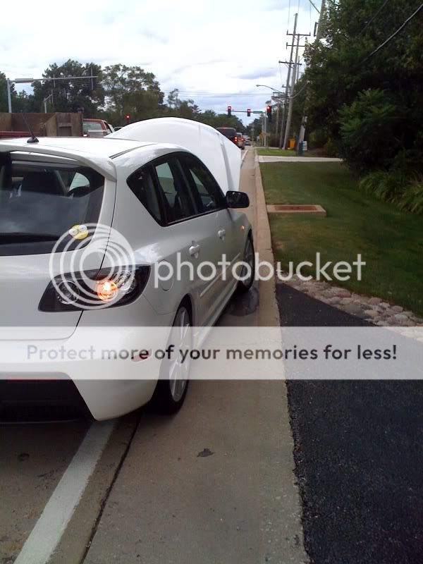

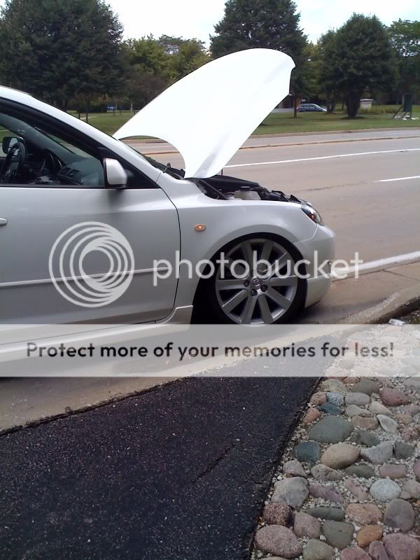

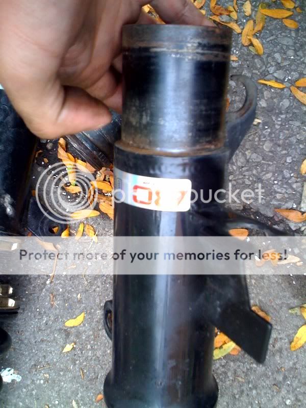

So on Aug 21st I was on the expressway and I hit a small bump in the middle of a curve and I immediately felt that the steering was "loose" and not as responsive. The steering wheel was no longer aligned to be straight when the front wheels were straight. I took the first exit I could and I down shifted to about 30mph because i was approaching stopped traffic at an intersection. As soon as I put any pressure on the brake pedal I felt the car drop and dive to the RF side and it came to a halt quickly.

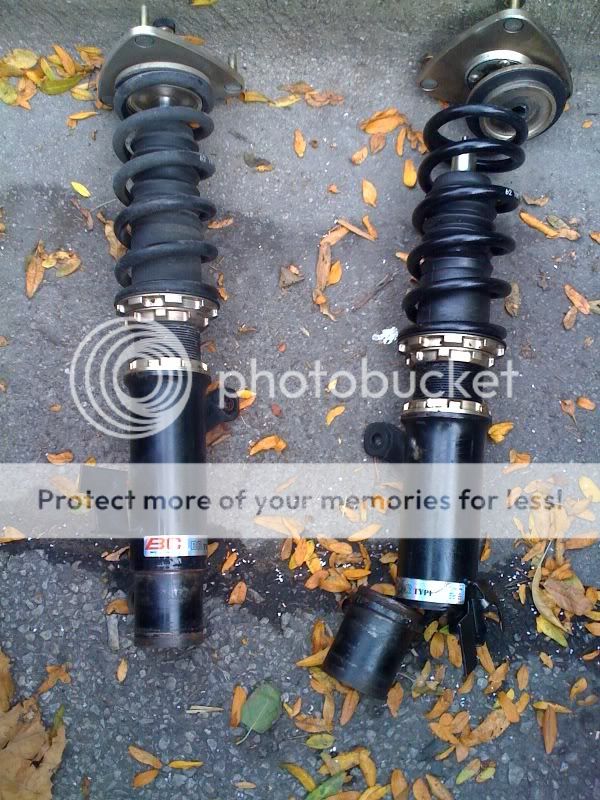

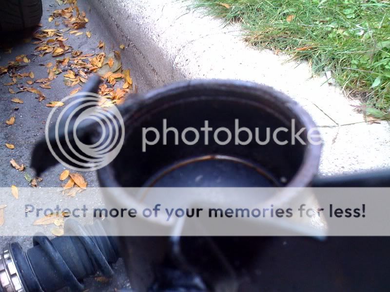

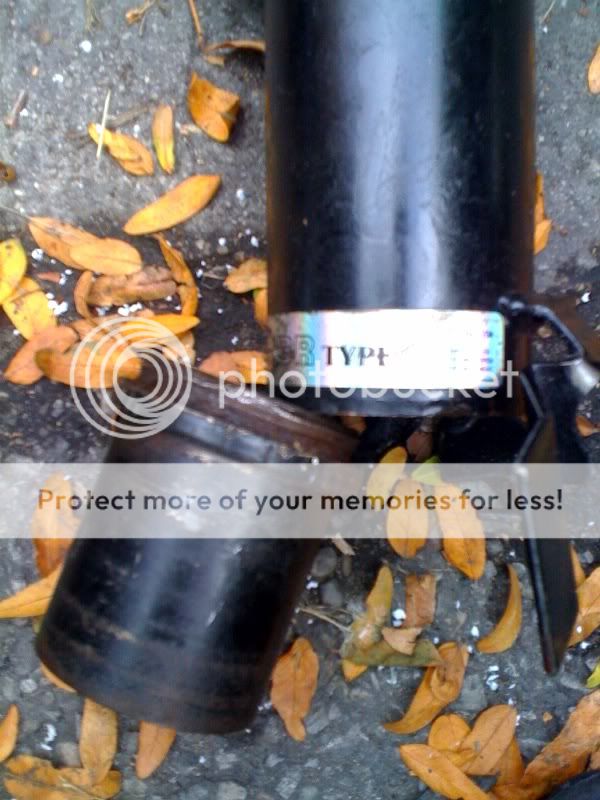

As soon as it happened I knew what it was. The strut had separated and the wheel was in my wheel well supporting the weight of the car on the tire. The strut split in half a little above where it sits in the sleeve(or base). It looks like the top part of the strut threads(about 4 threads) into the lower part and BC welds it at that connection. Upon removal of the damaged strut I also noticed that the "hook" that keeps the the strut from rotating and holds on to the pinch bolt was missing.

The puddle in the first pic is not from the car.

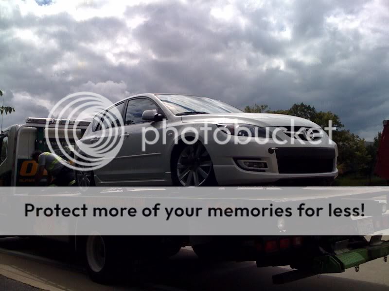

Thanks to O'Hare Towing for being delicate with my car and charging me only $170

Here are pics of the hardware itself. You can see the threads and how they were "cleaned off" when the strut flexed/collapsed.
This is a photo of the GOOD strut and how it's threaded and welded at the top of the sleeve
