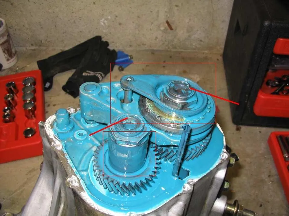

you are missing a piece.
There should be a piece that goes under the lock nut and then has a rod that goes through the holes in the shift fork and braces against the casing.
Ah, I saw the hole that I hadn't seen before. I'm used to seeing the earlier model G series boxes. I'd love to get my hands on one of them boxes to see what other changes they have made.
How about the other shaft...shouldn't there be a spacer as well like on yours? How the hell is the tranny working with missing pieces?
Thanks.
There should be a collar on the other shaft that is like 2" long... and that is what the nut tightens down against.... you don't have that either?? I can't tell from the pic...
Missing that secondary part on the one side isn't the end of the world as far as function, but I'm sure it serves an important purpose of some sort... the spacer would be more concerning for me...
No spacer either. Do you think the MSP trannys did not come with those? Because I can see the indentations for the locks on the nuts on the shafts themselves. If not, then Nick ****** up again! I've got a whole book already on how Nick ****** me over this one simple tranny job that I'm getting ready to reveal to everybody pretty soon in hope that nobody else gets burned like I did.

Damn man didn't realize you were having such a problem with him, maybe he is better working with installs on the MPI the tranny work....
There is no rod you are missing. Nor is there spacers under the nuts. Everything looks normal in that pic.
I beg to differ... see below.
You have an old style transmission. We have a new style. I have done both, again, I see nothing wrong with that picture.
Though I can't remember how far out the plastic piece goes...I think yours looks normal.
So either there is some serious differences between the tranny in the MP3's and the MSP's, or there is something up with Custom's tranny. And since we all are supposed to have the same tranny in theory. But I do remember that there was talk of the MP3's having a G5 tranny while everyone else had a G15 or something to that effect.
Then there you go... but to me his tranny is "missing" pieces... as the two I've taken apart were both MP3 trannies, and obviously they made some changes without changing the notation for the transmission. Looks like cost savings maneuvers to me....
The black plastic piece has to reach the black end cap... at least that is what my does/was intended to do..
