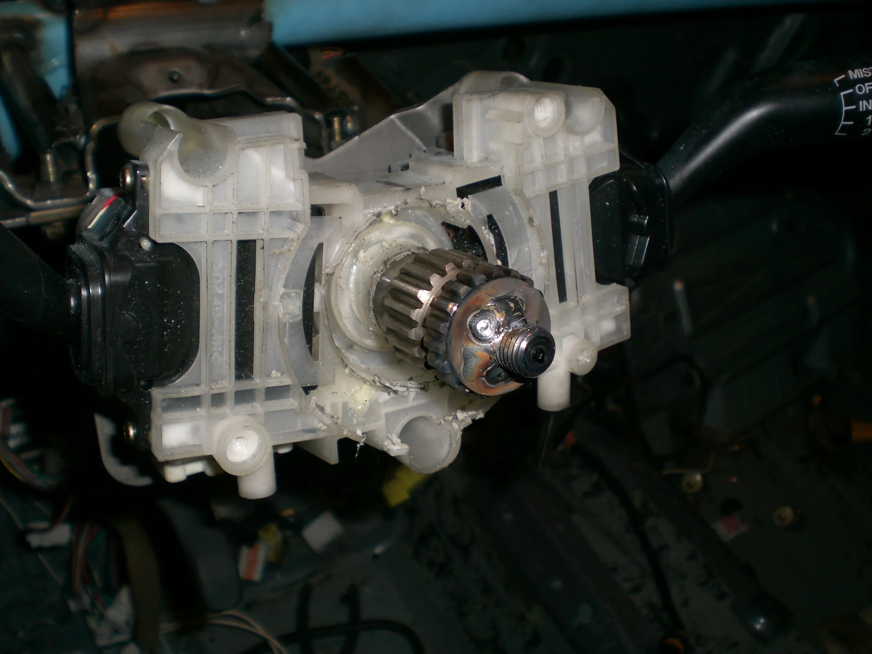

hey man. Love coming to you for questions since you always have a answers. I am now finally prepping my car for W2W. The class I will be going for is not that strict but the one thing I was hoping you might know is they want me to take out the steering lock. Do you have a pic or anything that could help me figure on doing this???

I don't remember exactly which piece locked the wheel, but if you pull the air-bag, behind that will be a nut that holds on the wheel. If you remove that and pull the wheel off you will see all of the internal components behind it. It's not too bad. This was the only photo I could find that might help and I chopped the plastic quite a bit to fit the spline on it.
