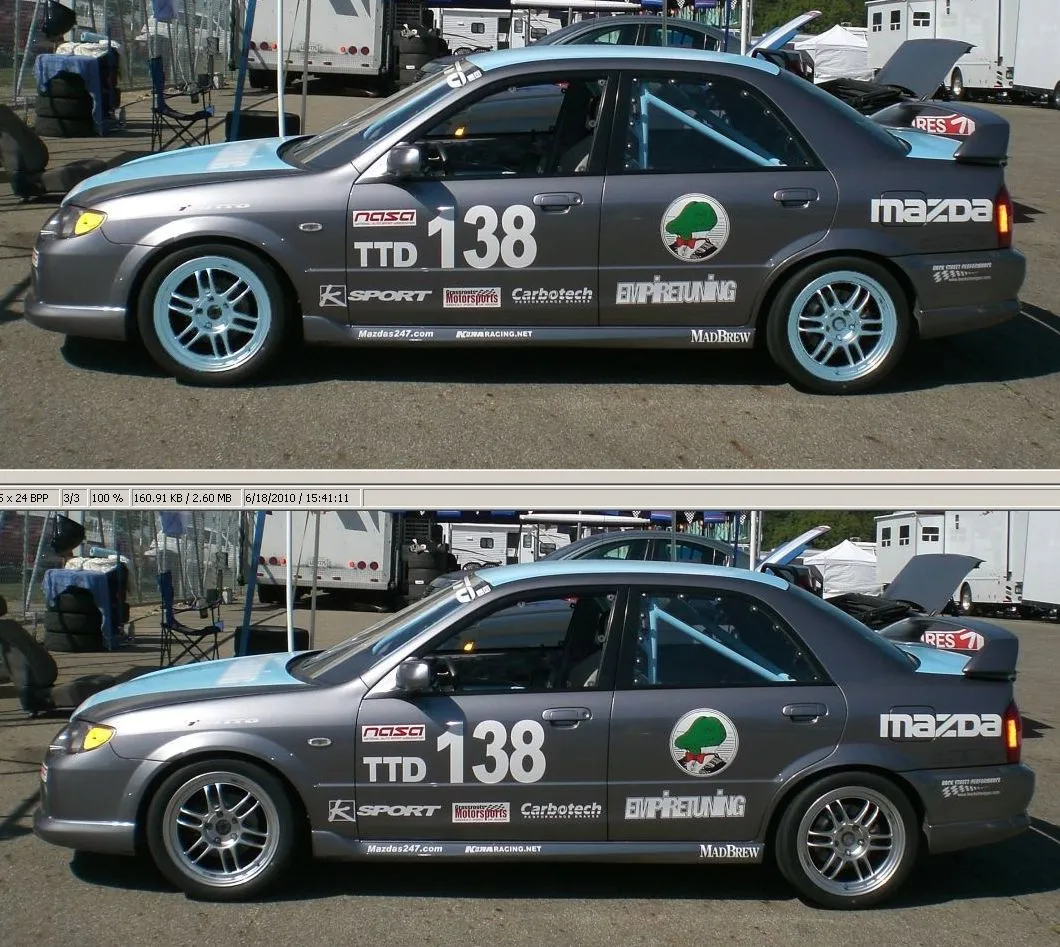

Anyone have comments on which one of these looks better?

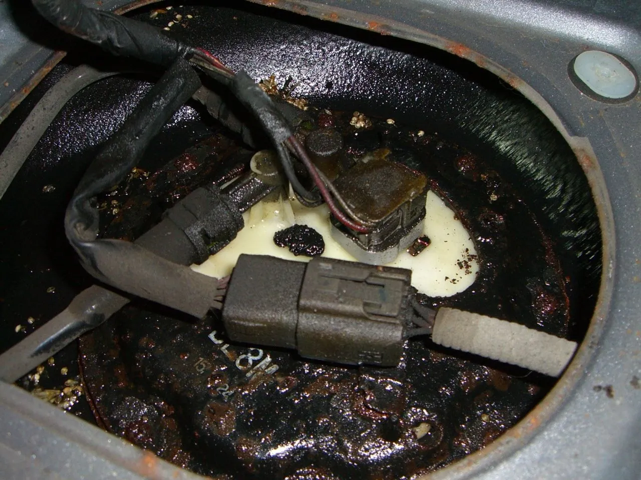

Good news, corner weighting is done; bad news, I found a fuel leak while putting the car on the trailer so no dyno tonight. Hopefully I can get it fixed before BeaveRun this weekend.

What sort of a leak did you find? Hopefully it's something that won't be too hard to fix.

Looks like the top of the fuel pump. Hope Mazdaspeed has them in stock.

Can't wait to meet you. Oh and the wheels. I liked the bottom
picture better. But thats just me.

My pump got here yesterday, but the heads of all the screws stripped out because they are so rusted. Luckily Mazda was able to send a new tank overnight even though I missed the order deadline by an hour (Thanks Mazda!) so I should be able to put the new tank and pump in tonight and be ready to go.
