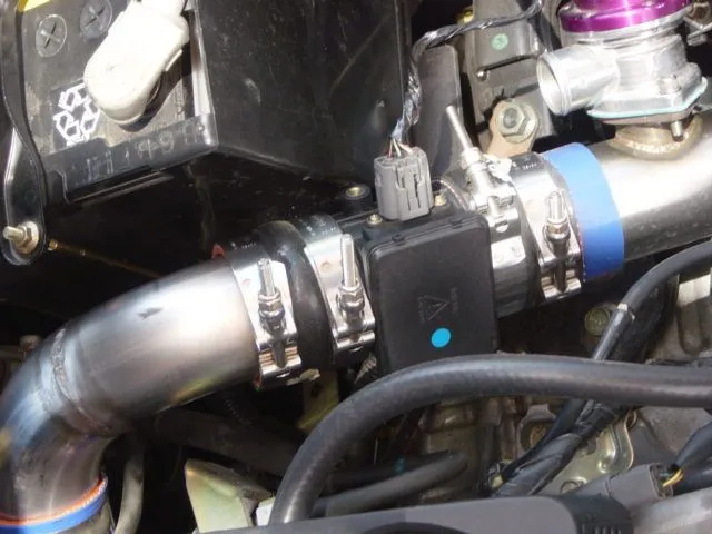

My new MAF setup + extra pictures

Here are some pics of my setup.
not bad,now you should look into getting correct sized couplers,instead of shimming them.
of course I recamend turbohoses.com

Update...
1338 said:
would this affect your A/F readings? leaning it out a lil more? do you have a dyno showing them before. i so get a nother dyno with this setup to see if it affected you A/F readings.
Ok, after probably a month of running this setup, I noticed a couple of things.
The car does have a more even pull, but IMHO, it is slightly weaker, maybe -5 HP? The A/F gauge under boost with the MAF in the stock position would show solid green. But with the MAF in the new position, it was in the lower middle and would show the ECU fighting to keep it out of the red.
I checked the (stock) plugs after about 2 weeks of daily driving with moderate bursts of eeehha! With 9 psi, the plugs' porcelain was varying shades of black and brown. To answer the first question that is going to get posted, that means that the plugs are dangerously hot. I happened to have some extra plugs lying around that were one step colder and I stuck them in and after two weeks they stayed white, which is a good thing. But for whatever reason, my car hates cold plugs and acts sluggish when I put them in. Kinda like giving a kid cough syrup... It would make him feel better if he would just drink the s*** and quit complaining!
After thinking long and hard, I decided to move the MAF back. Upon doing so, I noticed that the vane is slightly twisted more then before and also slightly bent. I didn't make any efforts to straighten it because I have read enough of these threads to know better. I just stuck it in and the car runs fine now.
