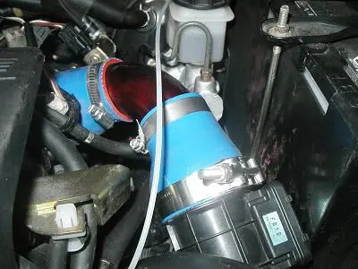

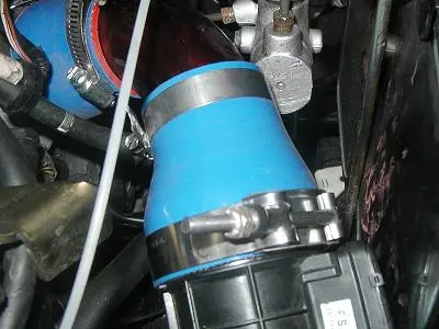

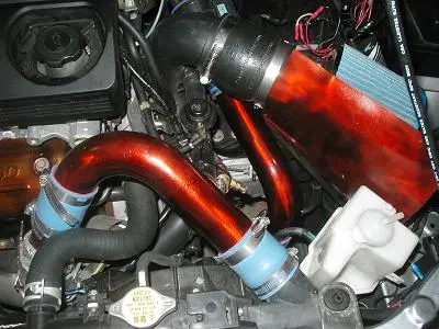

Ok here we go:
TB = 2.5 OD
My pipes = 2 ID
MAF = 2.75 OD
From the TB I used a 2.5 - 2 reducer
Then a 2 - 2.75 reducer
Then a 2.75 - 2 reducer so that I can get back on the pipe.

genius said:
Ok here we go:
TB = 2.5 OD
My pipes = 2 ID
MAF = 2.75 OD
Lookin good man, how's it feel? I have 2" pipes like you, so this is a very similar setup to what I would have to do.
