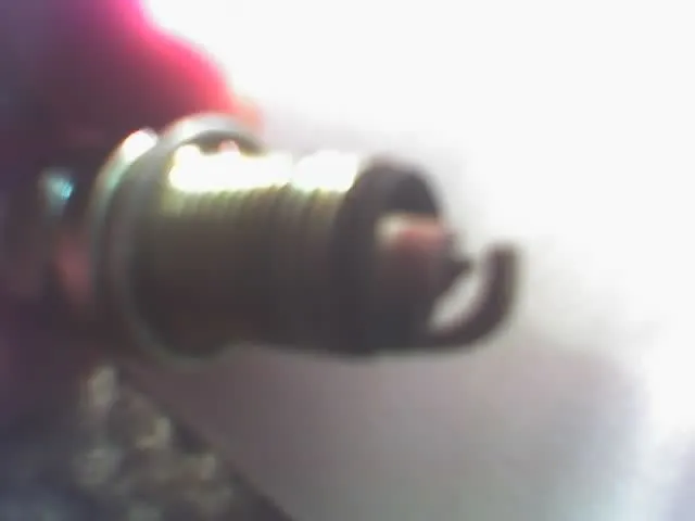

Well I have to admit you have me second guessing myself. Before I bought this MSP, I never gapped a plug before in my life. I used a cheap disc from autozone and to be honest the numbers are so close together that it could be off by .001 ~ .002.
Here is a clip of my idle. Notice the irregularity of it and the popping. Granted it is not perfect recording but hopefully it gets my point across. Also, it is more noticeable in person than in the recording. It is perfectly smooth with the stock plugs (PZFR6F). I don't remember what plugs I bought just that they were one step colder and not the IK-22's. The pics are of the stock spark plug after 2 weeks of the experimental MAF position. I suppose I shouldn't throw them back in even though I moved the MAF back huh?

you may have been useing the BKR7'S,I do not like those at all,bad plug for the car.
as far as gapping,buy the plugs I stated,they are not expensive,and are pregapped.

I am in a meeting right now, but while I am thinking about it... wicked, could you send me a link to purchase these plugs. Though I have Denso 22's, they might be getting old. The ceramic is very white and looks new, but the end of the plugs are black. If these plugs are cheap... I might just try them. Are they extended reach? Thanks.
The reason your plugs are black is probably because they are too cold for your conditions and not burning off the deposits. You need to have potential for heat, then the cold plugs will neutralize it and still burn off the trash.
I have the same problem with mine as well. I usually take them out and brush them with a slow dremel about every 3 thousand miles. Though while I was running lewan with the MAF in the otehr position, there were beautiful.
That sounds like they are normal... unless we don't mean the same end! If it's the bottom end (where the ground electrode meets the plug), then it's OK
