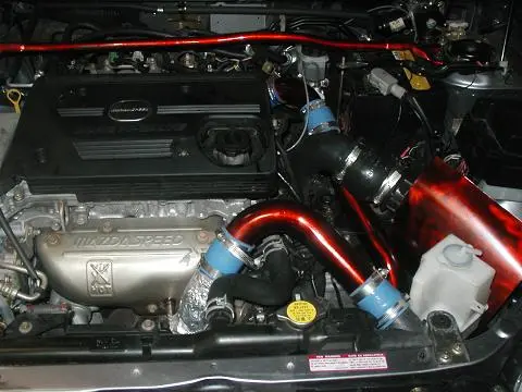

My new MAF setup + extra pictures

My pipes are very hot esp since I went to SS. I am pretty sure it is caused by the heat coming from the stock header onto the hot pipe before the IC but I am not too sure what to do about it. Considering header wrap. If someone on here has figured out a way to keep the heat off the upper IC pipe, I am all ears.
That being said, I think I am going to abandon moving the MAF until I figure out how to get the cold pipe cool enough to touch.

When it is hot here in Mississippi, the Turbo - IC pipe is hot enough to boil water. The IC to TB pipe is cooler but hot enough to not be able to lay my hand on it for any length of time. It is the whole pipe.
For a while I had wrapped the upper pipe with reflective heat tape and it did cool the other pipe down, but damn that is so UGLY! Keep in mind I did my own pipes. Perhaps my upper pipe is looping too close to the header shield... I dunno.
Here is the attachment of the pic of the car.

How big of a section is cut out of the pipe?
And should the IAT sensor go on the cold pipe? IC>TB pipe?
Or are you guys leaving it in the intake pipe? What size is the hole for the sensor?

Hmmm... I appologize, but I am not sure I understand your first question.
For me, placing the IAT sensor in the pressure side would mean that a lot more emphasis would be placed on sealing it in, otherwise under boost we would have a nasty leak. Any time I have ever messed with the piping I have always placed it right next to the intake. Sealing it is less of a priority here.
I don't remember how big the hole was. I made it big enough with a dremel tool to fit the factory grommet. Then I inserted the sensor into the grommet. The seal is tight enough for the intake side of the turbo.
But I am interested to see waht the others have done...

Regarding the size to cut-out. Hold the MAF to the IC->TB pipe and mark the pipe by putting the marker next to the MAF on eash side, this will add about 1/4" on each side, which will allow for vibrations and pipe fluctuations. I think I even cut a bit more... there is enough coupler space.
In regards to the IAT, put it at the intake, not on the pressure side. This does not do too much anyway. Right now mine is dangling by the filter. If it was not in the f'ing 30's here I would finish this install (spring came and we hit 80's.... then it jumps back down to 30... WTF). I am going to drill a hole for the IAT in the pipe by the filter connection. Measure the stock hole, and cut one the same size.
