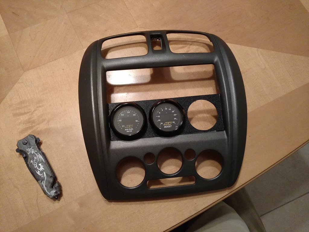

Few more updates. Finally finished the new gauge mounts! Just need to order the last gauge.

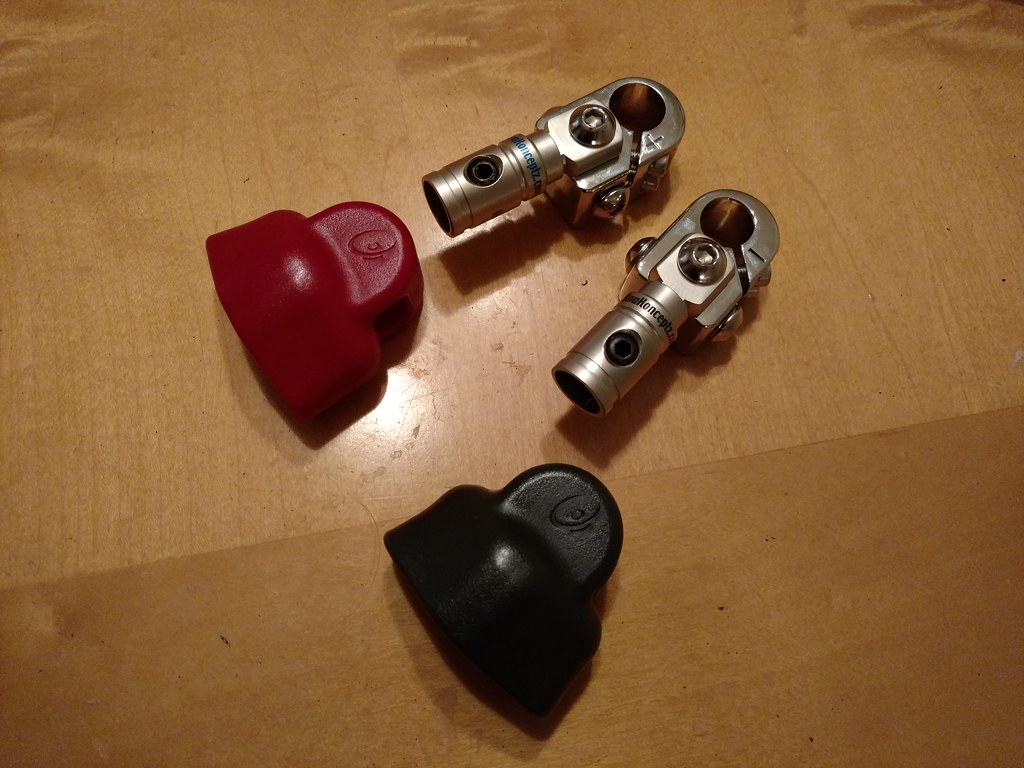

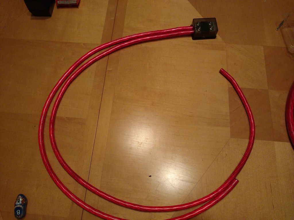

New Battery terminals along with 0 gauge power and ground wire, 4 gauge wire, and a fused distribution block for my battery relocation.

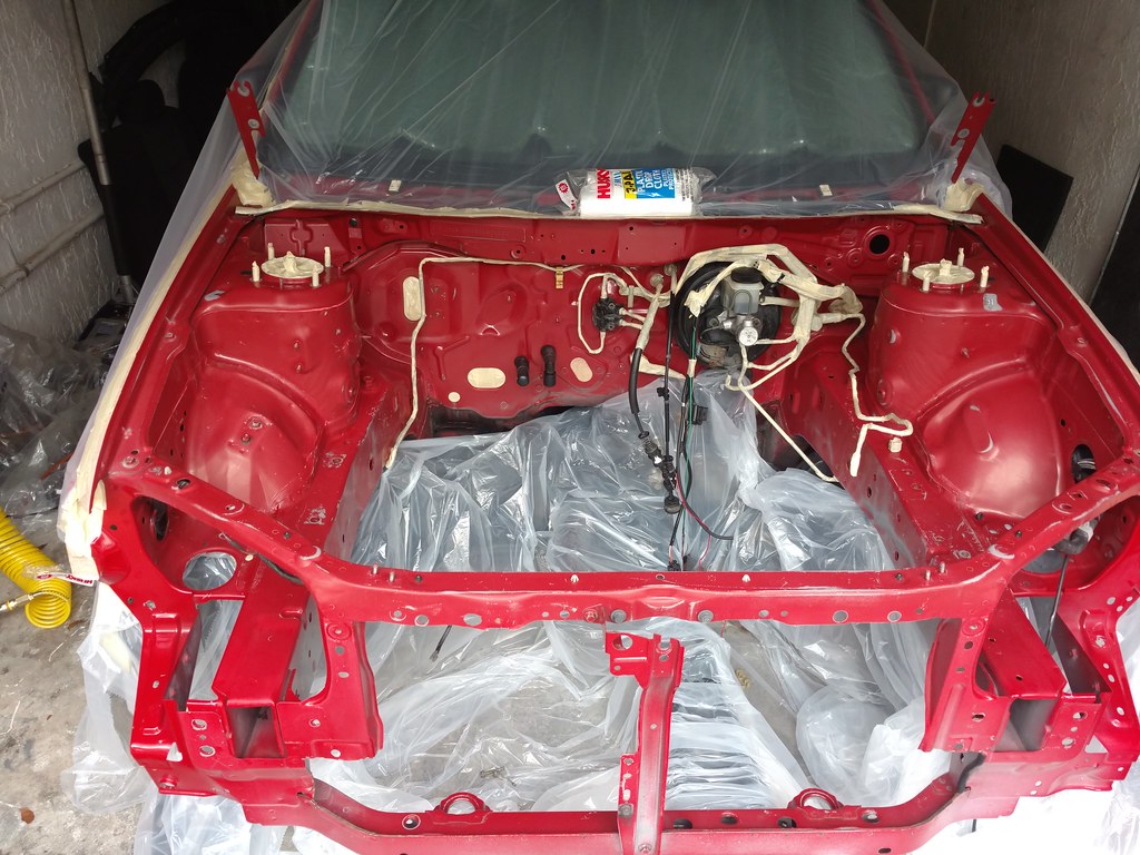

Went ahead and prepped the engine bay for paint. Degreased, sanded, degreased again, wax and grease remover, base coat, then clear. Love the way it came out! Not perfect but 10 times better than before.

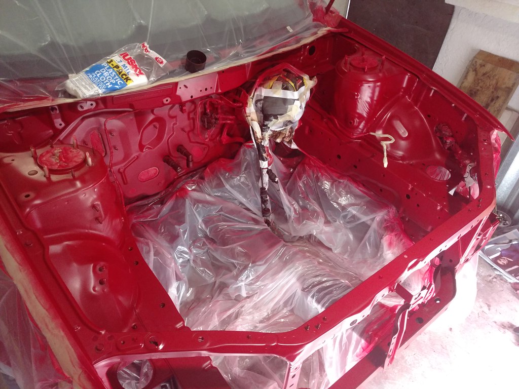

First coat
Second coat

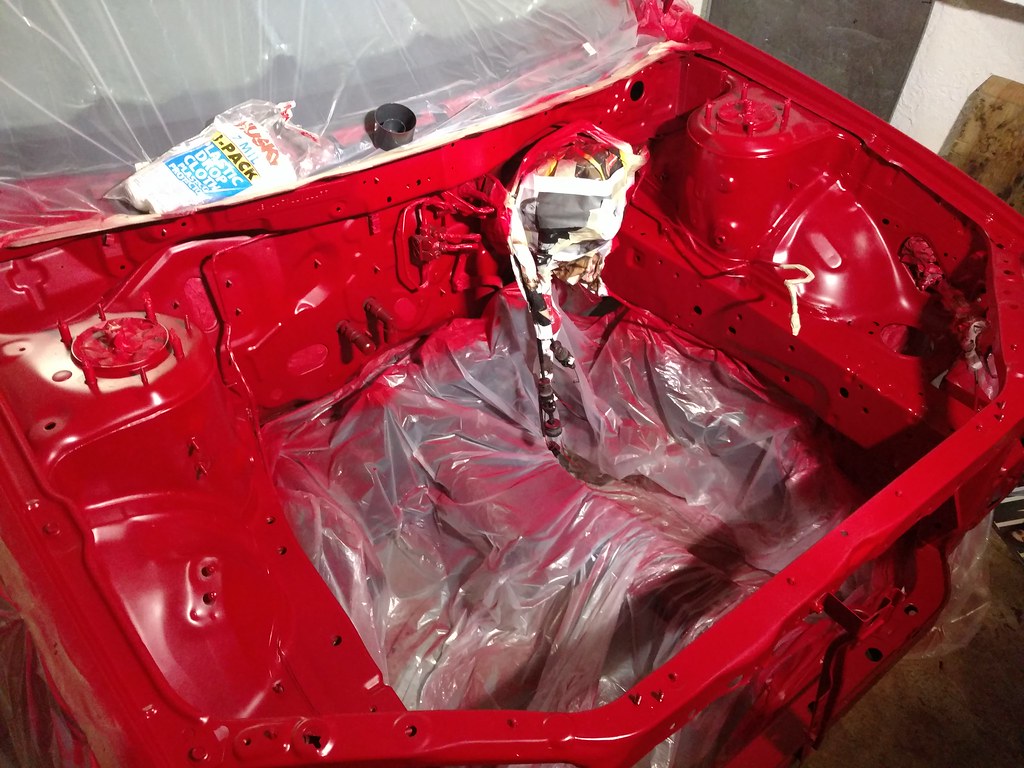

And final clear coat

So you clear coated the engine bay. No color.
Sent from my HTC 10 using Tapatalk
Really.?.? It matches the car body so perfectly. That's awesome!
yep lol. Bought 2 cans of color matched paint and did a pretty good job of masking the fenders off. Can barely notice where I masked off. Almost flows perfectly from inside the fender to the outside.
I don't think they can color match laser blue 🙁
It looks so good I'm definitely going to touch up my bay before I put it back together. Thanks for the link and pro tip
Thanks! haha sure thing man. Going to be dropping the engine back in next week. Almost ready to get this car back on the road!
