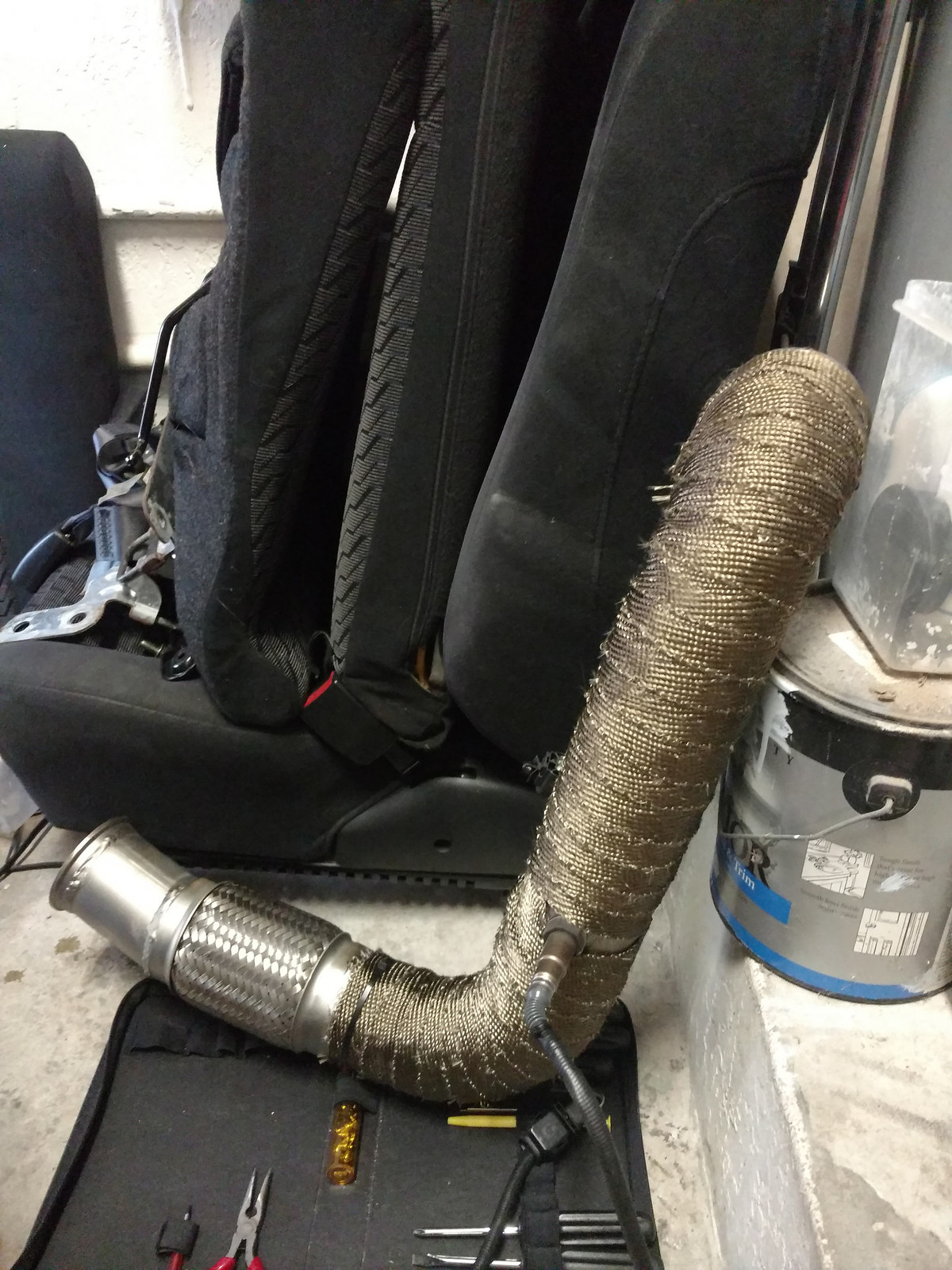

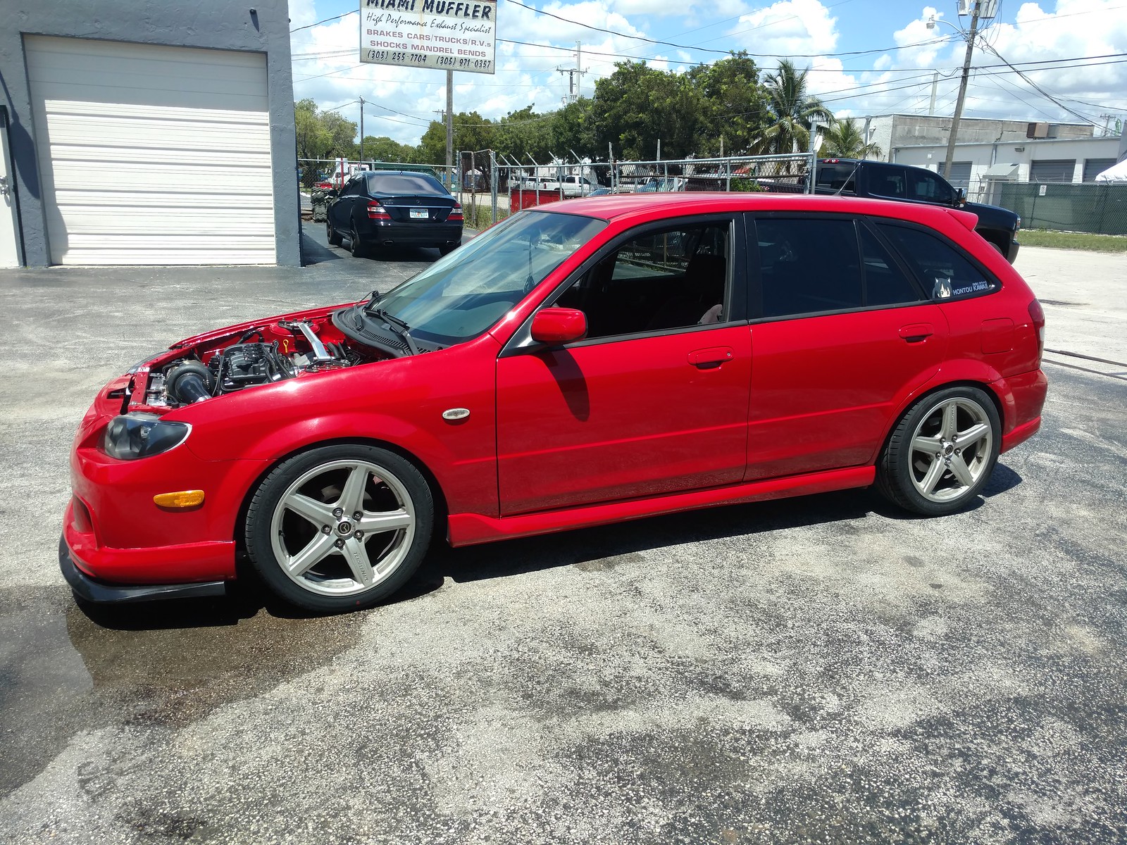

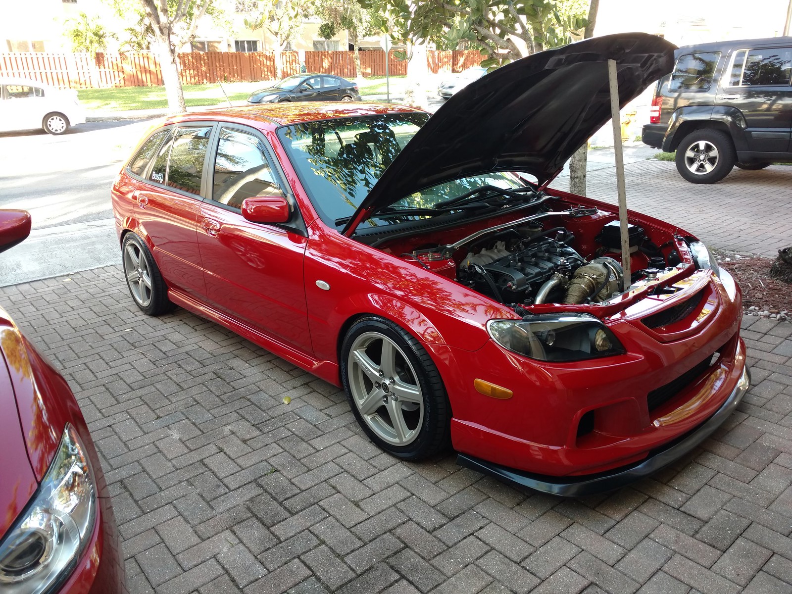

First time driving it and heading to the exhaust shop to get a downpipe and screamer pipe made. Of course, I had to roll with no hood to "check for leaks" *cough* *cough* Haha jk, didnt want to burn a hole in my carbon fiber hood.

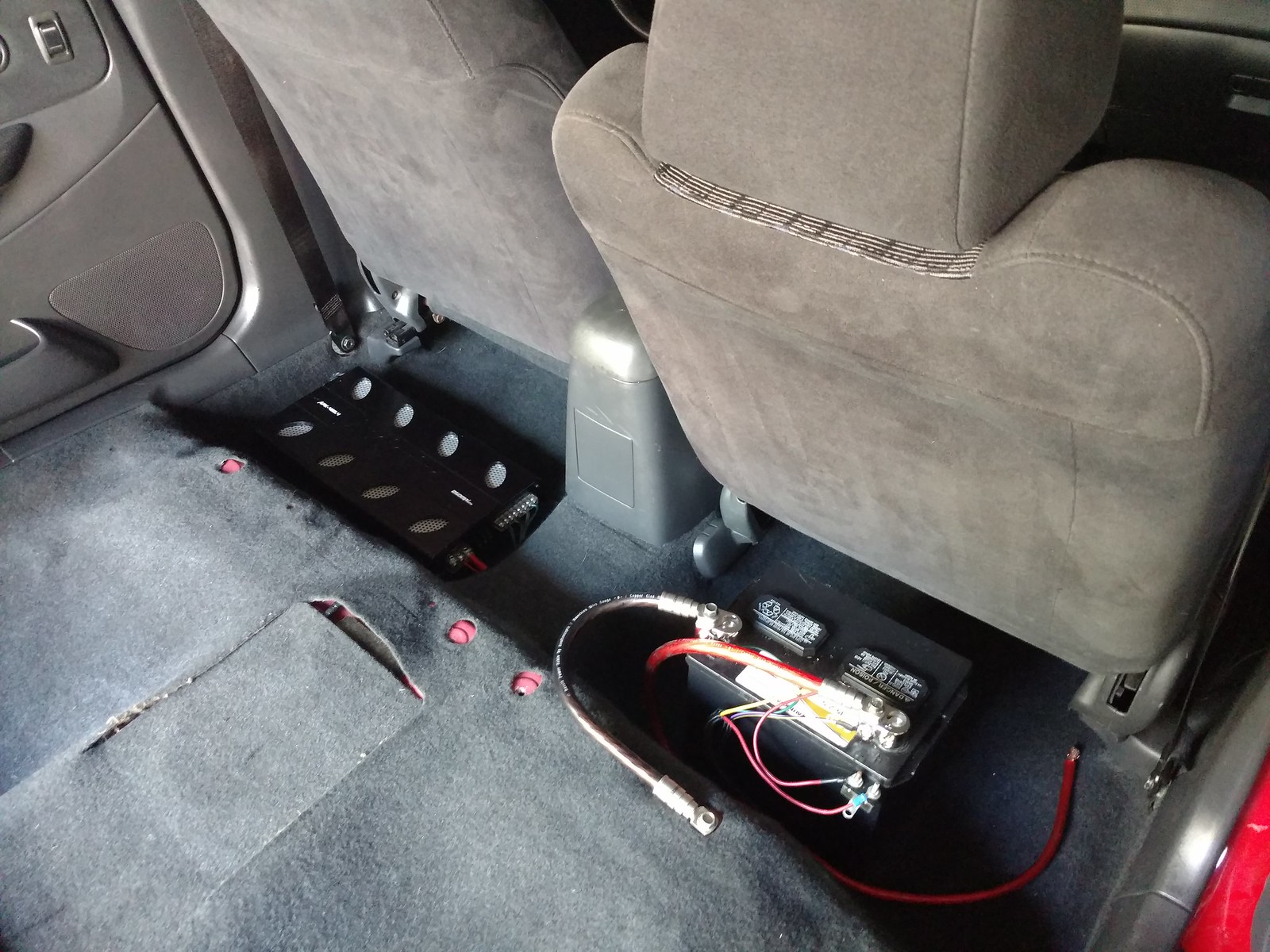

BUT...... I didnt know it was that simple of a fix. I ended up changing the whole engine harness because I had a bad ground and it was causing wires to burn. I though that this was the issue, but I was disappointed when the same thing happened after the harness change. While I was it, I went ahead and re-did the wires under the dash in the ECU area to clean it up.

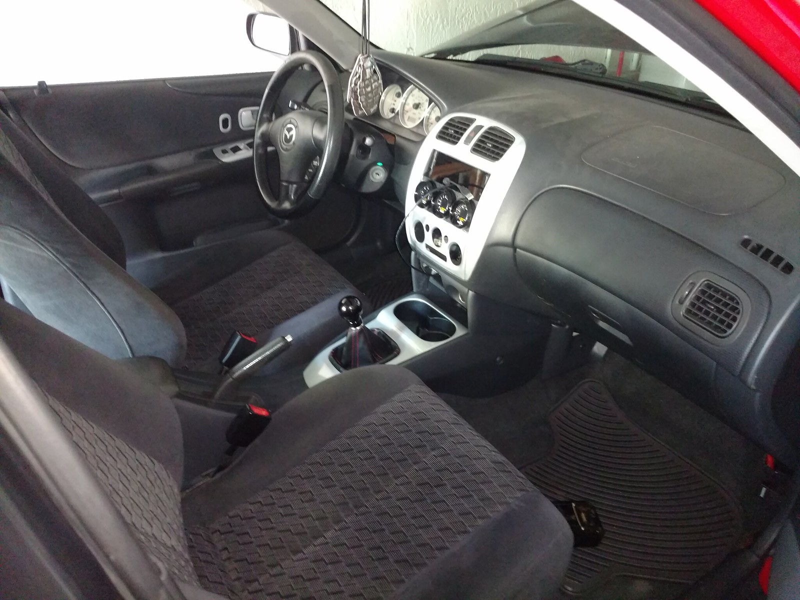

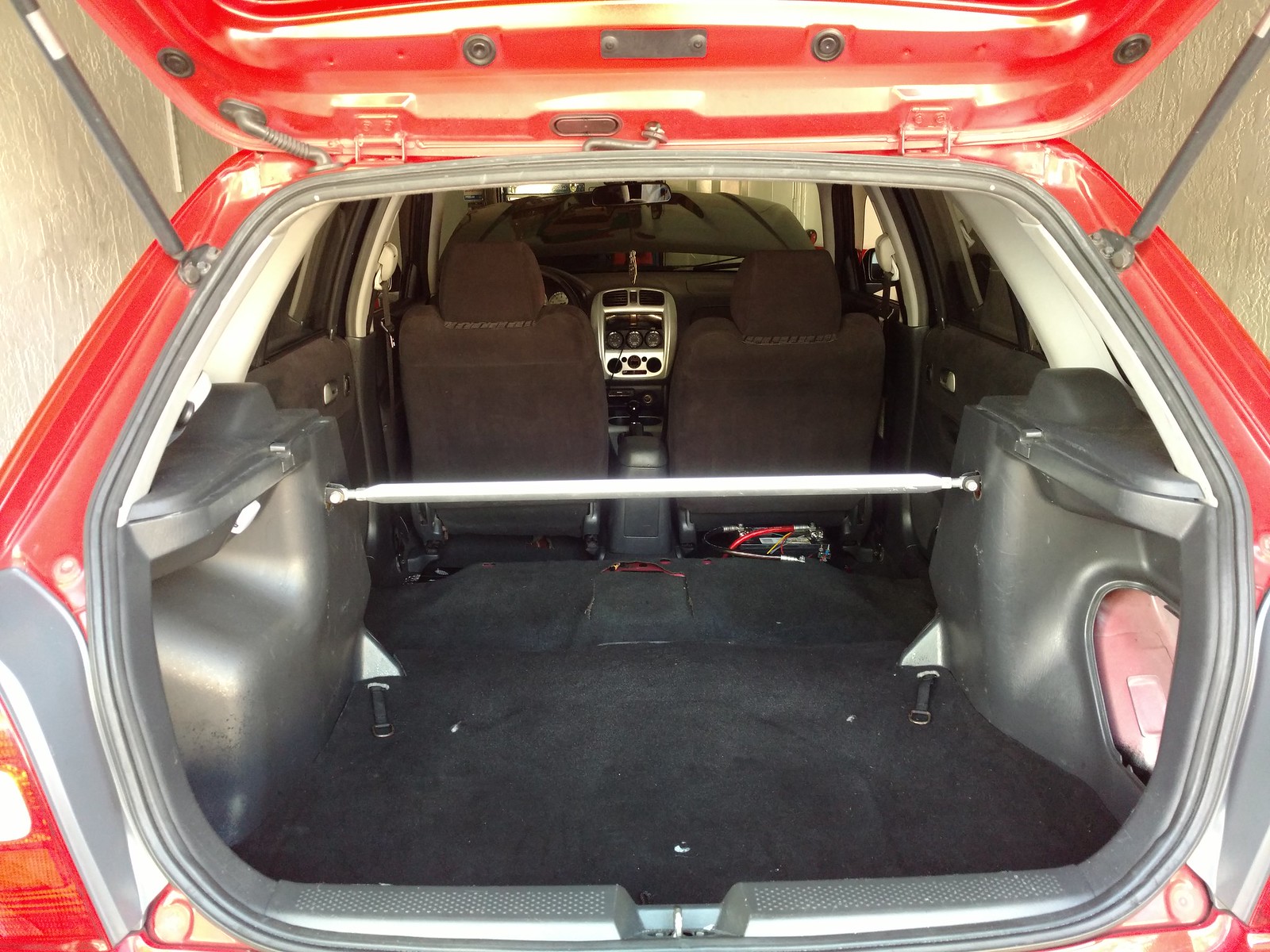

For the rest of the interior, well...... it what ever. Only the front seats and carpet are staying cause you know the saying "race car"

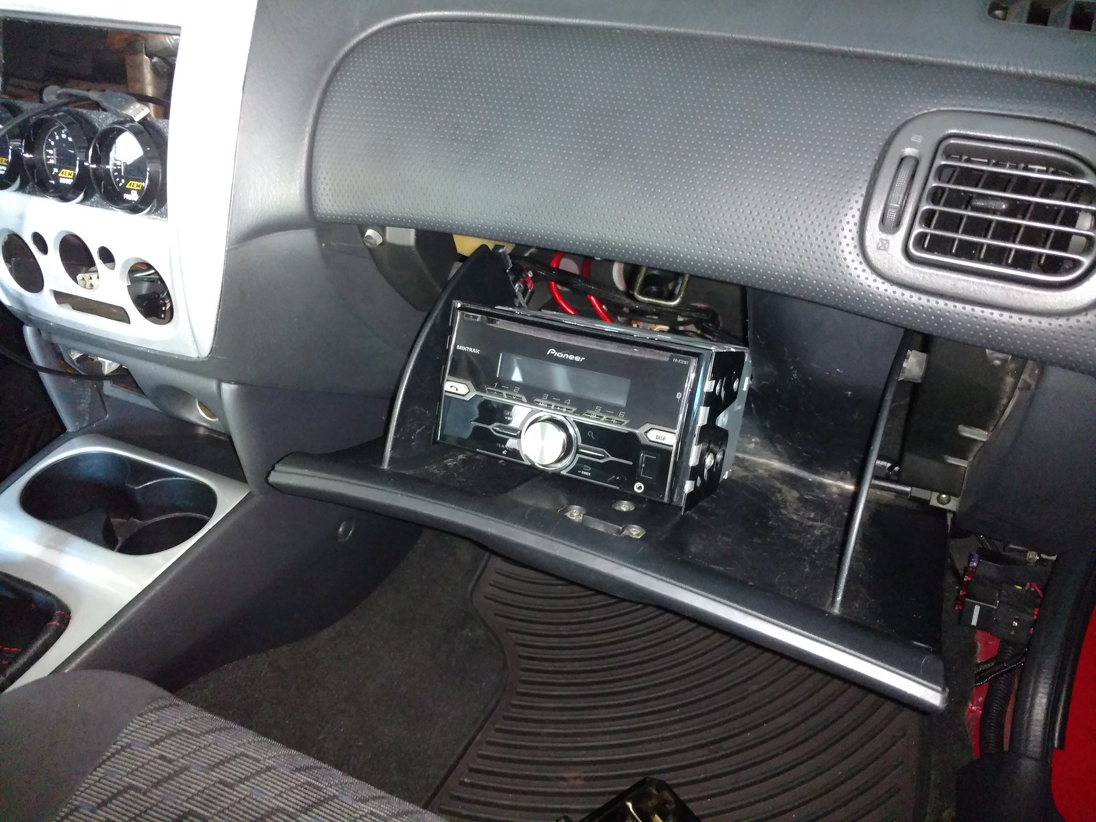

I BET YOU THOUGH I DIDNT HAVE A RADIO DIDNT YOU!!! Well this "race car" still has jams cause although the exhaust alone is music to my ears, I cant sing along with it so the radio needed to stay somehow and this is what I came up with temporarily.
