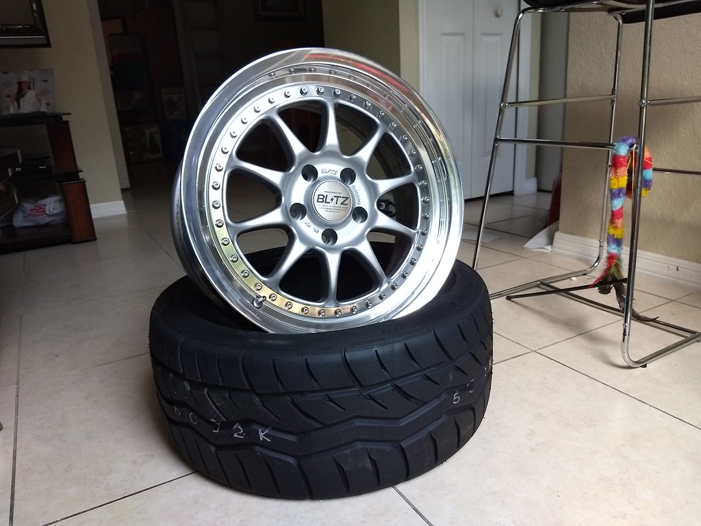

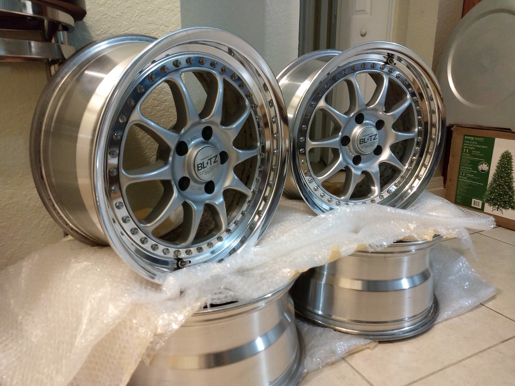

New wheels came in a while ago and man do I love them. They are in almost perfect condition! Just had to get a bent inner barrel fixed on 2 of the wheels. Other than that, they are flawless! They are Blitz Type 01 2 piece wheels. 17x9 +40 and 17x8 +38. Running them in a reversed staggered setup with the 9" wheel in the front and 8" wheel in the back. Front tires are Falken Azenis RT615k+ 255/40, rear tires are 235/40.
