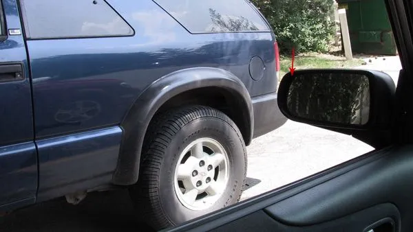

They stick on with the provided stickers already on the mirrors but I decided to remove the RH mirror and mount the Multivex directly onto the stock, plastic frame. I parked Four feet beside a Toyota Corolla with the B pillars in line and I could see the tail end of the car. Pretty cool. The camera was placed just inside from viewing the side of the my own car. The problem with mounting the Multivex directly onto the frame is that the mirror is now set too far inside and the mirror housing covers some of the view.

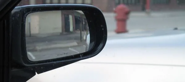

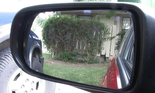

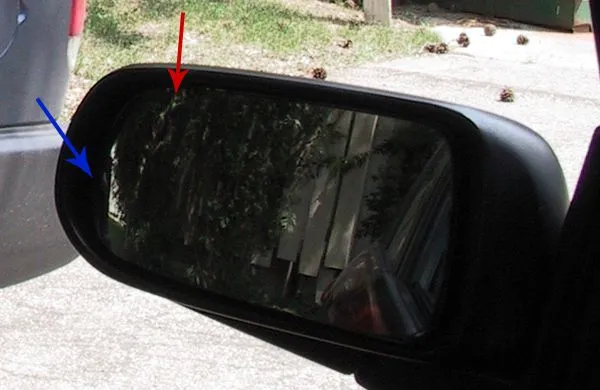

I placed the LH mirror on the stock one with better results. The Red arrows shows about where the matching points are. The Blue arrow shows about where the new mirror ends. The new mirror now shows the front end of the Chevy Blazer. The Blazer was Four and a half feet away with the rear end of my car in line with the Blazer's front. The following pics were taken from the same spot. Sorry about the poor pictures. Only the top quarter was cropped off and resized to save space. The last shot was taken with the camera closer to the mirror.

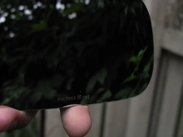

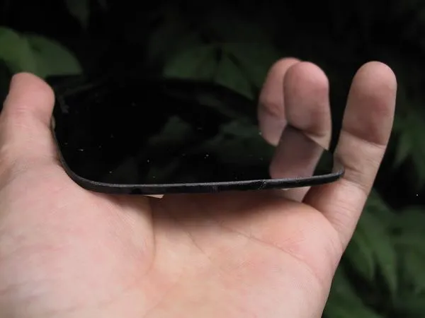

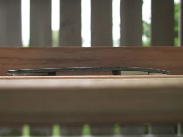

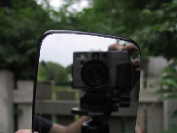

The quality is pretty good. The only thing that makes me think is that the coating is on the outside and not the back side like most typical mirrors. But it does have a one year warranty. The finish is very smooth with only a couple of really, really small pin holes. You won't even notice them unless you put them up to a light. The glass is Thick. Much thicker than stock. The side of one mirror was a little rough but I don't notice it when I'm driving around. The corner radii are also a larger than the stock. I don't think is was from my tracing for their molds. Could be a limitation in their developing process. You can see this in my original post as well but I don't think it's too bad. The view is also compressed vertically as well which is fine with me. Compression isn't as much as the stock RH mirror but it's also on the LH. The spherical ROC (Radius of Curvature) is 100' from the nearest part of the mirror (the flat part.) The mirrors are legal in every US state except in one for the LH and in another for both sides.
The amount of blind spot is greatly reduced and it would have been even better but I have the car design to blame for that. I always push the mirrors as far they can go but they are limited by the mirrors hitting the inside of the housing. I might later put some kind of spacer between the mirror and frame to put the mirror a little further out. Hollowed out piece of plexiglass, maybe?
