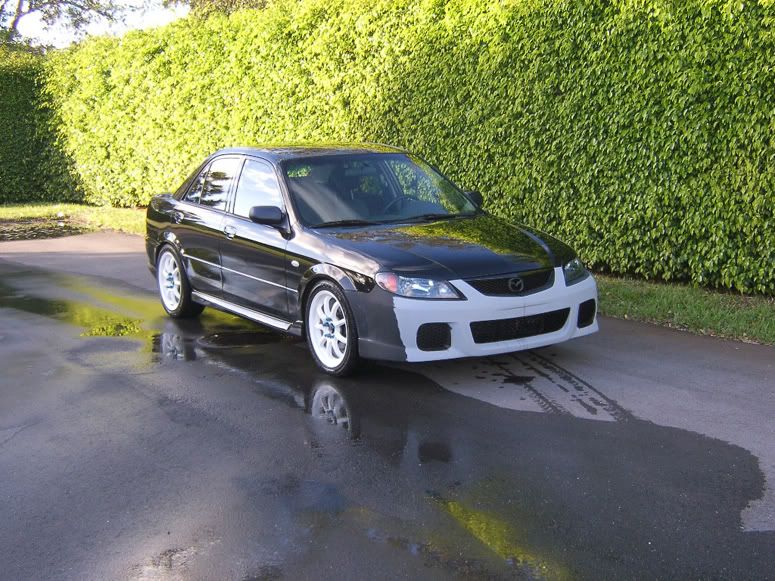

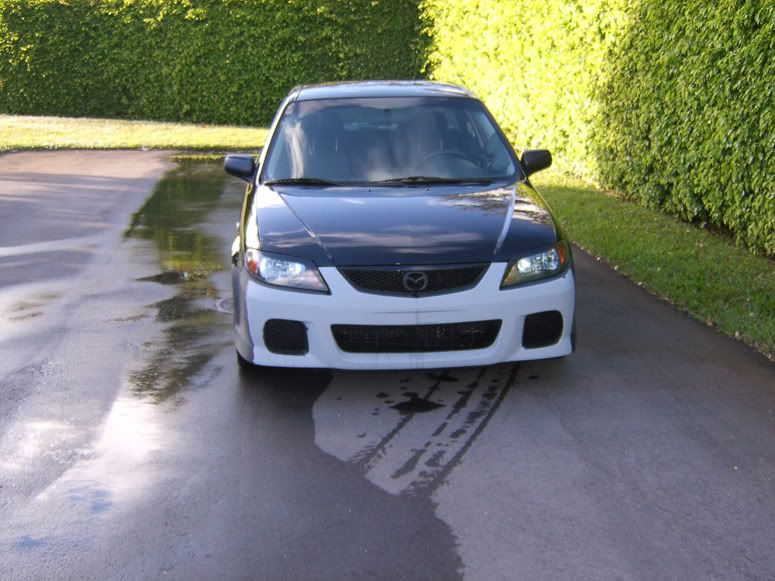

As you can see, I fixed up the bumper. After 4 plus years it was looking pretty rough. I really like the fog deletes, kinda makes the car look like a sleeper. I'm painting it tomorrow, so I probably be able to take some more pics Tuesday.
Whoo! Got to see the beast today! Looks and Sounds even more Badass! Those cams are crazy Sander. Car pulls nice even in its current state. Great to see it all coming together finally. My forearms are a little sore though! haha. Its been a long journey my friend.

Your car looks super sleeper without the lip. Now, mine looks fast, but is lacking the oomph
