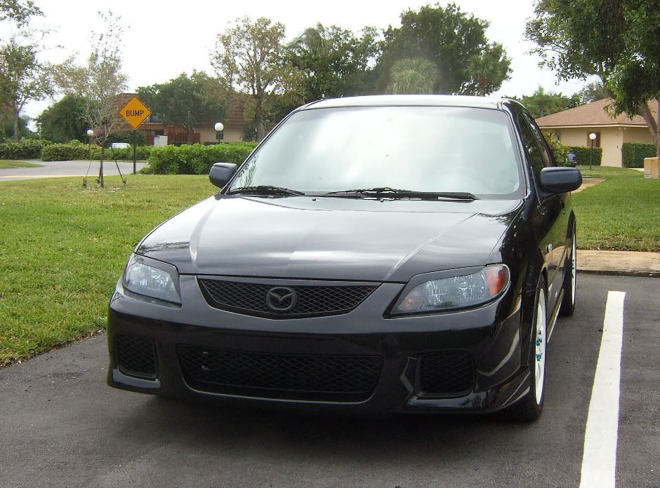

Your car looks super sleeper without the lip. Now, mine looks fast, but is lacking the oomph
hhaaha, thats funny! Tomorrow I'm putting the PS and AC back on...it was fun but I really miss power steering most of all.

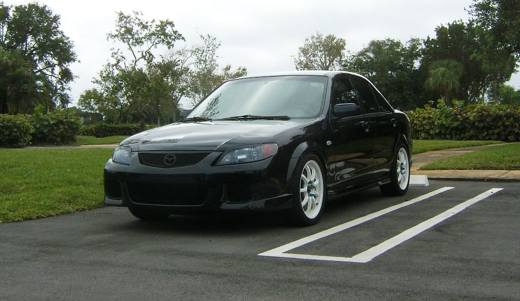

Fresh paint and fog deletes:) EnJoy
Anyone curiuos where his lip went, i got it. lol
I'm gonna steal the pic spotlight in your own thread! Muwwahaaahaa
The car is so black its hard to tell a lot of the detail. It's gonna be like a ghost on the highway too. Just two white wheels spinnin!
lipless? looks good mang!
I like the bump sign in the background, whats up with the sides of the bumper? they look like they are flared, you do a little some some?
looks good man!
thanks bro

Looks so good...I love the wht/blk contrast! My baby needs a makover badly!
thanks shane! I've never actually seen a pic of your P5 besides the on in your avatar. The engine bay looks real nice;)
yea fredo, thats true they will be spinnin =)
thanks! The bumper is totally unaltered, just fresh primer and paint. All thats left to be done it some wetsanding, buffing, and polishing.

I missed why you got rid of the MSP front lip? Were you just trying to go for a new look or something? The stock bumper with the fog deletes looks pretty sick but the lip gives the car a much more aggresive stance. Change is good though.
