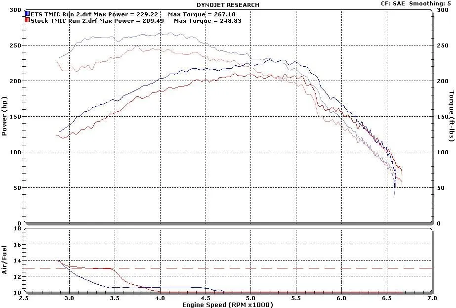

Look, I understand that you're skeptical and really can't do much about that. The bottom line though, these numbers are 100% valid. I did notice that the stock TMIC already started heatsoaking even before we did a pull, and I specifically made it a point to cool it off with a powerful fan blowing right infront of it after I finished swapping it back in before we started the runs. I understand that what I wrote above may sound like something a potential customer would want to hear, but it's the truth. All the facts are there to support the claimed HP/TQ gains. The IC is much larger, flows more and cools better.
Here are the dyno graphs. The first graph is a comparison between the FIRST pulls of each IC and the second graph is a comparison between the SECOND pulls of each IC. Please notice the "under the curve" gains not just the peak #s!! Those numbers are even higher than the peak, claimed numbers. Also notice how pig rich the stock map is! With a free flowing exhaust, an intake and an upgraded IC this engine has the potential to make over 50whp because naturally the a/f map should lean out as the flow increases, even at the stock boost level! As can be seen in these graphs, the A/F did lean out a little with our TMIC, which is a good thing.

Both runs were performed under the exact same conditions;
The ICs were cooled off with a fan for 10mins at the beginning of each session (not each individual run)
The pulls for each session were done back to back.
The fans were blowing from the start of the session to the end of the session.
Both runs were done in 4th Gear.
That's it.
for those that cannot get the link to work; see attached graph 20WHP and 20LB/FT of Torque Gained Over Stock!

Rawyzf said:
Those stock HP numbers look low? Only 209?
all wheel drive cars typically dyno lower in my experience to the wheels versus two wheel drive cars - the torque numbers are still up there, however
From the other dyno's I have seen, the torque numbers are pretty accurate. But the hp is usually in the 230 range.
So Mazda's claim of 274 hp (stock) is BS/marketing hype or just measured using a different method? All this is really depressing me if it's true, seeing these much lower HP numbers............
I have seen numerous dynos with stock numbers anywhere from 220-230whp....Never have I seen or heard of one that low....209whp....that seems pretty fkn low guys....So If I buy this Top Mount and I dont see 20whp gains than you will refund my money right? I will glady dyno my care with the before and after.
