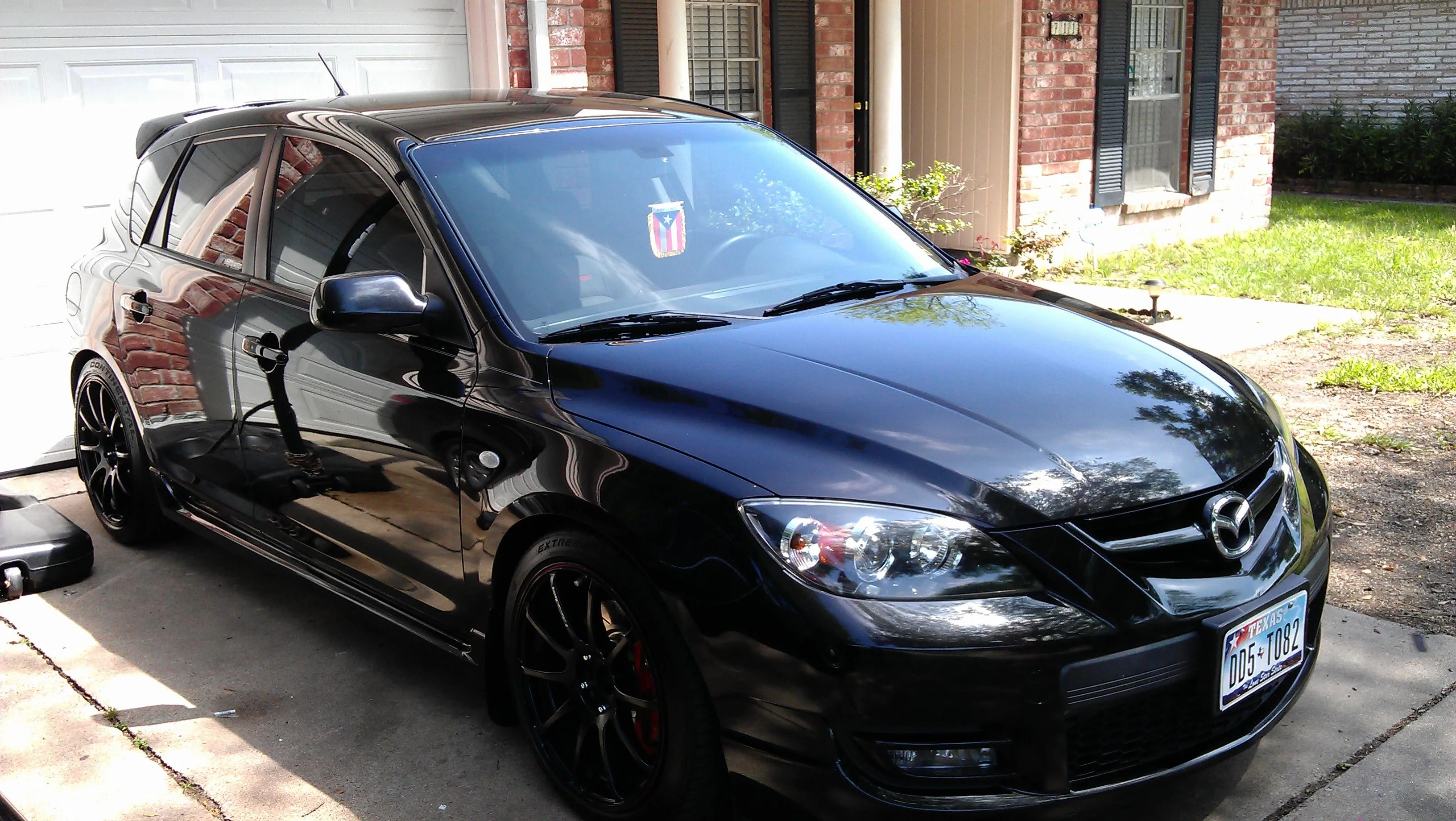

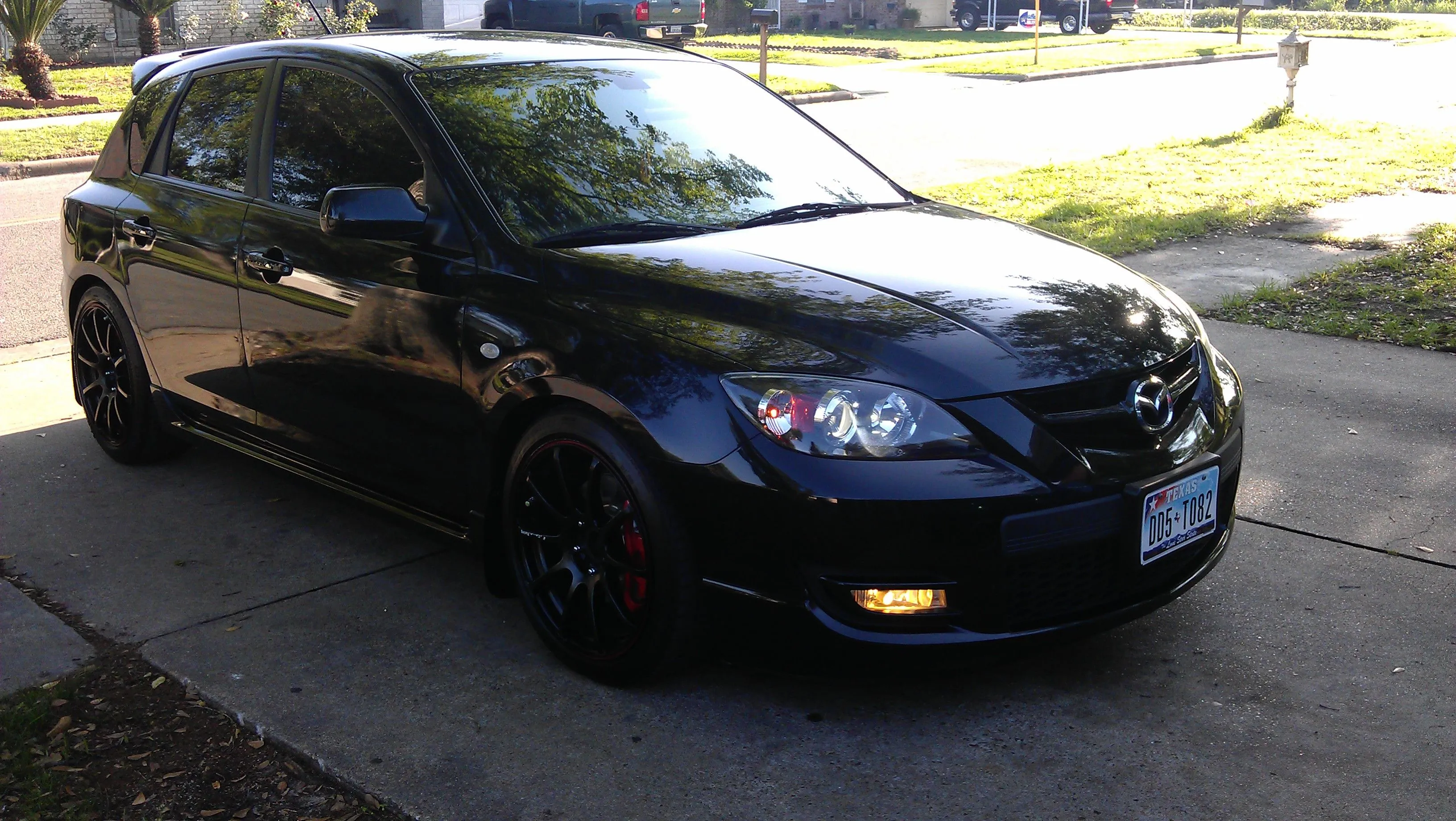

Rota G-Force in Hyperblack
18x8.5, +48, 73mm hub with hubcentric rings
Sumitomo HTR ZIII 225/45/18
Stock suspension setup
No modifications to the fenders
No clearance issues lock to lock. Rubs very slightly on huge bumps....o need for concern.
Sits flush with the fenders and gives the car an aggressive stance. Supremely happy!
Real nice.
I want your hood too btw (2thumbs)
thanks! still have some work to do to the hood. the grill it came with was slightly damaged so i need to repaint it and i still have work to do to the undertray. it fits but the hood closes tight. it's really minor but my friend and i are determined to get it right :)

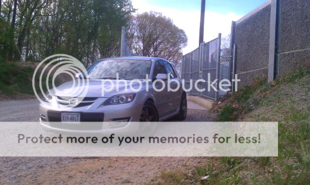

1) A Picture or a link must be posted (Please include 1-3 pics not a million pics)
2) Name of the Rim, (Brand, type, color) - Enkei PF01, Silver (obviously)
3) Rim Size (Height X Width + Offset) - 18x8 +40
4) Name of the tire (Brand, type) - Hankook Ventus V12
5) Tire size (Width/Profile/Rim) - 225/40/18
6) Spring/Coilover Set up (include height drop or stock, include any other specs) - Koni Yellows, stock springs, trimmed rear bump stops. H&R Springs to go on in the Spring.
7) Camber settings - Stock alignment.
8) Fenders (Rolled, trim, stock,ect) (include details, major rolling required?) - Stock. Will need to trim.

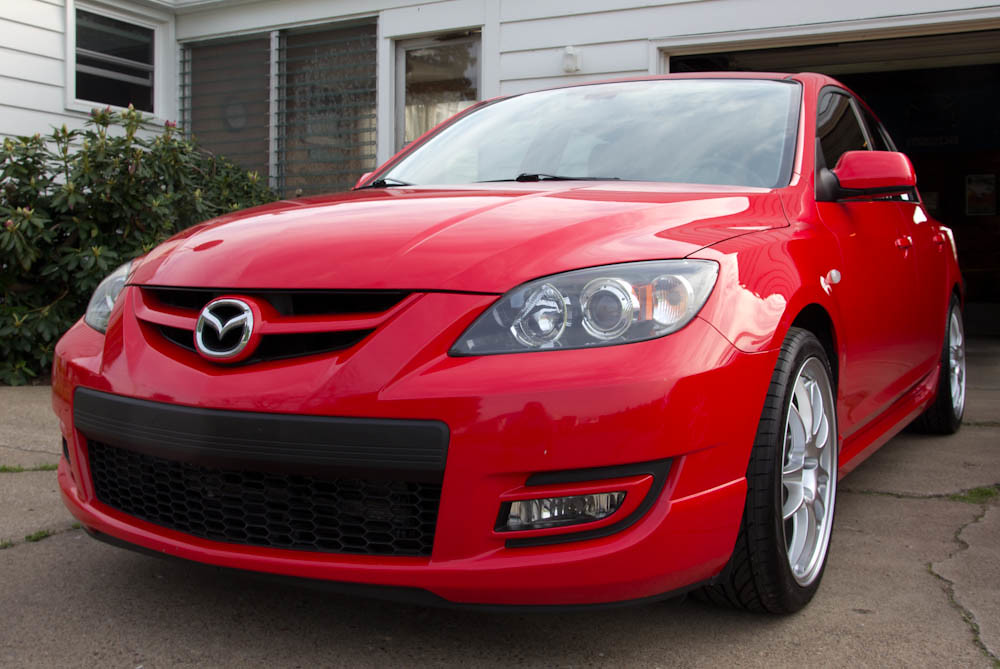

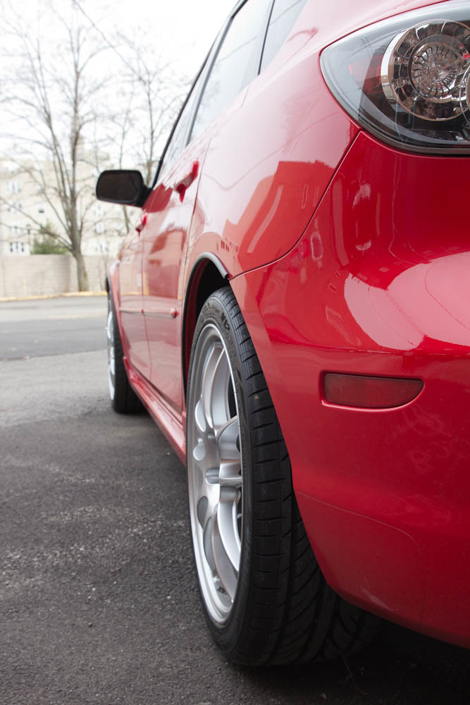

5-ZIGEN Fn01r-C 18x8.5 et48 w/ Nitto NT 555 extreme ZRs 245/40/18 on stock suspension for now
5-ZIGEN Fn01r-C, titanium
18x8.5 et48
245/40/18
Stock suspension, no fender work (rubs slightly over large dips. I will be rolling the rears.
Stock alignment.
No fender work (rubs slightly over large dips.) I will be rolling the rears.
