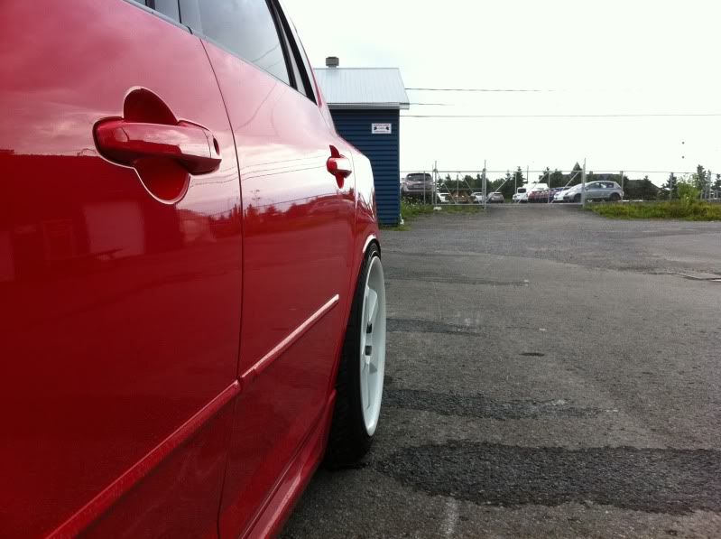

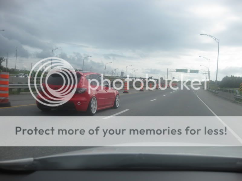

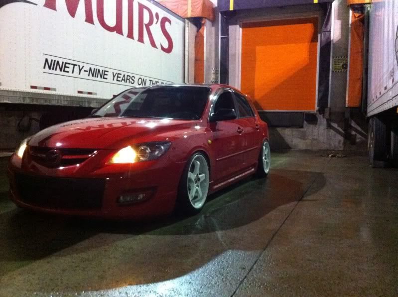

1) dai strike
2) 18x8.5 +33 front, 18x8.5+28 rear
3) khumo estca spt
4) 225/40/18 x4
5) STD suspention coilover
6) camber specs are oem in the back, (i dont have camber kit ). front i dont know..
7) front fenders are rolled and pulled a little., rear quarter are rolled, pulled , strech
8) scrape on big speed bump,
9) arp long stud on the rear, 13mm spacer on rear, 5mm on front , ( frond need another 5mm for a better fitment..)

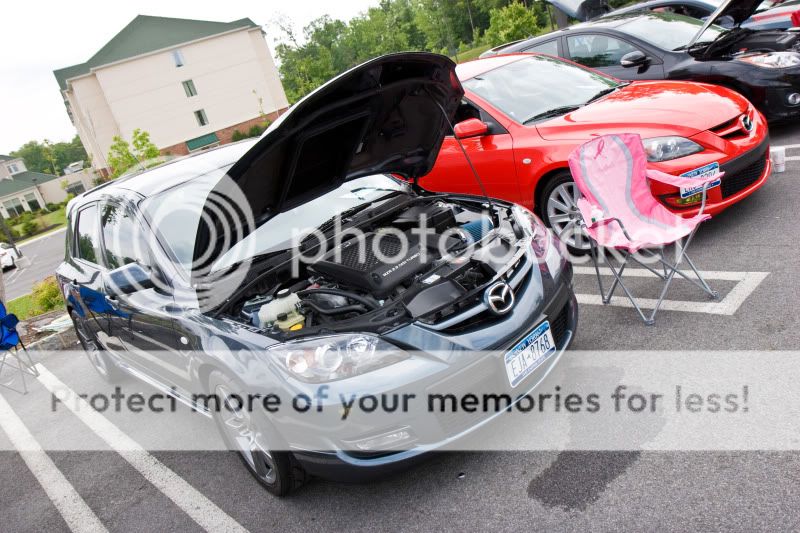

Almost flush
Dude... is that Fire Island? I've seen that car... the one meet I've ever been to.
Yea that's me. Wow that was a long time ago. I forgot what it used to look like haha I've done quite a bit since then.
Those pics were taken at tobay beach, just before an autox.
