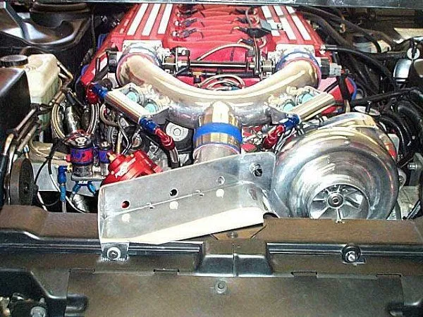

Pic of xtra injector on a big dog viper. Do you think with the kind of money spent on this setup, they would do something that doesn't work right?
P.S. Wicked, I am not trying to be a dick towards you, so don't take it the wrong way.(thumb) I am just trying to say it works well the way it is!
We have no proof that the MPI is actually doing only extra injector control or doing ignition, injection and extra injector control in that Viper.
BTW, the MPI works fine, its all about taste and how much you want to spend and your WHP goal.
Oh no, I wasn't saying that the MPI controlled anything in that pic. It was just to show that having xtra injectors setup like that works and many other cars use them that way.
