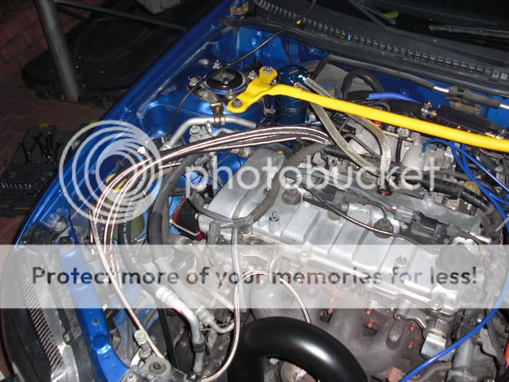

Heres another update on the car: I put the oil relocation kit on today its on the far left top of the engine bay. I got a oil check light after I put the kit on, but everything is running fine and the lines are getting a sufficient amount of oil psi. The engine bay is getting pretty messy and crammed so I'll be doing a clean up soon. Took the car on a run got up to 3.5psi lol, I'm loosing boost out of the bov flange because I'm having a problem getting the damn c-clamp to sit in the groove so I'm buying the tool for it tomorrow like i should have. I'll be fitting my bumper tomorrow and putting the oil cooler in!
oh whew!! i though you were using those plastic lines for the oil filter relocation lol the ss line looks similar
ive been wanting to do that too, but put it right where the windshield washer fluid is (took mine out)
i wonder if you could run the return line to an oil cooler then back to the back of the block....hmmm
Haha no there ss lines. That would be a good place to put the oil filter there. I don't know if it could reach...thats something to think about

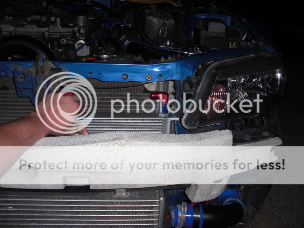

^^Nice man. I got the tool today, but still having problems getting my bumper on. The fogs are getting in the way
Yeah, I had that problem. I have the fog deletes, so I was able to cut away most of the back of the foglight housing. I hacked the inside of the bumper up pretty badly, and I had to mess around with the height of my IC and piping in order to get everything to jive. Have you made an progress with it?
Yeah the fog lights seem to be passing the piping, but I think the the IC is sticking out to much. I went for a couple of runs and my coolant was boiling, but I was driving pretty hard on it...still though should that even do that even after less then 30mins? Also the engine was not over heating

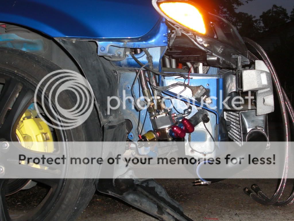

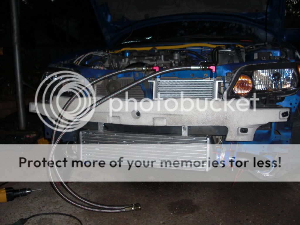

So did a few more things tonight finally able to because I don't have a garage and it kept raining. So I moved my oil relocation kit down where the washer fluid goes and re-wired my gauges before it got dark. I found out a way to move the ic back so I can fit my bumper back on so I'll be doing that tomorrow, also I'll be mounting the oil cooler too.
