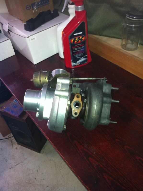

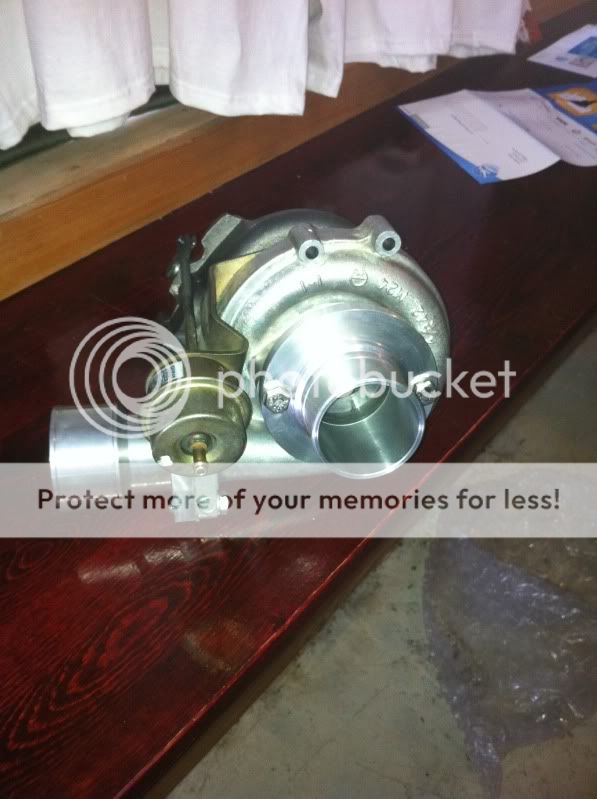

Bump for Gt2871r finally all done with custom flanges 600$ later...
What do you have into that turbo including the flanges? Kinetic in Vancouver sells brand new GT2871's for right around $1000. And youd have been able to spec your wheel trims and housing A/R's to suit your application.
ya its allready done though lol theres no way im getting another turbo at this point i think i spent about 800 total
I'm just saying for future reference you could have gotten a much better turbo brand new from a Garrett dealer for about what you paid for all that fucken around.
Ya it was my bad lol. First time getting a new turbo so i dident really know what i was in for as far as all the modifications that needed to be done. I would have just bought the 28rs from the start if i knew.

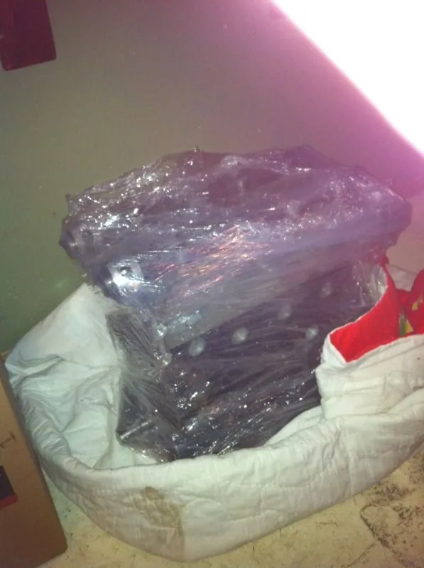

finished motor pauter rods,weisco pistons 9:1
