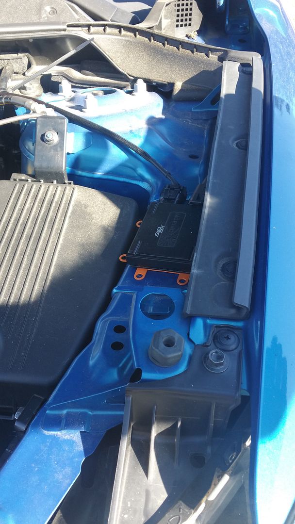

I just installed mine today, the longest part of the whole operation was trying to find mounting points for everything. Mine didn't come with the same mounting hardware as the pics I saw in this thread. So I did what I could with 3M double side tape. I'll tryi to find a more permanent solution for the relays later. The only issue I can see is the Relay to the Factory plug, it keeps wanting to come loose, and yes it clicked. I guess I'll get some electrical tape and tape it up. What do you guys thing?
[URL=http://s1055.photobucket.com/user/armymandres/media/20160305_151304_zpsxzesau1b.jpg.html]
[IMG][URL=http://s1055.photobucket.com/user/armymandres/media/20160305_151313_zpshbuvpaog.jpg.html][IMG]http://i1055.photobucket.com/albums/s506/armymandres/20160305_151313_zpshbuvpaog.jpg[/URL][/IMG]
The halogens:
The HIDs
