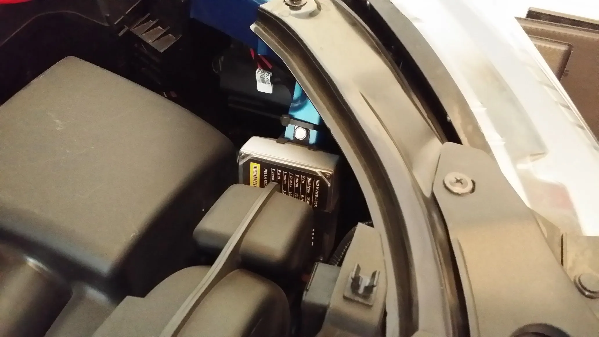

Hmm.. Tried to reach for the headlight bulbs and it was okay, not too bad. Right now I'm trying to figure out where to mount the ballast. Bought a Fast Bright F3 ballast + CNLight H11 bulbs, no relay.
The ballast isn't double sided sticky mount type... It's the bracket/screw ones, so not sure where to mount it.

vroom- Thanks for your help and explanation on your setup. I just installed my Morimoto HID kit today. Took about 1.5 hrs because my dad and I debated where the HD relays should go. But anyways, the bulb size for this type is H11B and yes you are all correct, no canbus required. Tho, I think it would be better because of the excess harness involved. Very tricky on where to tuck and hide those wires. Other than that the install was good. I'll post pictures soon! Thanks CX-5 community for the help!!!
