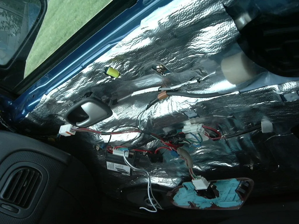

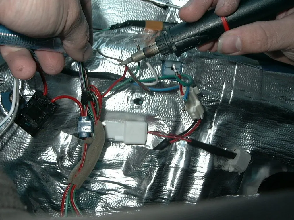

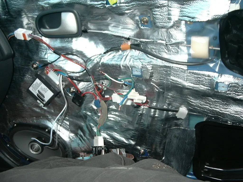

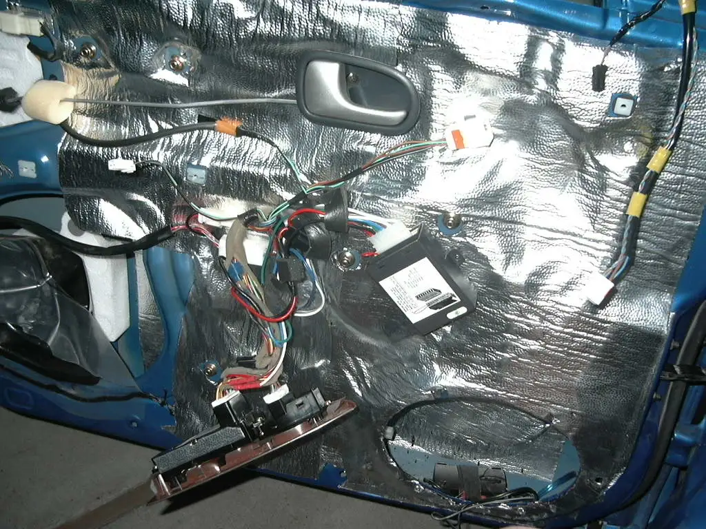

Heyman, to answer you on why I said YOu don't need 2 in the driver'sdoor is because you can place them in each individua door instead. I've decided that due to space restraints, this is the best option, so I've been switching around my setup.
Here's some pics of my revised driver's side switch setup. Also installing one on my pass side, as well as the splicing I did. My power I took off of the red/white wire tat goes to the switch harness (that's the cheezy t-tap because I'm lazy and it's a tight fit inthere) Ground was made with a crimploop, and paint sanded away from one of the 3 botls surrounding the circular cutout (I believe these hold the window motor inplace) I interrupted on the motor side of the passenger switch. This allows for the passanger to bave one-touch control as well as the driver, but again more than anything else, tucked the module out of the way. My previous location of both modules inside of the door panel was sufficent, but I just think this is much cleaner. The wires could be interrupted at a different spot (such as where the input comes from the other side before the pass side switch) to make it only work for the driver, but where I spliced just gets you more outta it IMHO. Plus my gf gets a kick outta the deal and wanted it to work on her side as well.
As far as sunroof control, got me there... The switch itself works off of grounding. But it has it's own built in limiter. perhaps you can put some form of timer intot he system. Zap may be more qualifed on that one than I am I'll get pics of my relay-setup that I used for my alarm integration soon enough. but one-touch sunroof is a nice idea. especially opening.
