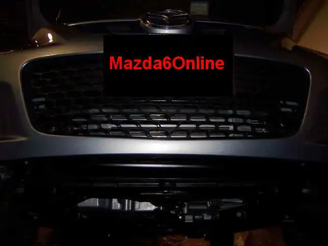

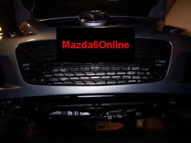

Hmmm it looks really nice, but what good does it do if half the core is obstructed by the bumper support?
Real Street Performance +1 That guy is the sh&#.
Also the core is vary thick and is bar and plate. The bumper is there and that is it we can do nothing about it. Plus Don't Shi& on theis thread Please.
Here you go Ryan :)

:) I live to please
Sorry for the angle i don't have any straight ons today... you will get videos and pictures on the dyno sat (pm me if you want to come :))
