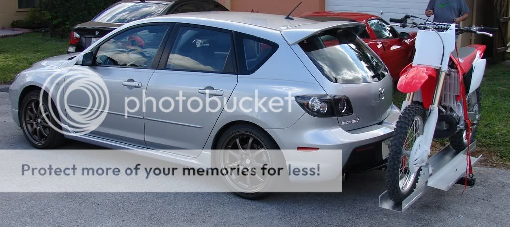

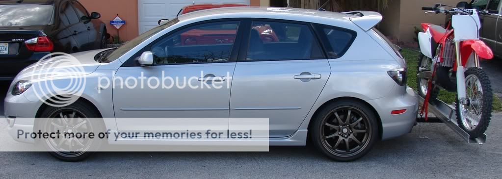

I just got all my equipment ready to haul my dirt bike around with me. I ended up going with a class III hitch that is well hidden done by a local custom trailer shop. the bike ramp that attaches to the hitch is made of strong aluminum. The back end is dropped significanly, oh well!
I think my hitch-mount bike carrier weighs more than yours with your bike on it. I think I'll do a small trailer.
BTW, what rims are those?
Man, doing this kind of s*** is just plain dumb. This vehicle isn't rated to tow anything, and the load limits on the vehicle are somewhere around 850 pounds. Not only does this assume that the total load will ONLY be suspended BETWEEN BOTH AXLES, but it assumes that the total load will be SPLIT between two axles. You're going to overload the back axle of your vehicle doing stuff like this, and if you ever haul 4 people plus bike, you're going to be pushing the limits of your tire's load limits.

This is not towing, this is sticking 200+ pounds of motorcycle 24" behind the car. This is all tongue weight and is going to bend or break fasteners or welds and dump a nice bike on a freeway somewhere. Think of it as over 400 foot pounds of torque on the hitch mount BEFORE a bump is encountered.
-enganear
-enganear
(iagree)
A class I hitch is only rated for 200lbs tongue weight and I have a feeling a class III hitch on this car is going to exceed the limits of the (sheet) metal it's mounted to. I think a small t-bar trailer would be a smarter way to go for carrying a motorcycle.
