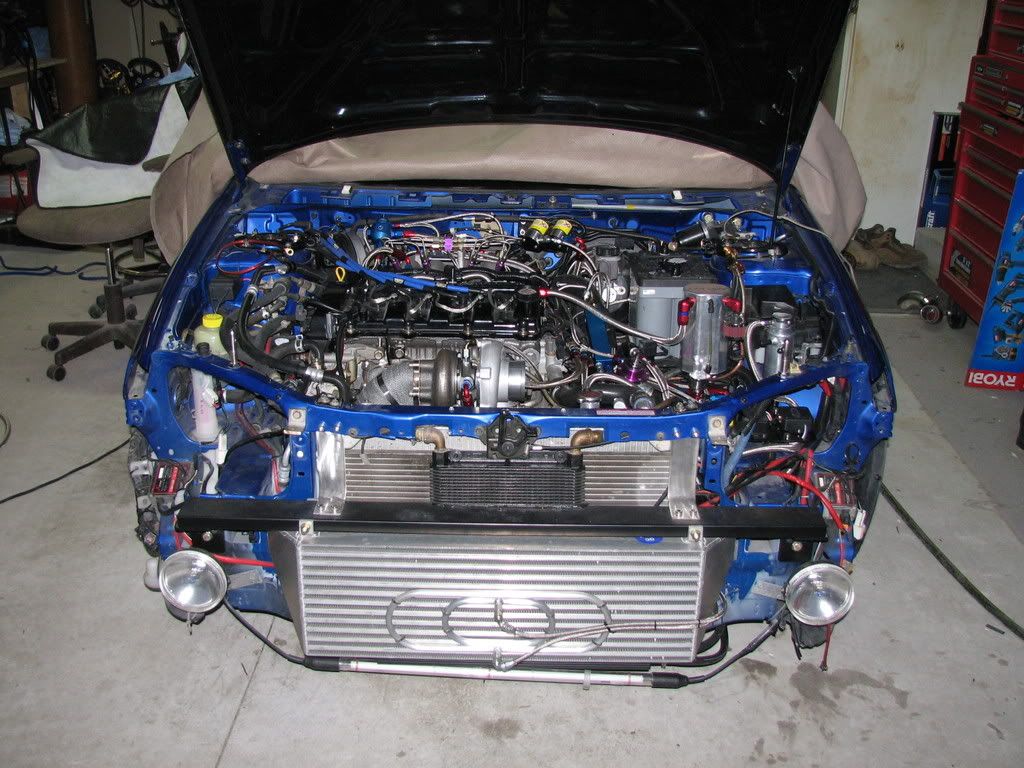

If you havn't upgrade your oil cooler do that....
I used a B&M kit that I got from Summitracing.com
I find that for stuff that coolers and pumps, Summit has EVERYTHING. Just surf their website and you will be amazed. They have MANY different options for oil coolers.
I also like DEI core to. They have a wide range of sizes to fit in any space. I used one for my tranny cooler....
Oil cooler above FMIC. (black) It gets it air from the upper air dam....
And if you look carefully the tranny cooler is under the FMIC. It gets its air from a scoop installed on my Splitter. Oil is pump via a Tilton pump mounted on the frame beside the driverside wheelwell.
