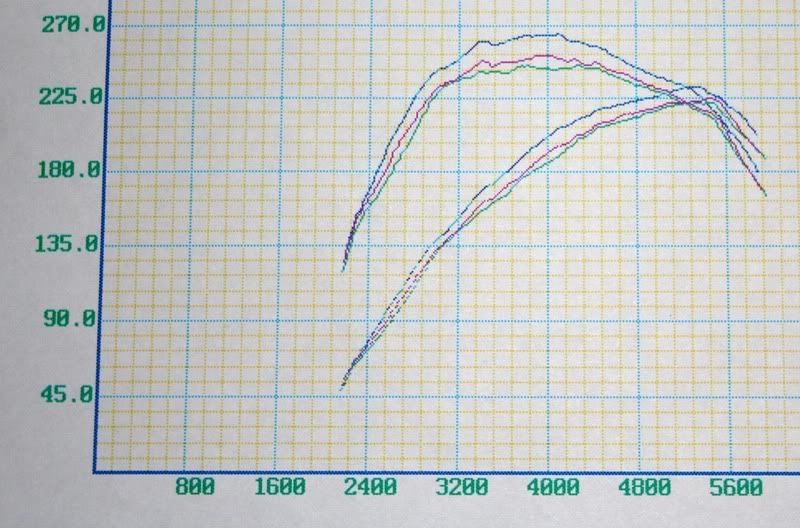

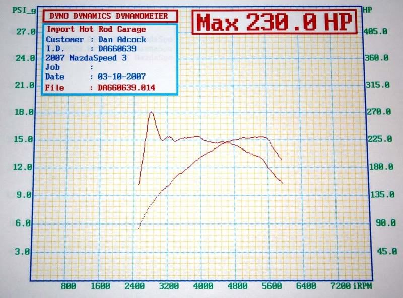

Well, finally got on the dyno, it was a lot of fun. Final results were 230WHP and 270TQ. I knew before hand the nose dive after 5600 rpms and that this thing runs pig rich. Seeing the graphs first hand makes it very apparent that with a good tune this thing will make a lots more power just by leaning it out. Check out the heat soak issue after my initial first run (top lines are HP, lower lines are TQ), definitely need a larger TMIC or FMIT setup in the future. The guys at Hot Rod Imports really spent time explaining everything they were doing and I learned a lot. I hope to be back soon.
This was done on a Dyno Dynamics machine. The Dyno Dynamics dyno reads lower than the Mustang dyno, it reads WAY lower than a Dyno Jet. It also reads WAY lower than a Dynapack. The important factor is that this dyno is very accurate. Going with the other dyno's would have printed much higher readings but I would rather have accuracy than bragging rights.

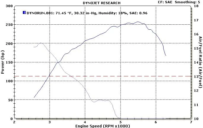

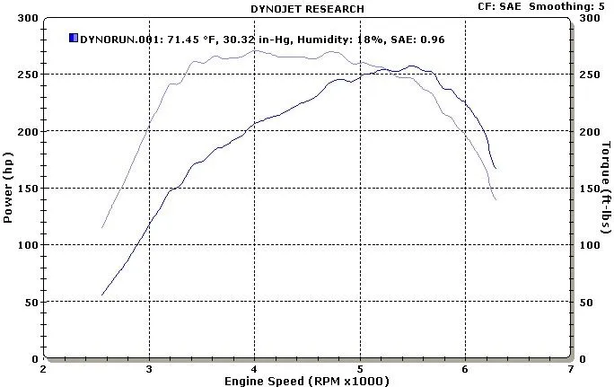

I finally have all my data.... Let me try to post these... If you want the raw files (I have three runs) or other forms of data, just let me know!

Are these stock or with an MS CAI that is in your sig?
Can you post before charts too and label them or specify in the thread accordingly? Thanks again! Great data!
Maestro, these are with the MS CAI installed.
Speedy, unfortunately, as I mentioned in a previous thread, I did not have time to get my car dyno'ed when it was still stock. I realize I cannot give percentage gains over my original configuration (stock), but at least I have some final numbers to provide. I have all the humidity, temperature, etc., data, so we can certainly get an idea of the environmentals when comparing to another stock pull. I have the software and can plot just about anything you guys would like. Just let me know....like the A/F mix. Notice it goes below 10 (off the graph) I have no idea how low it actually went... interesting.
You were also using SAE correction so those environmental stats shouldn't matter. That thing is still rediculously rich. I was just at the dyno yesterday helping a friend with a supercharged 05 V6 stang and his A/f was almost a perfect 11.5 (still pretty rich but generally regarded as safe) across the entire RPM range. These cars really need a better tune.
