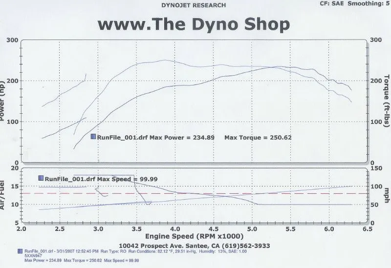

camrycev6 said:
Maestro, these are with the MS CAI installed.
Speedy, unfortunately, as I mentioned in a previous thread, I did not have time to get my car dyno'ed when it was still stock. I realize I cannot give percentage gains over my original configuration (stock), but at least I have some final numbers to provide. I have all the humidity, temperature, etc., data, so we can certainly get an idea of the environmentals when comparing to another stock pull. I have the software and can plot just about anything you guys would like. Just let me know....like the A/F mix. Notice it goes below 10 (off the graph) I have no idea how low it actually went... interesting.
That's what I thought, just needed to be sure. Thanks
The A/F ratio is all over the place. I can't believe how lean it is in the lower rpms and how rich it is up high. Thanks for the graphs.

It always is. Doesn't matter which car you use, if your using a tail pipe sniffer it's going to look similar at lower RPM. Putting the O2 Sensor in the O2 bung up front will read a slightly richer A/F down in the lower RPM range but across the rest of the tune it's it's going to look identical. Conclusion there - not worth the trouble to place it in the bung on most cars.

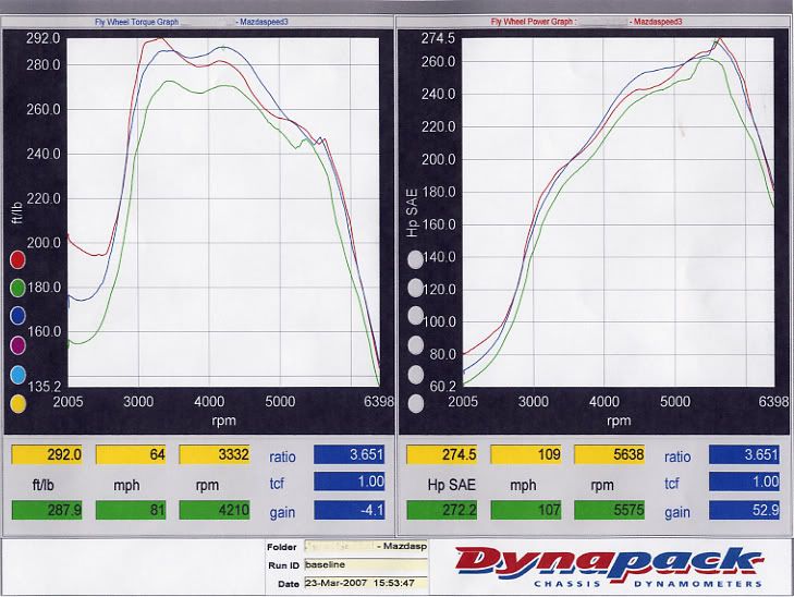

jflash,
I am confused by your signature file. Are you saying your stock dyno numbers are 272hp and 287tq? That is more at the wheels than the car does stock at the crank. What gives?

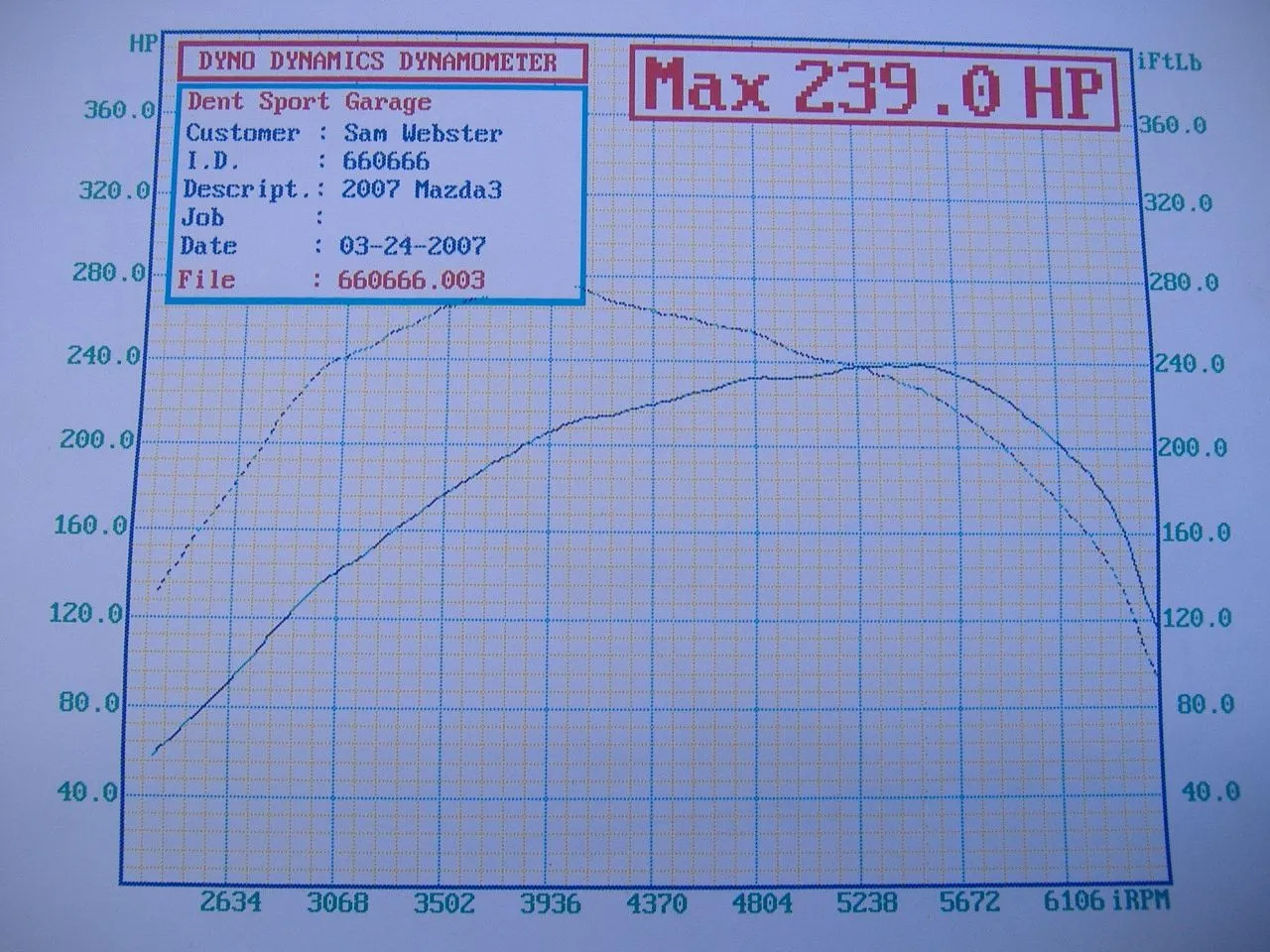

Here are my dyno results. Also on a Dyno Dynamics machine. I hope the size is not too large for this post. Note only mod is MS3 CAI.
Interpretation of the Dyno? It can't be 239.0 max HP as I'm seeing another line going up to ~280HP or is that the TQ?
camrycev6 said:
jflash,
they take off the front wheels and attach the dyno to the hubs. i know the dyno sheet says flywheel but it is at the hubs. i thought it was adding hp to guess the flywheel hp but the dyno guy said its not.
i know to most these numbers seem high or fudged. the dyno guys were floored by the results.
in a comparison, when i did my stock dyno they were finishing up a WRX. it had upgraded turbo,injectors,ecu tuning,full tbe and intake. it put down 271 on the same dyno.

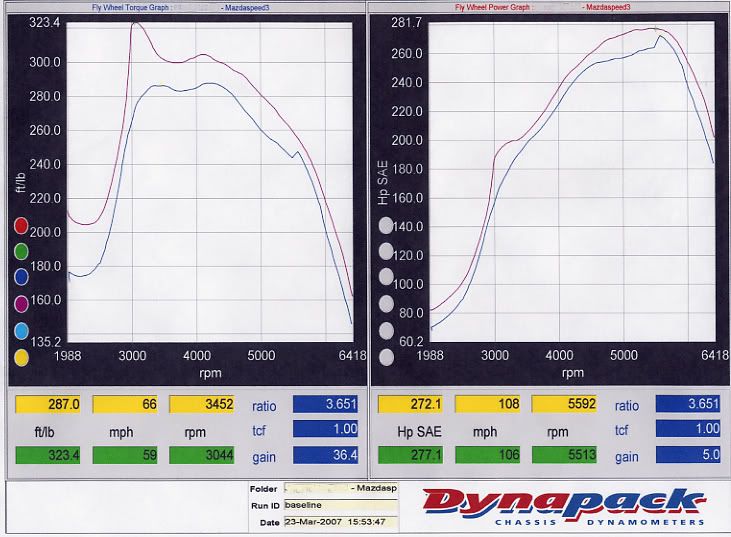

camrycev6 said:
jflash,
Because of the spike at the end of the run, which was likely a hiccup with the throttleplate. It is NOT an accurate run, and the dyno operator should have done another run to "backup" the numbers with repeatable ones.
The exact same thing happened on his intake run, but at the lower rpm. It goes to show how peak numbers really do not give a good indication of actual output.
ok. so lets see your dynos. what type of dyno do you operate? mabye i should have used the butt dyno like everyone else.
here are all the stock dynos. the exact same thing happened on all 3 runs.
