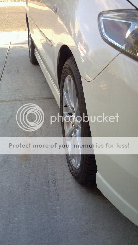

Question gang (yes I searched first but couldn't seem to find a definitive answer)- Just picked up a set of RX-8 wheels for my '08 5. Tires are 225/45-18. Anyone know anything about rubbing issues with this size?
you'll be fine

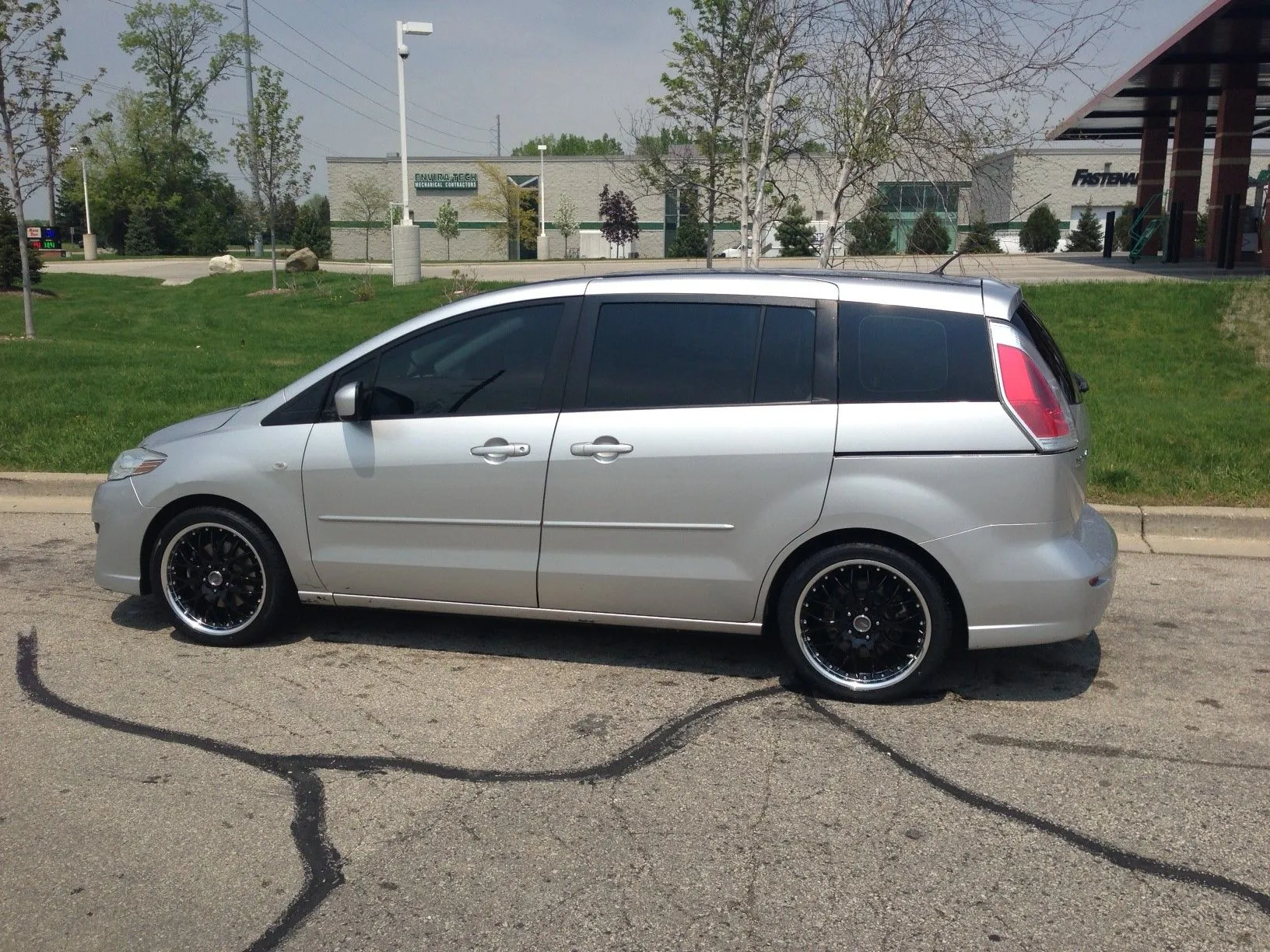

What do you guys think of 20's, preferably 20x8.5 +38 all around? What size tire should I run? Also, do you guys think that would be a little to big?

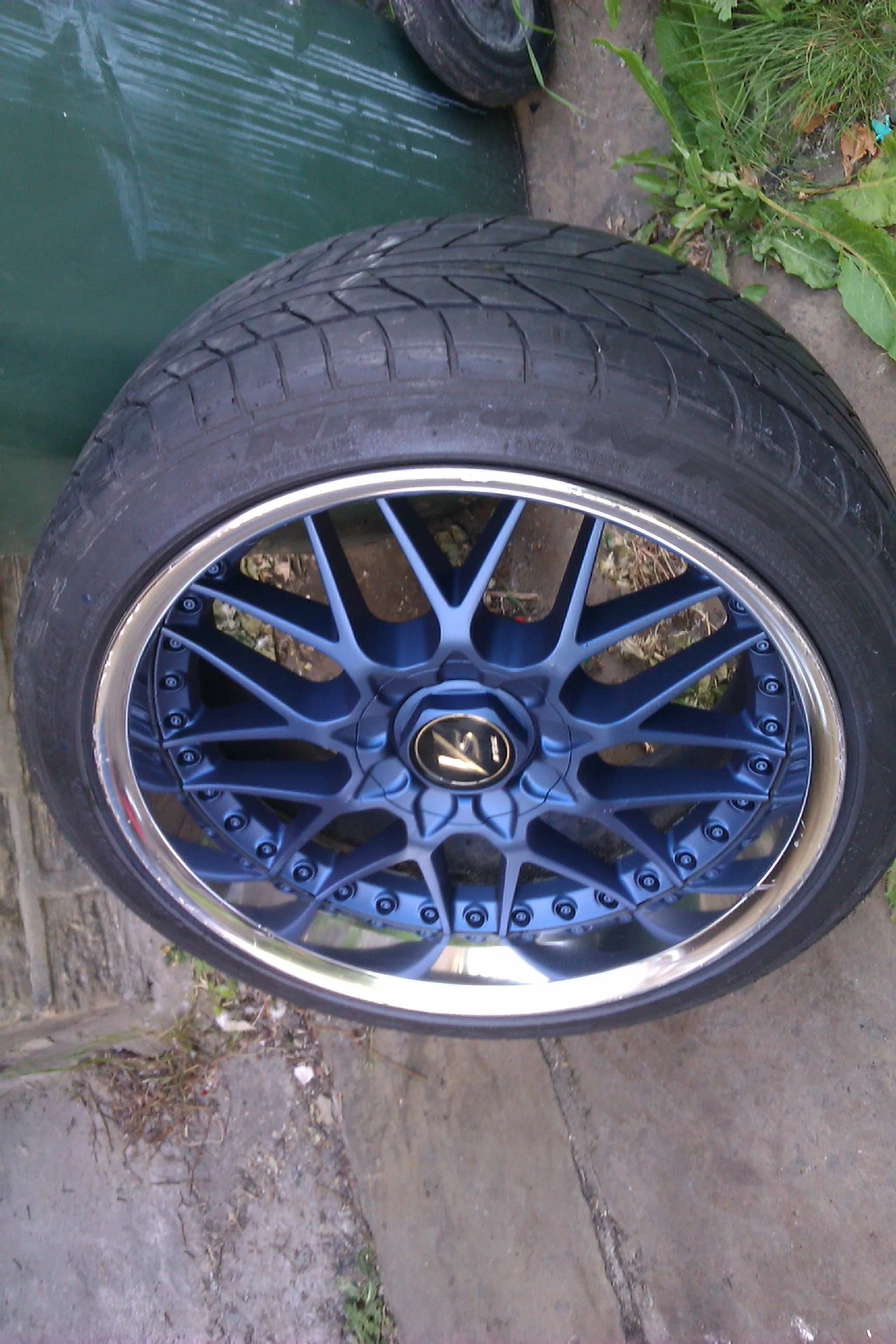

Hi Peeps,
I need some help please i have just bought works wheels which are 7.5j with a offset of +18 on the front and 8.5j offset of +18 on the rear
Please could someone help with tyre sizes, i dont mind going for a stretched look as i have no choice now, but i was thinking of 205/40/18 all round, what you think or recommend...??

I believe those tire sizes would be fine since I've ran a similar set up on a different car. I did 205/40 on a 9.5 rim. But you might into some clearance issues on the front since its quite a low offset. Its possible, but you'll be running a lot of camber.

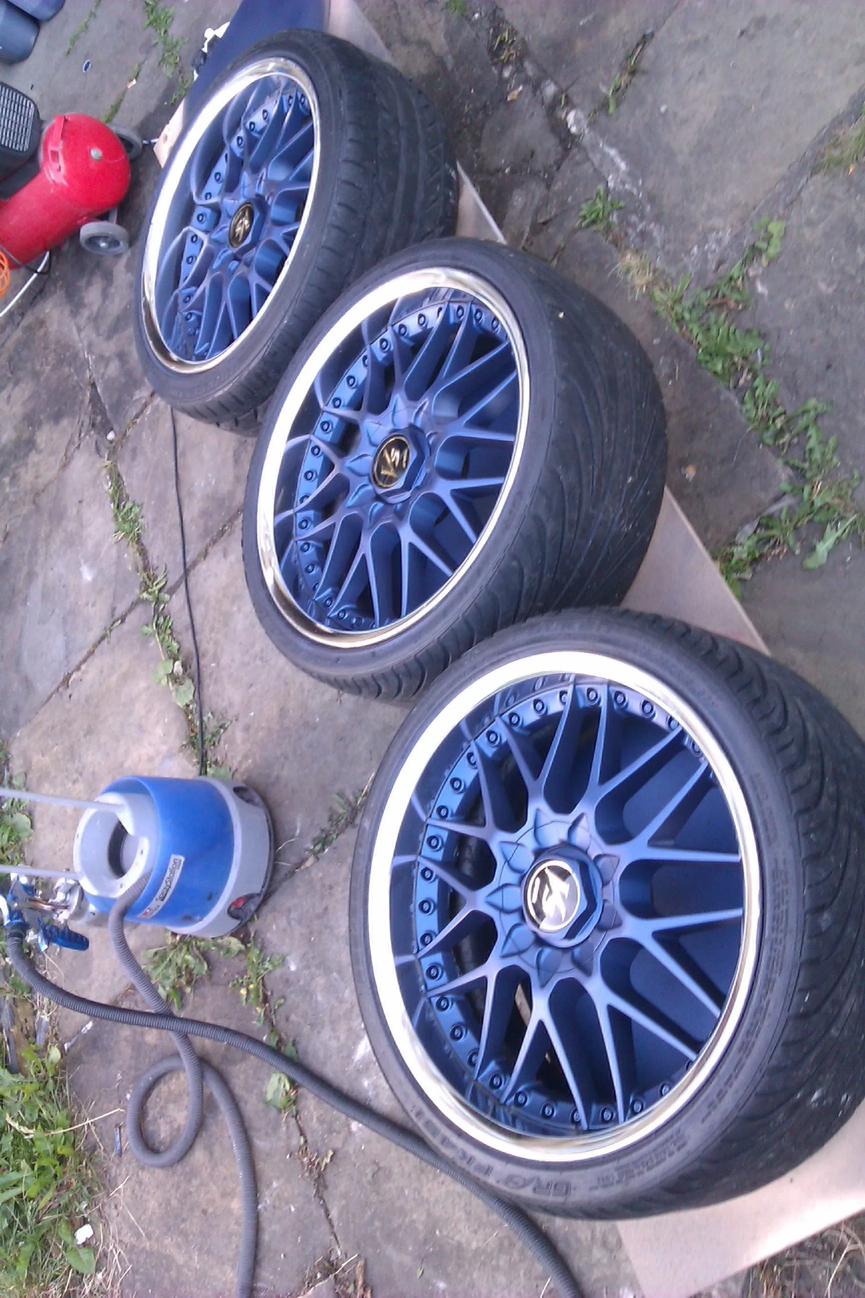

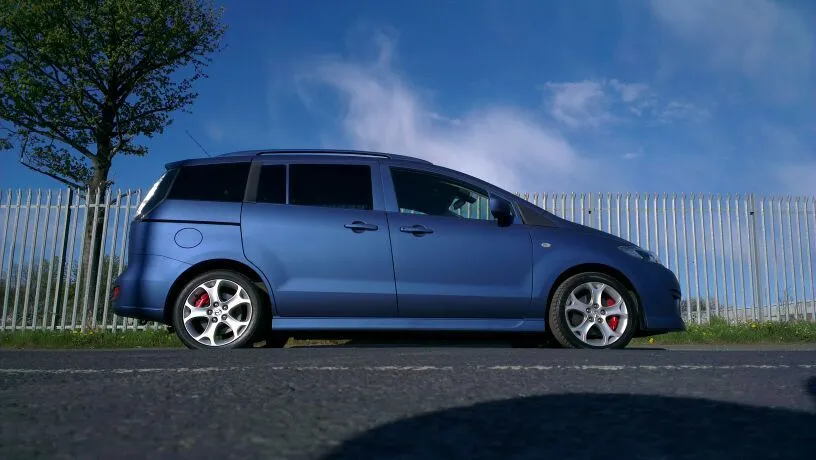

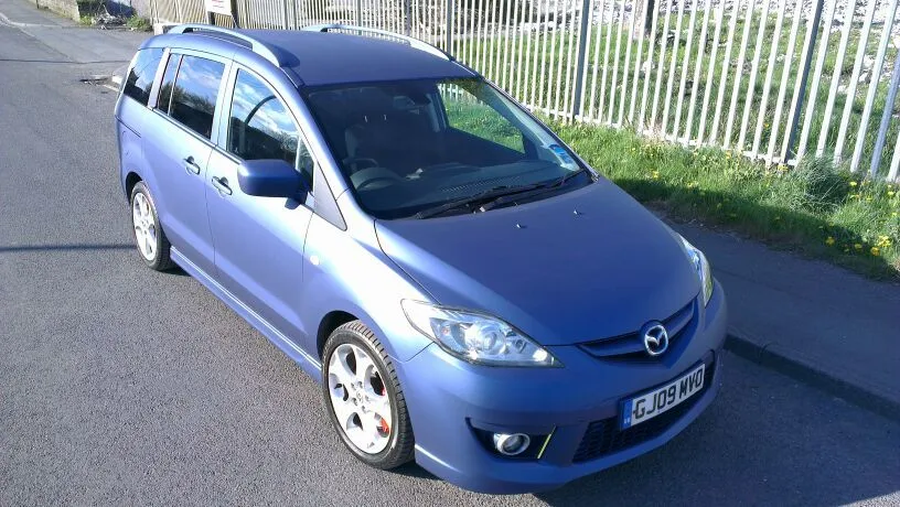

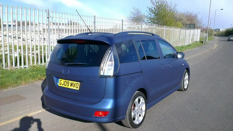

p.s. heres some pictures of my mazda5 and i just sprayed my wheel centres same colour as the car.

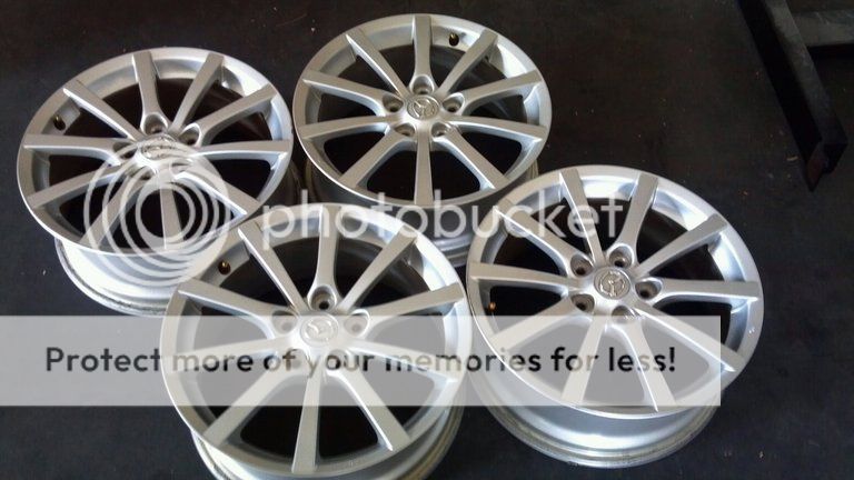

Haven't seen a lot of pics with MX5 wheels so here are mine. Was looking to change it up and found the deal of the century picking these up for $40 on Craigslist!! Heck of a lot lighter. Tires are 215/50
Very nice! 235/45 fit on there great too. :D
I was going to ask what size you had. I had just purchased the tires the day before I found the wheels so unlucky in that sense (but $40 for the wheels def made it worth it). The 7" width sure opens up more options for tires.

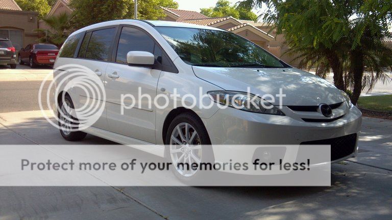

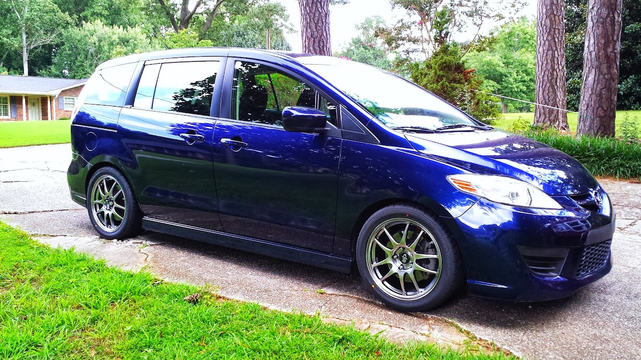

18x7 Mazdaspeed wheels with 225-45R18 Continental DWS tires. Lowered on H&R/Koni combo.
Just a note that this wheel and tire size combo is great at stock ride height but too much tire on the lower H&R springs. I get some rubbing on the front on tight turns or dips in the road that I never had before. Will be installing new wheels with a smaller diameter 225-45R17 this weekend.
Mine came with Michelin MXM4 tires on them in the 215/50 size. That's a proper tire fitment for that wheel width- 235/45 is usually listed as requiring a 7.5" wide wheel at the lowest end of the tire manufacturer's specifications. I did quite a bit of research before moving forward though- even to the point of grabbing an extra 17x7 and putting an oversize used 235/45 (Toyo Proxes 4) on it to see how much sidewall pinch and width loss there was from the narrower wheel. No problems, and the sidewall isn't squishy. 235/45 on a 17x7 is also really common in the Nissan Maxima community.
That's really cool news. I almost went with a 225 on the stock wheel but stuck with the same 215 this time (MXM4 as well). Can you post some pics, close ups, side shot etc.
I will this weekend- had a whole write up on tire fitment, spacers, fender lips etc. TONS of pictures.
