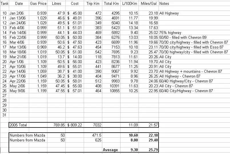

Attached is my mileage log for 2006 so far - average is at the bottom.

Usually just 1 adult and 2 little ones and on occasion all of us but the combined weight is just over 400lbs at most. I've got the tire pressure set at 40 - the dealer keeps lowering it to 34 everytime I go in but the tire max is 44 so I figure 40 is fine. My dealer has no explanation except that what Mazda suggests is only a guide and can be achieved in perfect conditions. I call BS on that... but they have checked everything for me twice and assure me the car is running on spec. I'm not an aggressive driver and my wife is even more cautious then me so... I can only blame it on the gas and the climate.

284mi / 13.52gal = 21mpg
All city driving. Haven't had a chance to take it on any road trips yet. It is mostly the wife's grocery getter and weekend vehicle to haul the family around together in one car.
