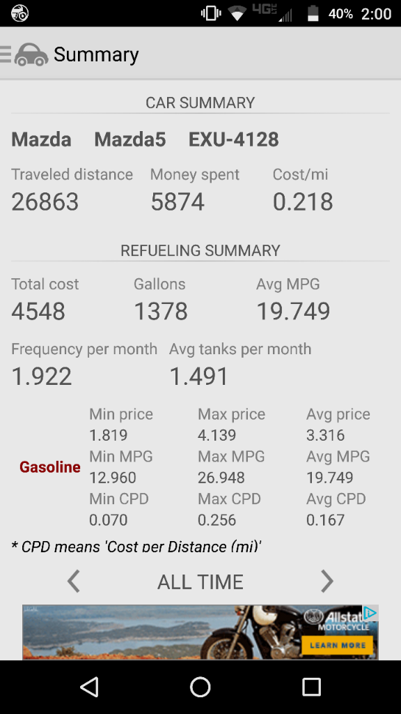

Here's my summary from Carango over the life of ownership. Decent for it's mostly City driving life but not as good as the window sticker suggested.
Sent from my XT1585 using Tapatalk
WOW I would be curious to know the elevation changes and speeds you were doing...
